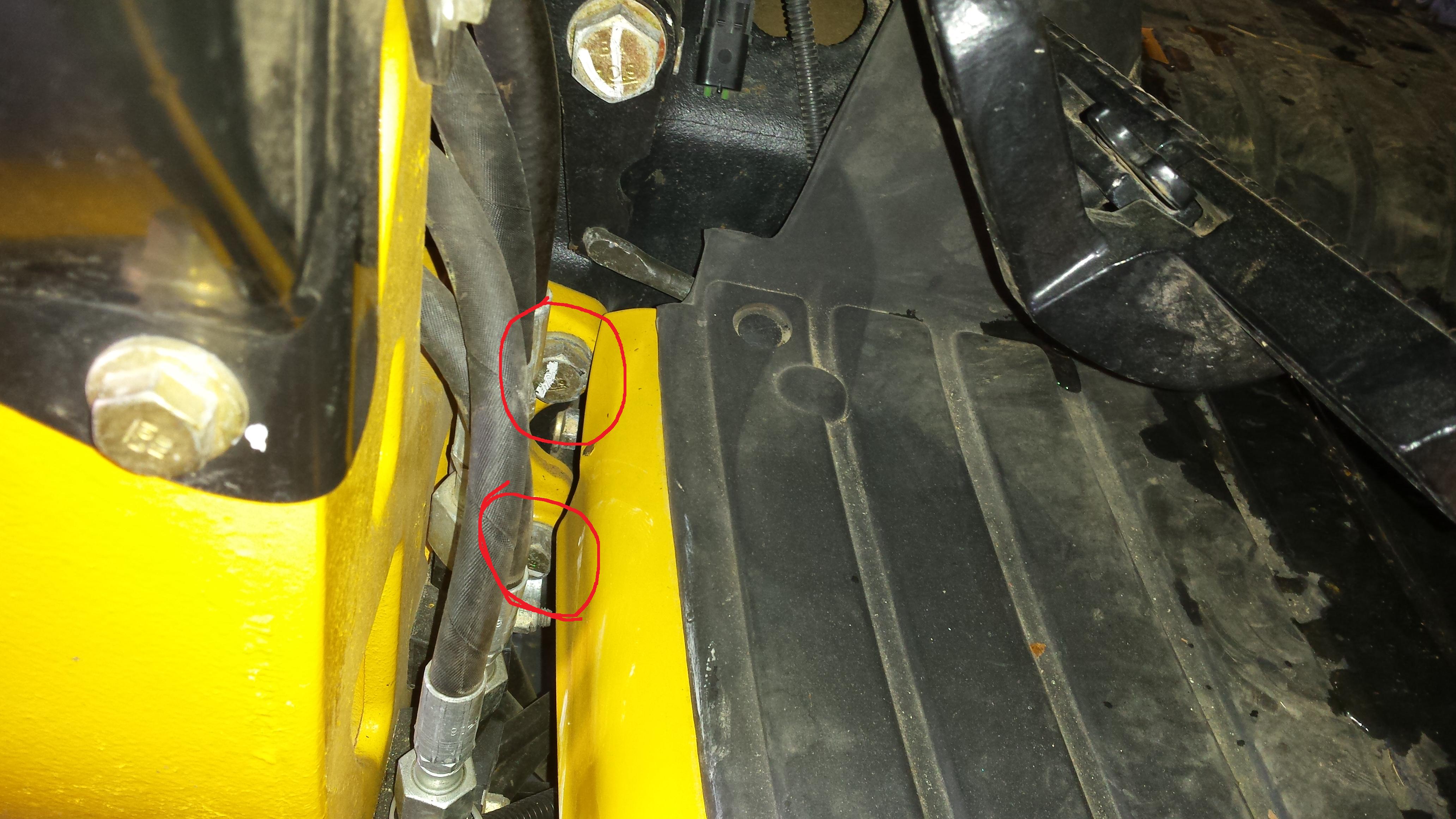

I don't know how but I missed 2 of the bolts that bolt to the bell housing. Thanks for bringing this to my attention.
I'm wondering how you guys are getting the torque wrench on the bolts closest to the operator platform? I fiddled around today and could barely get the open end wrench in there. I only found one of the loader bolts to need a small amount more torque.
Matt
I see why you are having trouble getting the torque wrench on the bolts closest to the operators platform. I can't get any wrench in there!!!!

I suspect these hard to reach bolts are part of the problem. If they require disassemble of the hydraulic hoses etc then they likely aren't getting check regularly. It's even hard with getting these with the box wrench!
Matt

I agree Matt, as I said before I didn't know that the bolts were there!!!!!!!!(I guess I'm just getting old) I'm going to try and borrow a crowfoot wrench and see if it will work.
   / Cracked bell housing in a 2006 110TLB #68
Looking at the picture a crowfoot wrench for the hydraulic hoses should make them easy to remove. Then tighten the bolts with a 6 pt socket. The hydraulic hoses shuld loosen and tighten easily with the o ring fittings.
   / Cracked bell housing in a 2006 110TLB #69
I was hoping I could check the bolts torque without removing the lines, but that's my next step
