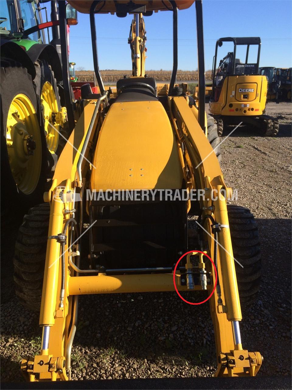

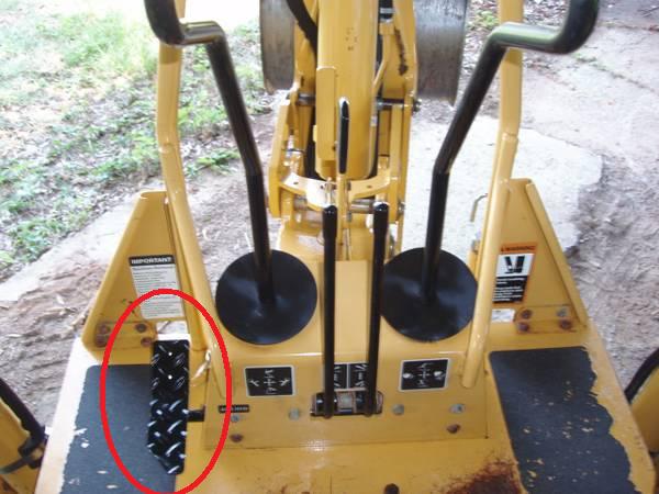

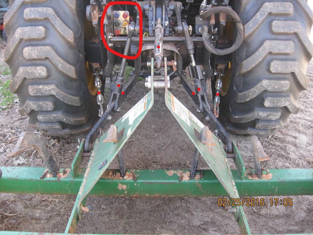

QUOTE=DocDryden;5688469]Some of the options that are nice to have
3 point hitch
Rear Aux Hydraulics
Foot Pedal control for thumb
Front hydraulic outlets
[/QUOTE]

If you're planning on running with 3point, then the rear hyd remotes are of value. As mentioned front hydros. aux lighting, b-hoe thumb. As previously mentioned the 110 is a real construction backhoe as opposed to a compact utility tractor.
