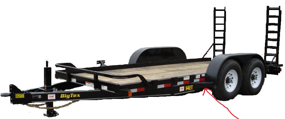

I have 20' bumper pull with a dove tail, has 5200lb axles. Has the full wrap tongue and was built in 2000. I use the heck out of it, and have loaded it heavy to max and sometimes over now and then. I have a Case 485 that weighs around 5400k I load on it all the time. I got into the habit of not using my ramps. My trailer sits low, I run the shortest 10 ply 16" tires I can buy to keep it low. I got into the habit of not using my ramps...because when I did the back of the trailer would hit the ground anyway. I did not block the back of trailer up....I should have. Long story short, the frame has cracked right behind where the full wrap tongue stops. Thats the stress point where when I load the tractor and the dove hits the ground, truck back end lifts up...and it cracked. So just an FYI to others that do the same, block the back of the trailer up when using ramps and loading equipment. really feel like a dumb *** because I knew better but a what could a 8-10" drop hurt. I have torn the floor out and welded in new bracing and repaired the frame, just about ready to hit the road again. I have made mods to use jacks in the back when loading equipment/tractor etc. Maybe someone can learn from my laziness/mistake

Can you show a pic of the trailer/crack. Hard for me to visualize.

Not the trailer in question but this is where I visualize...

It cracked right at the end of the full wrap tongue, close the where the front axle sping mount is. I do not have an actual pic, but this trailer is close what I have.

Here is what i have, I ground a groove in the crack on both sides, ran bead in it. Ground that down, on tire side I welded in some 3/8 x 3" flatbar in. On the inside of the trailer I used the 1/4" square tubing I had left from a previous project. i welded that in and used the 3 x 4 angle and welded that in for extra bracing. Still have some more adding to do before I put the floor in. Going to reroute some of the wiring and get that fixed up. Got my wire rope welded back in for my tie-down points. I am going to come up with 2" square tubing receiver in the center right behind the tool box and us 2" square tube to mount my spare, going to usa spindle so I can mount bearing hub and all for spare to have in case I burn bearings up on the road. Going to use removable jacks on the back when loading equipment. Going to clean up the cross members and shoot some paint on everything before the boards go back. The arrow shows where the crack was.
