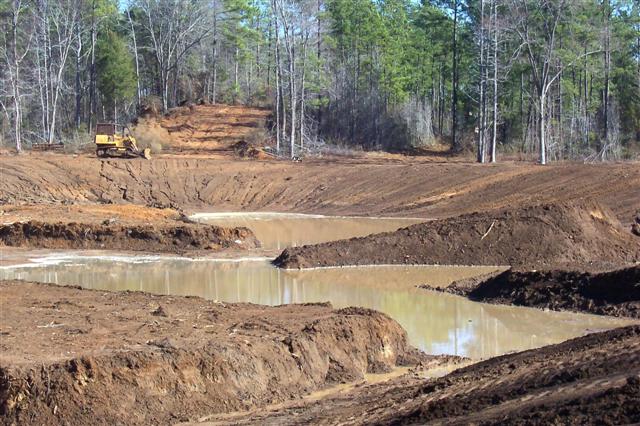

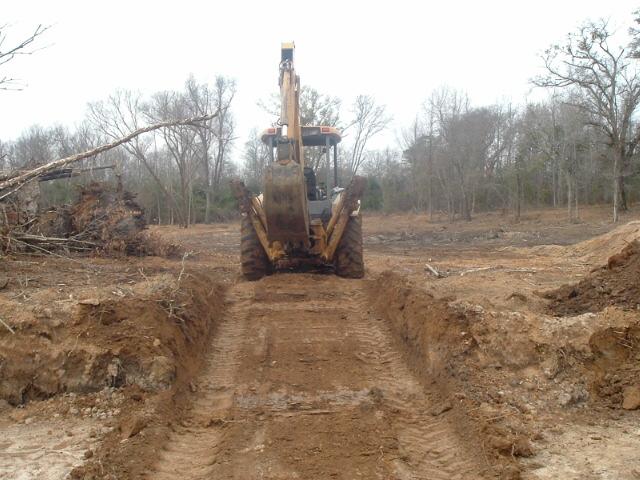

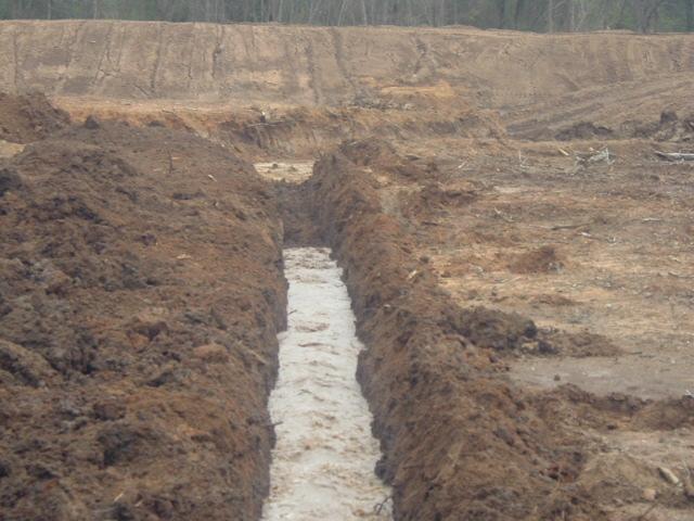

Pic one.
I used my loader bucket to carry it down to the lake. It wasn't very heavy, but it's too far to mess with. I'm parked on the dam here and you can see the lake off to the left.
Pic two.
I used a length of old fuel line from the tank to the pump. To join the two, I put in a plastic, Fram, inline fuel filter. As you can see, I built the wood frame tall enough for the fule to flow downhill to the engine.
The tank holds over fifteen gallons, maybe sixteen.
Pic three.
This shows the dam a little better with the pump on the left at the creek, the backhoe on top and the water on the right.
Pic four.
Here's another picture of the discharge line as it enters the lake. I'm usuing the logs and islands to guage how much the water rises.
Pic five.
This one shows the overall size of the lake. I'm standing at the shallow end of the lake and the backhoe on the far right, is at the deep end. The water at that end is over four feet deep. On this end, there's nothing, but the water is definately rising!!!
Eddie
