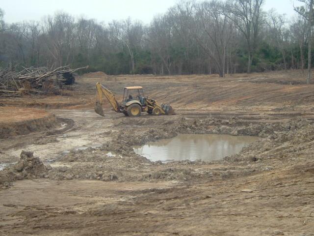

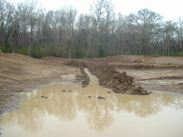

We had a 20 minute storm come through last night that dumped an inch and a half or rain according to my rain guage. A quick, heavy storm like that gives me lots of run off, so I was interested to see what the results were like on the culvert.
First picture shows the amount of silt that ended up in the pit before the culvert. It also shows the road over the culvert and the lake.
Second picture shows the amount of water in the lake as of today. I'm stil about 8 feet down, but that means my deepest point is 4 feet deep!!!!
Third picture shows the shallow end of the lake. It will be 8 feet deep there when full.
Fourth picture shows my open drainage to the lake. This is where the bulk of my watershed will come from. It goes along my Western property line and into my neighbors land. From where it turns uphill, it will have a water coming into it from 20 to 40 acres. It's heavliy wooded, so there's no telling how much water I'll get from it. I'm finding that wooded land doesn't shed near as much water as open pasture does. It's not even close what five acres of grass will shed as compared to 20 acres of woods.
Eddie
