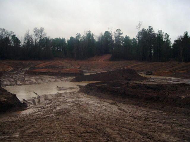

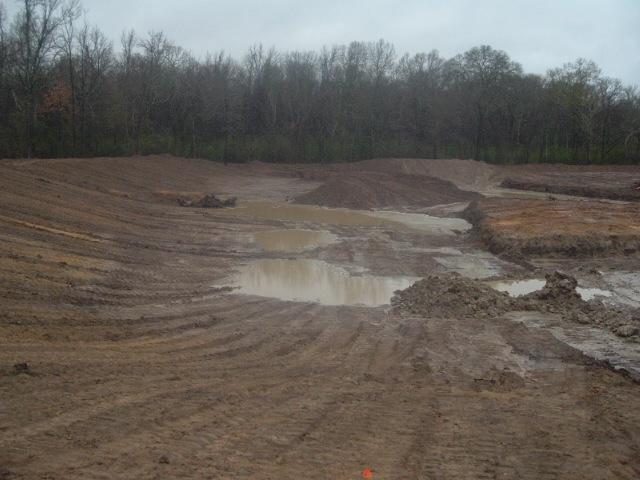

Last night we had our first real hard rain of the season. In about 30 minutes, my rain guage showed 1.75 inches of rain. The ground is still sort of moist from the last rain, so this stuff was all run off. I was very exited this morning to see how my changes to the ground in my pasture and other areas of the land handled the rain. I eyeball most of these changes, so sometimes I find I need to go back and make a few modifications. hahaha
There is one spot that was pretty bad and I lost about 4 acres worth of runoff, but otherwise, it went pretty good.
I also had a problem with one of my culverts. It's the smaller 15 inch one, and the water wore away the dirt at the entrance to the culvert two feet back. The first picture shows this. To fix it, I'm going to stack 40 pound sacks of readi mix around the pipe with rebar pounded through it. That will be one of next weeks projects.
The second picture shows the big hole in the ground with a few feet of water in the deep end.
It's a start,
