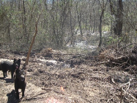

   / Creating a Lake
#39
Blue (in front) is next to a flag marking the shoreline.
Just a few feet back is the hole that I created when I got my backhoe stuck a few weeks ago. The water is overflowing from that hole.
Behind that is another hole that is still a foot higher then the main swamp in the background.
Either I have numerous springs or the ground is totally saturated.

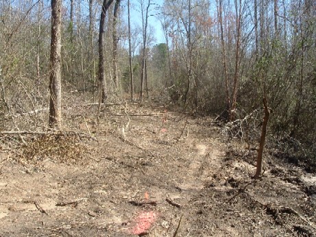

   / Creating a Lake
#40
When I decided to explore the area I wanted to build the lake, all I knew was what I'd seen on a topo map.
This is my first pass into the area. The orange paint marks the shoreline.
I got really lucky the way it's all fitting together.
