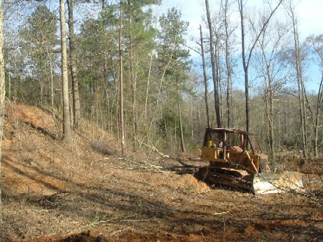

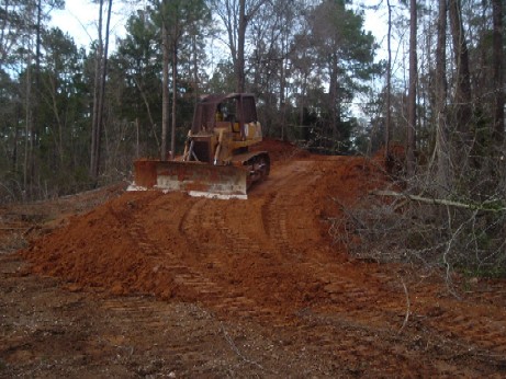

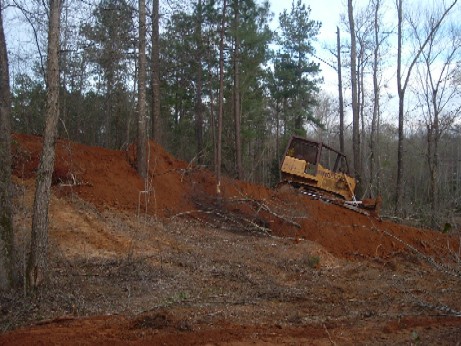

It's a steep ride to the top

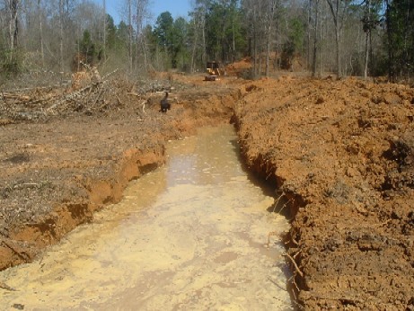

The makings of a spillway

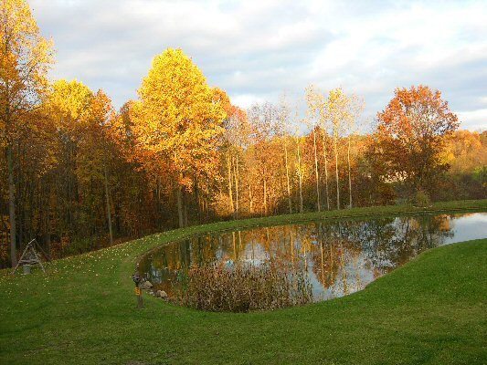

/ Creating a Lake #86
Yes they do eventually fill. As you can see sometimes building a pond is just a bit more involved than digging a hole on your property. Is it worth all the time and effort, we think so. /forums/images/graemlins/cool.gif

/ Creating a Lake #87
Thanks PineRidge, those pics are informative and the end result is very beautiful. I am glad Eddie asked to see them /forums/images/graemlins/grin.gif

/ Creating a Lake #88
Wow PineRidge! That is impressive. Thanks for sharing.
Would you describe the overflow or do you have a picture?
Was that 8" pipe? What kind of spillway flow do you get with a heavy rain?

/ Creating a Lake #89
PineRidge,
Man, that's just beautiful. It's not at all obvious how much work a pond is, but those photos make it a bit more clear.
Thanks for posting the photos.

/ Creating a Lake #90
Mike, nicely documented and not to shabby looking. A couple of questions if you don’t mind. How large is your pond? How long did it take them to build it? Is all the water feed from water shed? Besides the over flow pipe system did they cut an emergency spillway for loads the pipe can’t handle?
Sure looks great!
