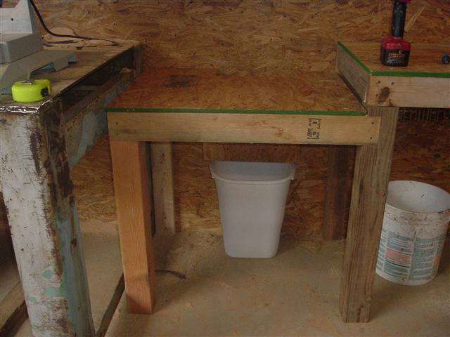

#467
Here's the drop for the chop saw. I had to lower it 4 and 11/16's inch below the coutnter height. Don't you love those even numbers? /forums/images/graemlins/confused.gif
This is being made from scrap lumber that was either too twisted to use for framing, or short pieces that I had left over.
The posts are also scrap, which explains why one is PT and the other isn't.
Eddie

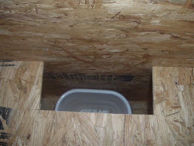

#468
I built a drop for my chop saw in my last workbench and really liked it. Made life allot easier. The one thing I didn't like was all the sawdust that would pile up behind the saw.
I was at a resturant and noticed that the hole in the counter top to throw paper towels to the garbage below would also work well for my chop saw.
My first plan was to put a 5 gallon bucket underneith to catch the sawdust, but the round edges were making things complicated. I looked around and found this rectangular garbage can piled up in our storage area.
Eddie

#469
View from above.
Eddie

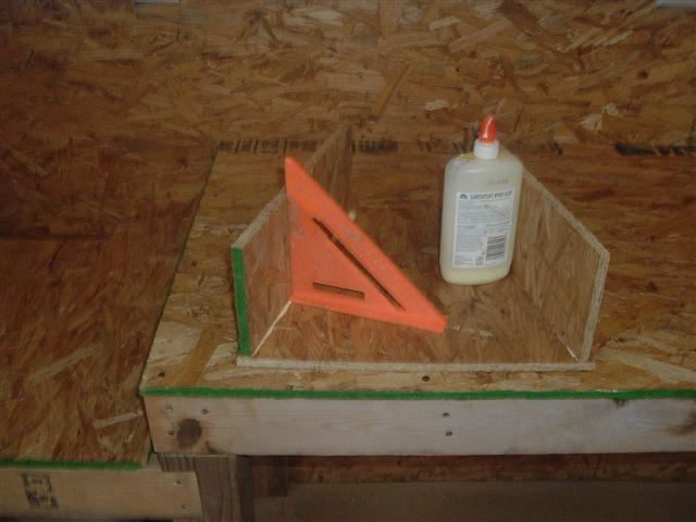

#470
The opening is 5 inches by 12 inches.
The flat side of the garbage can is only 6 inche, then it rounds off to the small sides.
I needed to create an angled, funnel type of box for the sawdust to flow into the garbage can.
This was the simplest solution I could come up with.
Eddie
/ Creating a Workshop & Home
#471
Here it is mounted to the cross member that supports it.
This picture shows how it all fits together.
When I first decided to build this, I spent allot of time working out all sorts of complicated details. Then I would rework my thoughts until I got it down to the simplest form.
That is just how my brain works. /forums/images/graemlins/confused.gif
Eddie

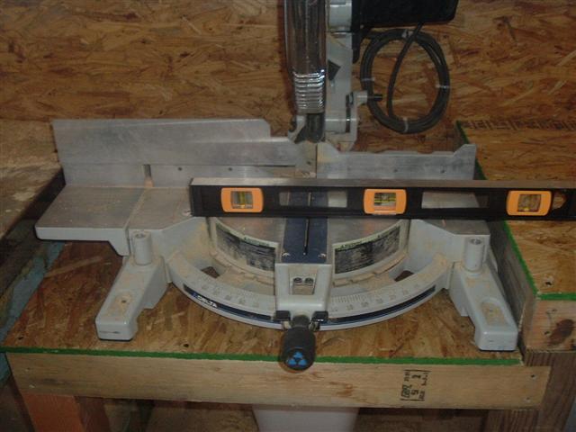

#472
Looks like it fits!!!
On a test cut, about half of the sawdust went right down the chute to the can. As sawdust builds up, I think more will fall down the chute.
Clean up will be easier since all I have to do is sweep into the chute wihout having to remove the saw.
I'm also thinking about a piece of wood along the wall to catch more of the sawdust.
Obviously a vacume would do a better job and would be simpler to install, but I don't have one, nor do I really want to get a vacume system and run all the tubes.
Eddie

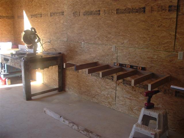

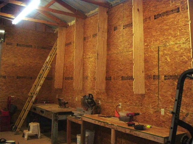

#473
You can see the chop saw and how it fits between my metal table and the new workbench. You can also see the fist step in the shelves I'm building.
The shelves are being hung from my truss's and attached to the walls. Right now they are only glued and screwed at the top. It will take another rainy day for me to get anything else done in there.
Eddie

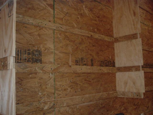

#480
Thanks for the kind words. The chop saw has been getting some use in it's new home. The dust chute is working really well. I think I'm getting about three quarters of all the dust into it with hardly any mess at all. /forums/images/graemlins/grin.gif
Of course, the best part is having the benches on either side at the same height so the material I'm cutting is flat. That's the best part!!!!
The weather is cold and I need to get the workshop cleaned up and organized before Christmas Eve. We're having dinner here in the workshop then.
Over the weekend I cut and intalled all the support pieced that will hold the shelves up. I thought I'd get more done, but Christmas activities keep distracting me.
Each strip is 2 inches wide and screwed into the wall or plywood sides.
Earlier some of you mentioned that I should use a piece of blocking wood to tie in the siding on the walls where they meet without a stud. This was what I was trying to explain as to why it didn't matter when I was putting it up.
