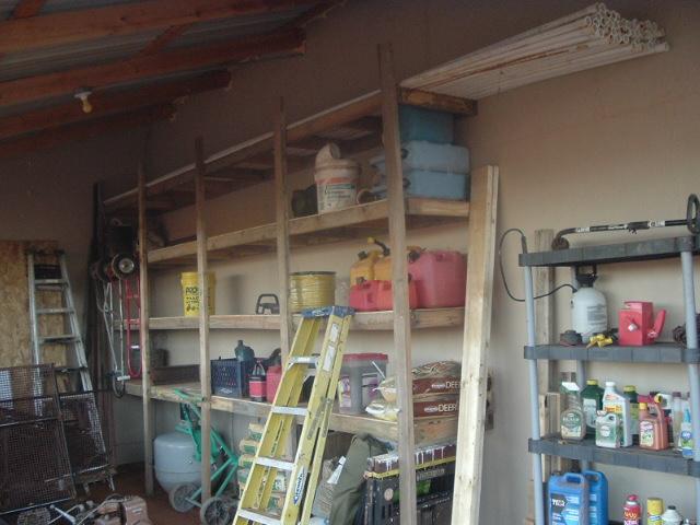

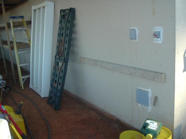

#505
Years ago I bought some Rubbermaid shelves and a tool holder. They have worked great and I wanted to use them in this area. I have more hand tools than space for the tool holder and was going to buy another one when I got this idea.
I don't need the bottom part to hold the tools in position, and it's identical to the top part, so why not combine them into one super long tool holder. It was pretty easy to cut one end to line up flush eith the other, then screw it together from both ends so it's tight.
Than I put up a ledger board at the beginning of my storage area.
The grey boxes you see in the picture are my light switch, outdoor outlet and the big one on the bottom is a juction box with 4 12/2 wires dead headed. They will be used for future projects, but for now they are just in place waiting. /forums/images/graemlins/smile.gif
Eddie

/ Creating a Workshop & Home
#507
I started organizing a little and put a few things away. This is the part I hate the most. Where to put it so I can find it when I need it, but it won't be in the way, or it will be nice and handy.
I plan to get it all cleaned up and organized today. My goal is to be able to park my CUT with bush hog attached in this space out of the weather!!!!
Eddie

Here's the shelves all finished and most everything put away. There is still more stuff in different places that I'll get to, plus I want to go through my scrap wood pile and get that in there too.
Eddie
