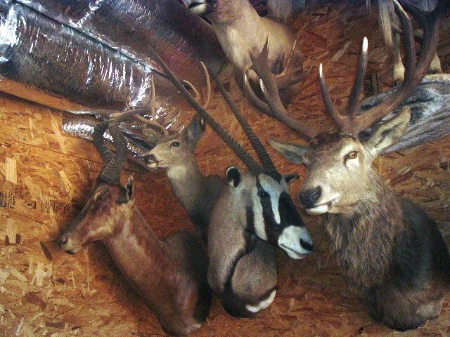

Today was another one of those "It's too muddy to run the dozer" type of days, so I decided to finish off the front wall with OSB.
Working around the ductwork was the tricky part. I was hopeful it would get done on it's own, but after stalling for several months, I ran out of patience. /forums/images/graemlins/grin.gif

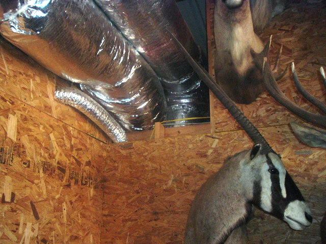

#492
When I fist drew up the plans for this place, I was only going to put a half bath upstairs. The main reason was I had a mental block on the roof line. In fact, it wasn't until I was building the truss's that it "clicked" in my head how to tie it all together.
Anyway, the bottom tub was already in place and plumbed up before the upstairs one was even in the idea stage. This delay made it sort of tricky on how to drain the upstairs tub without pulling out the downstairs one. My solustion was runnign the drain outside the wall to the washing machine drain.
That was the long explination as to why those pipes are exposed and will remain that way. /forums/images/graemlins/grin.gif /forums/images/graemlins/grin.gif

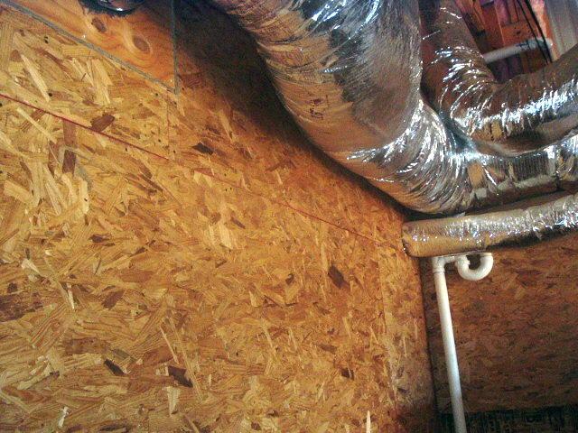

#493
Here's one more example of my procrastinating.
This is the first wall that I put the OSB up on. All except this one spot. Not that it was very dificult, I was just being lazy.
If you look close, in the bottom of the gap, you can see a yellow and a gray wire. The yellow is a 20 amp 12/2 that supplies power for the front wall. The gray wire is a 14/3 15 amp line for my three way light switch.
Eddie

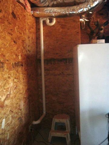

#494
Now it looks allot better. No exposed wires and the collection is back in place. /forums/images/graemlins/smile.gif

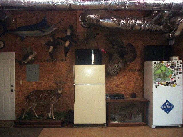

#495
The workshop is now basically done. Later I'll do some trim work around the doors and I still have some more tools and equipment for the shelves, but that stuff is never ending.
Here is the last wall.
If you look real close, you can see the layout for the RV park on my freezer. Steph colored it for me, and it's a daily reminder what I need to get done.
