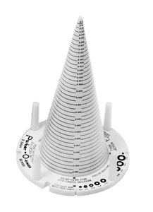

Northern tool will have a sizer that looks like a cone and 1 for thickness. But you need to know what they are made of too.

You are figure out the o-ring size from 2 measurements: the ID and cross section. Google o-ring chart, to cross reference from measurement to standard sizes.
Many places sell cone measurement tools to figure out the size.
Lines on the cone give standard sizes (ID) and notches on base find cross section.
That 17.1x1.6-70 is a metric o-ring. 17.1mm ID, 1.6mm cross section and 70 durometer.
Careful with ebay o-rings. Need to make sure the material is compatible with hydraulic fluid and durometer is close.

MUCH appreciated yes matched 70 rating
I will purchase cone cool tool to have
