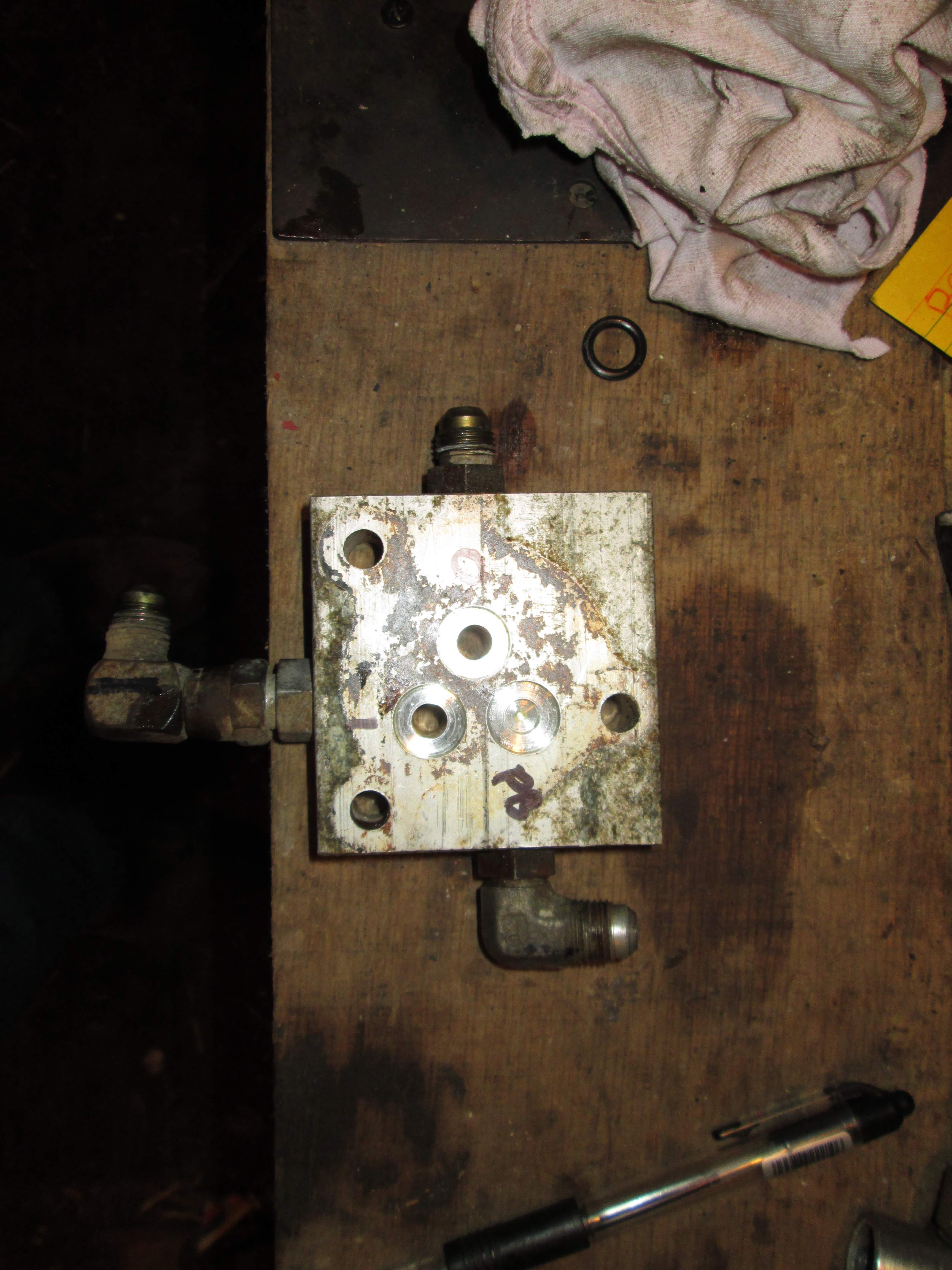

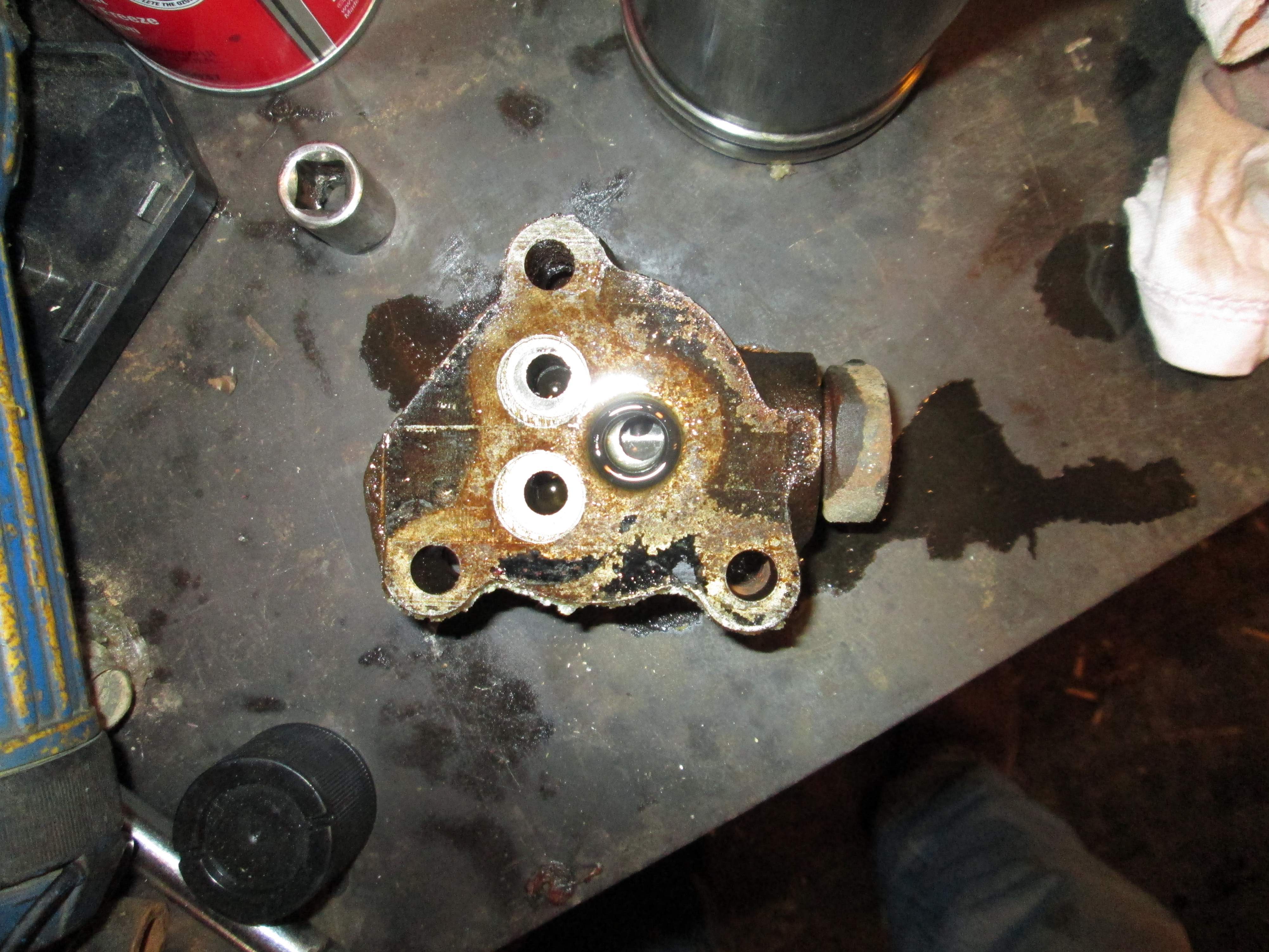

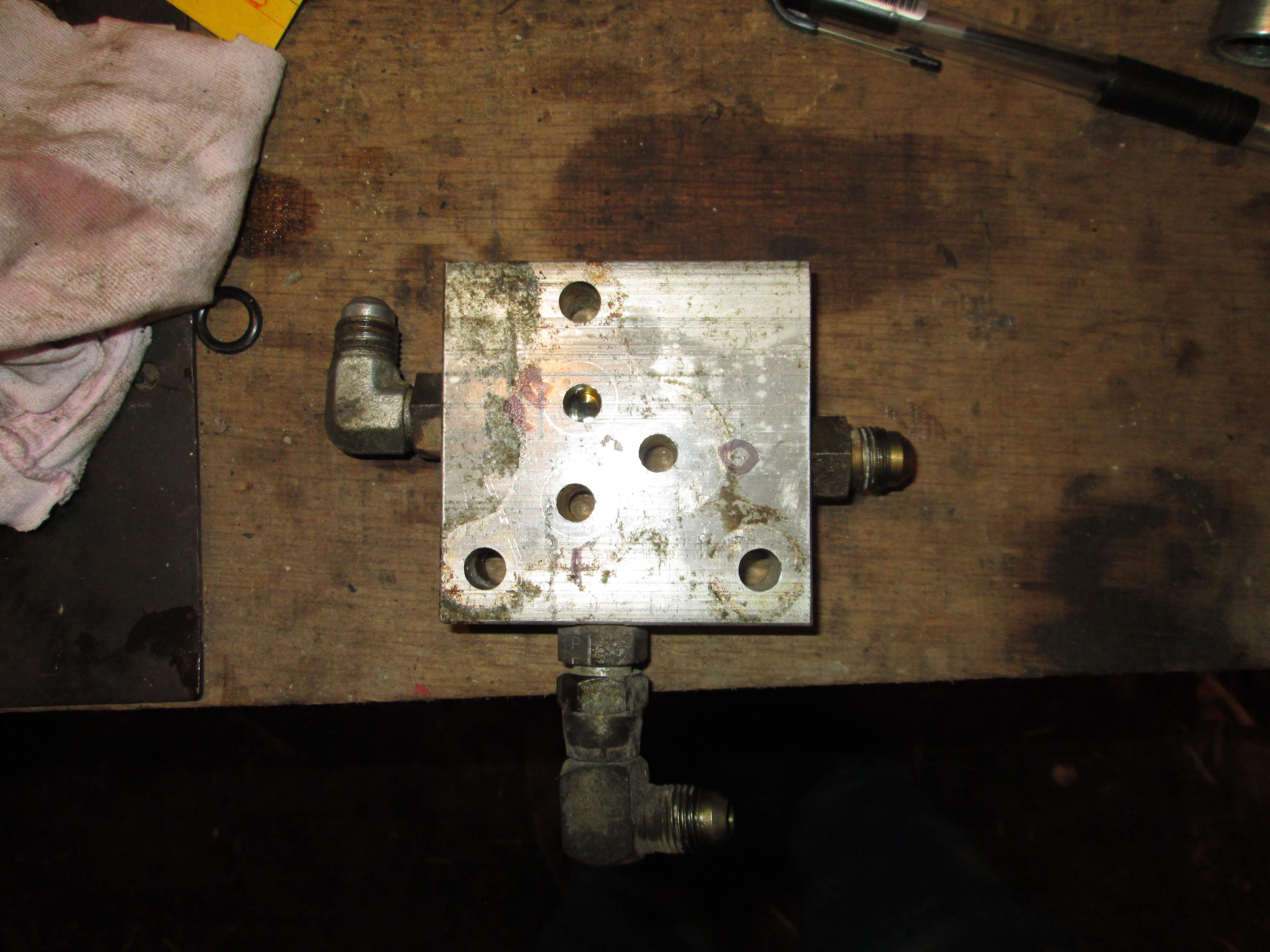

Here are a couple of pics of my hyd block. Why dont the 3rd hole go all the way thru? I know theres a reason what is it hyd 001.jpghyd 003.jpghyd 002.jpg

It could just be a passage way for the fluid to flow from and to a certain point.
   / cross valve problems #18
If you look a little closer you can see the hole that doesn't go stright thru, it's also drilled from the side and goes out the fitting that is on it. Blow air back thru that fitting and see where it comes out. I would guess it feeds the 3pt and the other one is for rear hyd.
