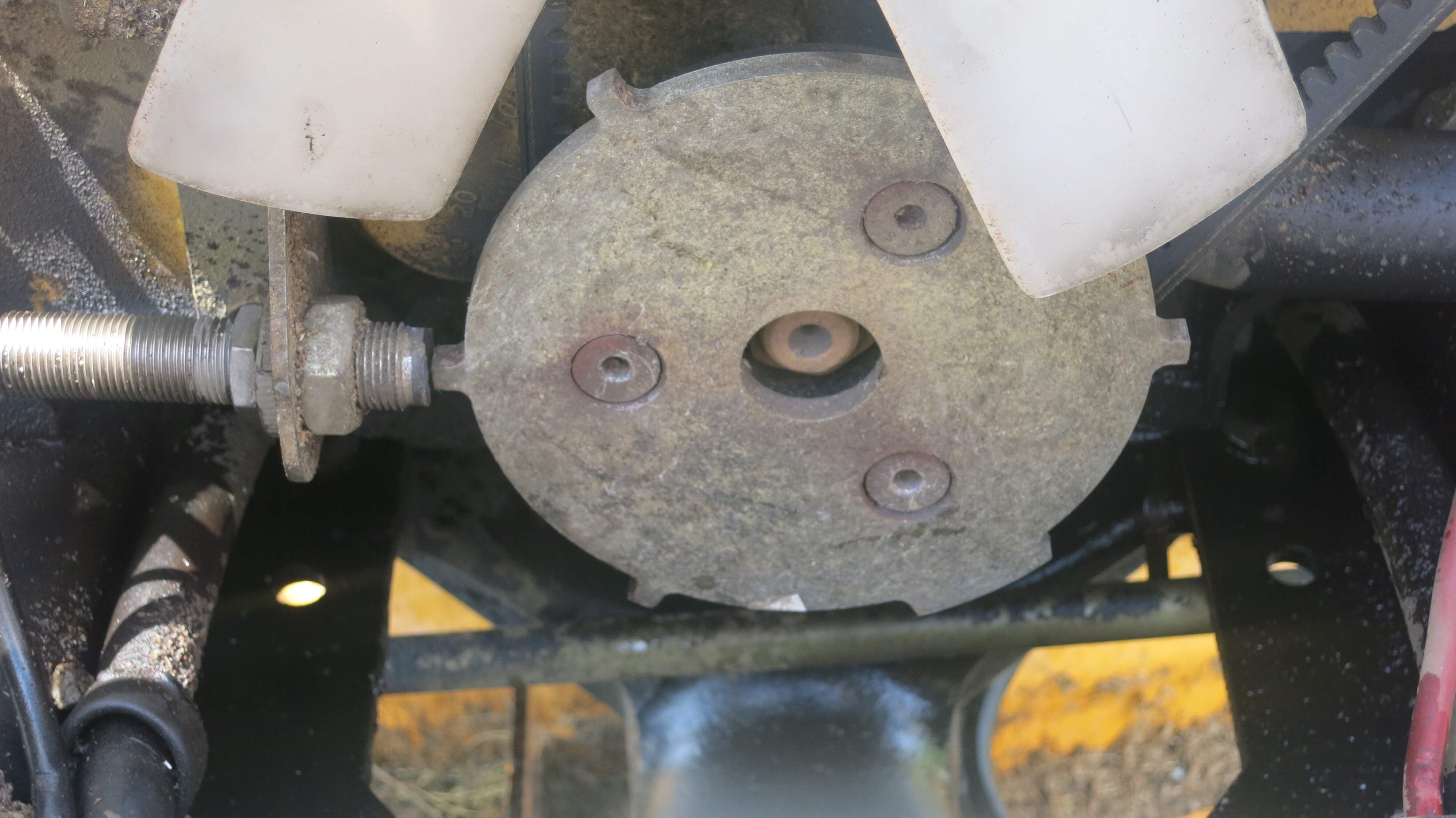

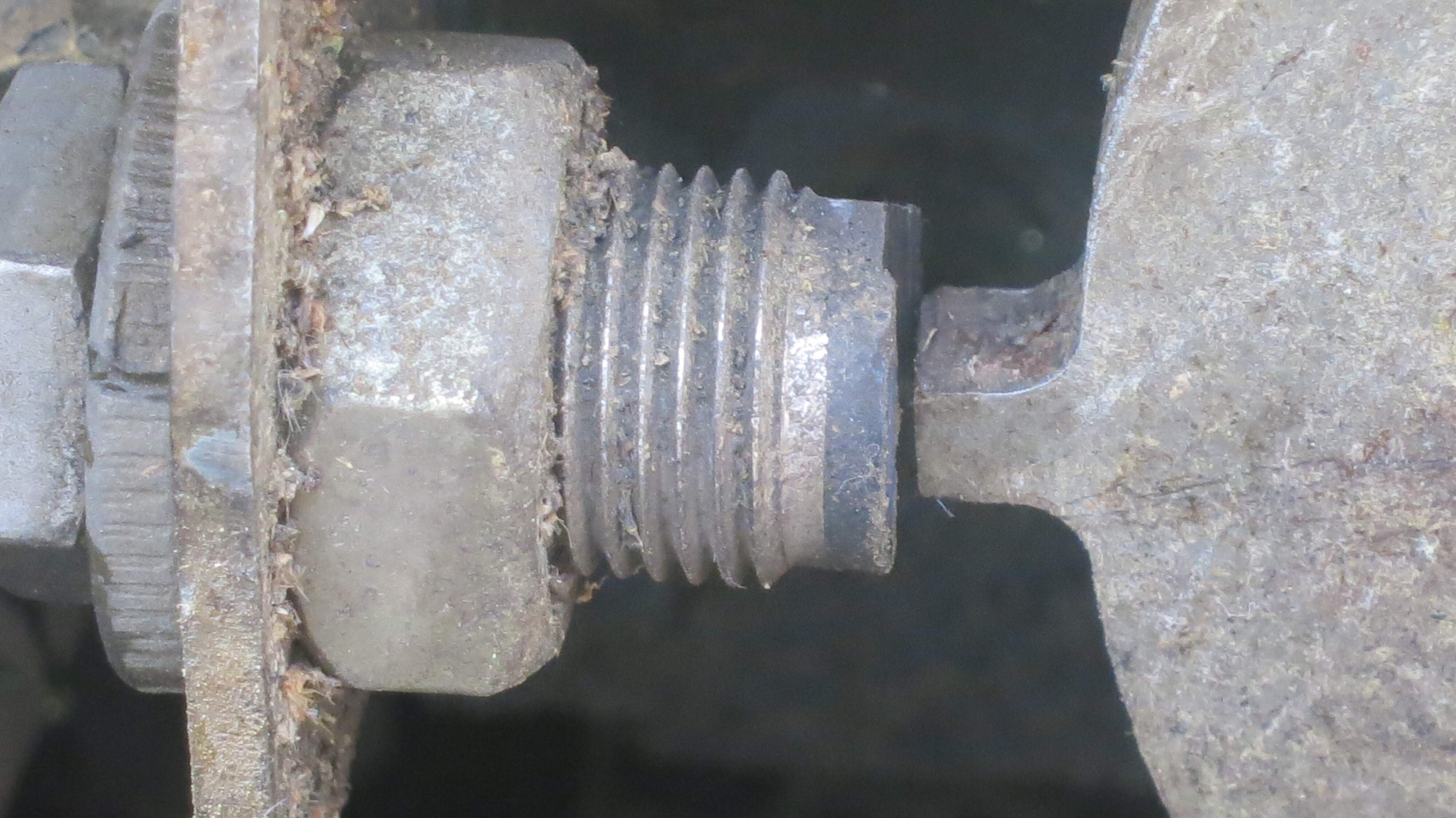

/ Cub Cadet 6284 Tachometer #8
Hey mark,
Finally got to mine. And sure enough the three Allen bolts were loose causing the plate to wear and cut into the sensor.
Is this the part # you ordered, 725-04212 ?
#9
That is the correct part number. Glad you figured your out before it caused real damage. Mine took the tip off all the fan blades before I figured it out. I put my pickup plate back together with locktite on the threads. Also, you can test your sensor by simply checking for continuity across the two wires coming into the sensor. If there is any resistance, it is good. If it is an open circuit, it is bad. For what it is worth, and that is about $110 for a new sensor, if you can solder, you can fix the one that you have. All that happened to mine is that it cut the copper wire wrapped around the magnet. If you spend a bit of time with a pick and get enough epoxy out so you can re-solder the wire together (assuming it is broken), you can fix your sensor. Then, just epoxy it back in place (with a non-conductive epoxy (don't use belzoma or other epoxy containing metal bits). If you decide to buy a new one, you might consider Central Equipment. The parts man (Tim Beasley) tbeasley@centralequipment.com was a real help in working through my loss of tachometer signal. He opened up a ticket with Cub to help me get it solved. Even though, I could have fixed my sensor, it was well worth the money spent to simply maintain that working relationship. I also bought tranny fluid from them - now, replacing that was a whole new troubleshooting opportunity. I am an engineer and it seems that the oil filters are on the intake to the pumps (bad design). Be that as it may, after replacing the filters and 26 qts of oil, the tractor got fluid circulating in short order and the drive and rear hydraulics worked fine. However, the steering and lift worked at about 50% capacity (both were jerky) at low RPM. At high RPM, the the steering and lift caused a loud screech/whistle. After troubleshooting and bleeding the system, I riddled this for a few more days and came to the conclusion that the filter must be leaking air. So, I climbed under the tractor again and tightened up the filter (way past what I would normally do). And, the system works again. I bought WIX filters and would advise to use the cub replacements as the seals are different between the two. Here is a good read on hydraulics - http://www.hydraulicsupermarket.com/download/hyd_problem_solving.pdf

/ Cub Cadet 6284 Tachometer #10
Mark,
I had no resistance between the wires on the sensor, I will order one tomorrow. I tried to even out the end and took too much off, and the copper wire came flowing out.. I checked the resistance beforehand though..
I am not doing the kingpin, only replacing the axle seal. Thankfully mine don't leak.
I would advise other guys to check their rpm plate for tightness though.. It's rather easy, just make sure engine is off and stick your hand up and try to wiggle the plate, if it wiggles, remove radiator and loctite and retightened 3 Allen bolts.
