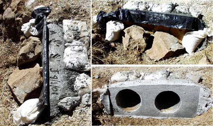

Well, the rainy season should be here in another month or two, so I decided it was time to finish this project. As you may or may not recall, my culvert #3 was a washout, literally. I underestimated the resolve with which flowing water will seek out any gaps around the inlets, and as a result lost most of the fill between and around my pipes. I have since replaced the fill, but hadn't fixed the original problem.
A couple of weeks ago, after an hour or so of carefully arranging rocks around the culvert face, I was not satisfied that I had improved the situation. So the following morning, I took the easy way out and picked up a few sacks of redi-mix and had at it again.
I dug out around the uphill ends of the pipes, exposing the last 4 or 5 inches. Then I just grabbed a piece of plywood scrap about the right size and slapped it up against the openings. Using a plastic garbage bag as my release agent, I just staked the board in place and leaned some heavy rocks against it for support. Then it was just a matter of mixing, pouring and rodding. The kids, of course, added the final touches. /w3tcompact/icons/wink.gif
This last weekend I saw the results, which, although probably adequate, point out the value of measuring tools and levels and such. I did it all by eyeball, forgetting that I have a lousy eye. /w3tcompact/icons/crazy.gif
The attached pictures tell the story.
   / Culvert Redux #27

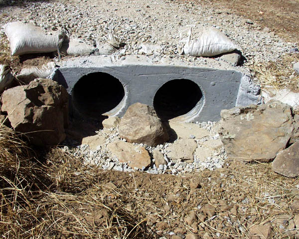

Looks pretty good to me, Harv. The only thing I wonder about is the fact that the bottom of the culverts appears to be few inches above the bottom of the ditch, so I suppose you're going to be left with a puddle there. Will it soak in or dry up pretty quickly?
Bird

<font color=blue>I wonder about is the fact that the bottom of the culverts appears to be few inches above the bottom of the ditch</font color=blue>
Nothing wrong with your eyballs, Bird. /w3tcompact/icons/wink.gif
That last picture shows how it looked right after I peeled away the form. I had deliberately dug out below the pipes to make sure the concrete extended below the creekbed level. The attached picture shows how it looks now, after I filled in and around with rocks and gravel.
I never really thought about the dynamics of water flow in a creek and the associated erosion, but now that I am thinking about it, I'm hoping the way I filled in the depression will discourage erosion under the concrete face. My intuition (solid as gossamer) tells me that the remaining pockets between the bottom rocks and gravel will get silted in, and the creek will establish its new bed at the level of the pipes.
Too bad this creek only runs when the neighbor's pond overflows. As dry as that pond is now, it could be many months before we get to see what happens. /w3tcompact/icons/crazy.gif

In Harv's original culvert thread, he and I were building our culverts at the same time. I gave detail on mine in that thread, but never documented the ultimate failure.
Mine was a double culvert--two 10' long, 30" diameter plastic pipes in a 4' deep, 6' wide stream bed. I used 12 tons of limestone crush on top. In the first rain where the water came over the banks, half of the gravel and one of the pipes washed away. I repaired it with another 5 tons of limestone. The second big rain caused "blowholes" in the limestone cover. Before I repaired that, a really big gullywasher washed away everything, including the two pipes, which are still buried in silt about 1/4 mile downstream.
I concluded that a culvert bridge would not work unless (1) the entire culvert bridge was embedded in a matrix of concrete, or (2) the culverts were so large in cross section that they could handle any volume of water. I decided option 1 was too costly and that option 2 would require a humongous culvert that protruded several feet above bank level (ie, a 6' diameter culvert, which would require a steel or concrete pipe instead of the plastic).
Last month I built a wooden bridge on concrete foundations, the details of which I have yet to document here.
Harv, I hope your concrete facing does the trick, but I suspect that if water goes over the top, it will still wash out the gravel behind the facing.
