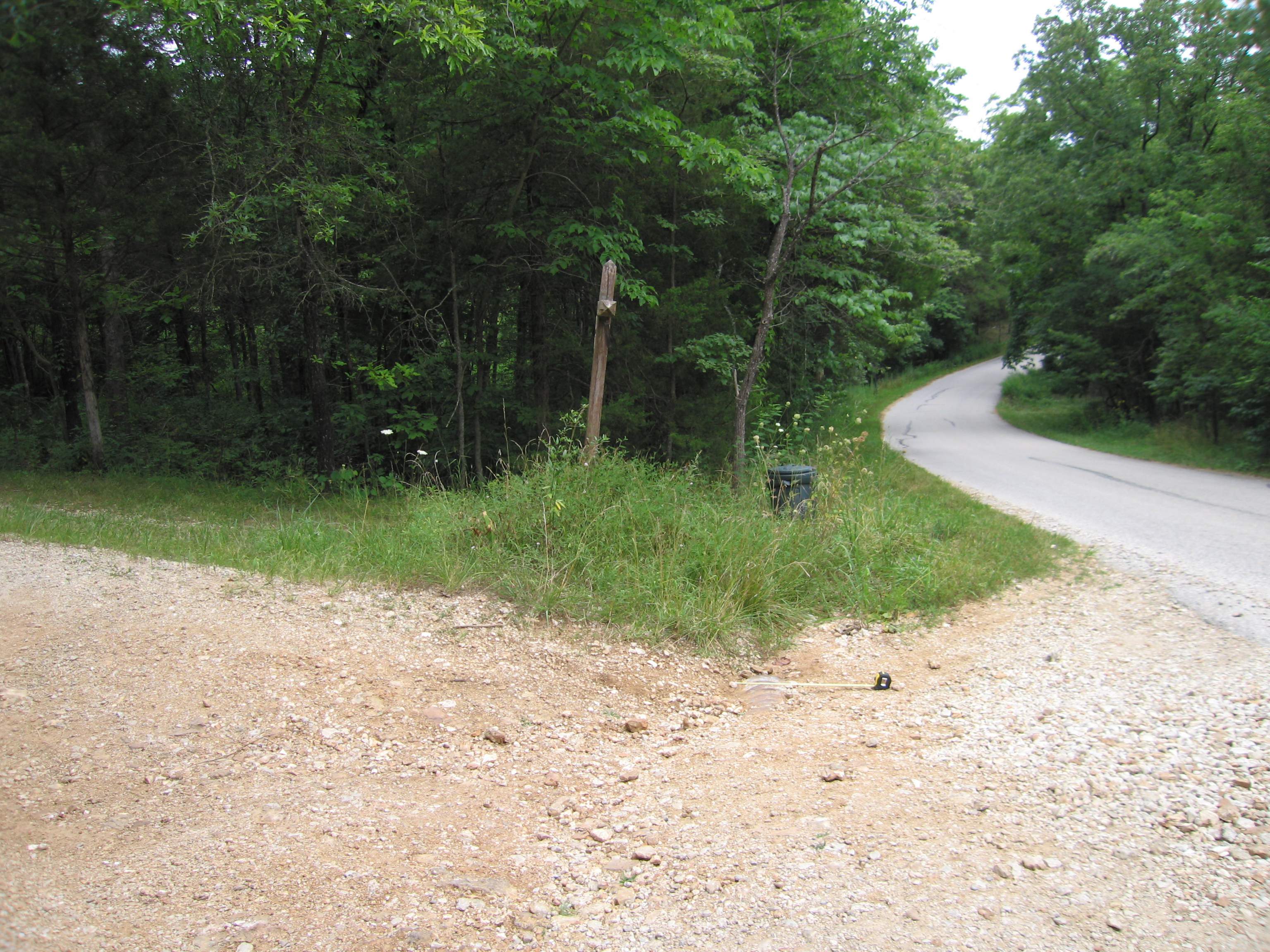

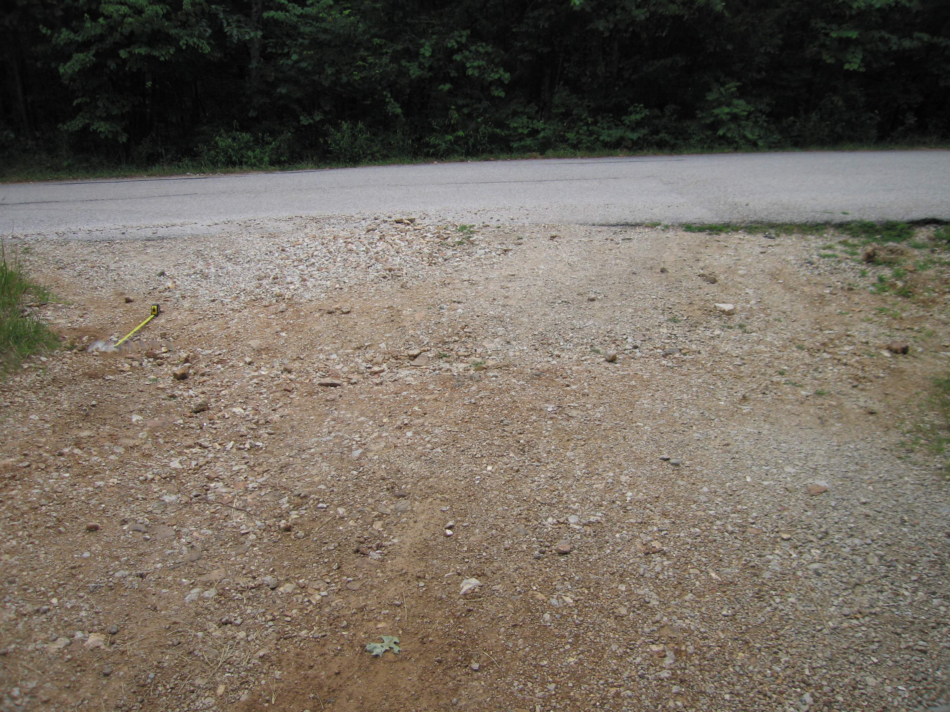

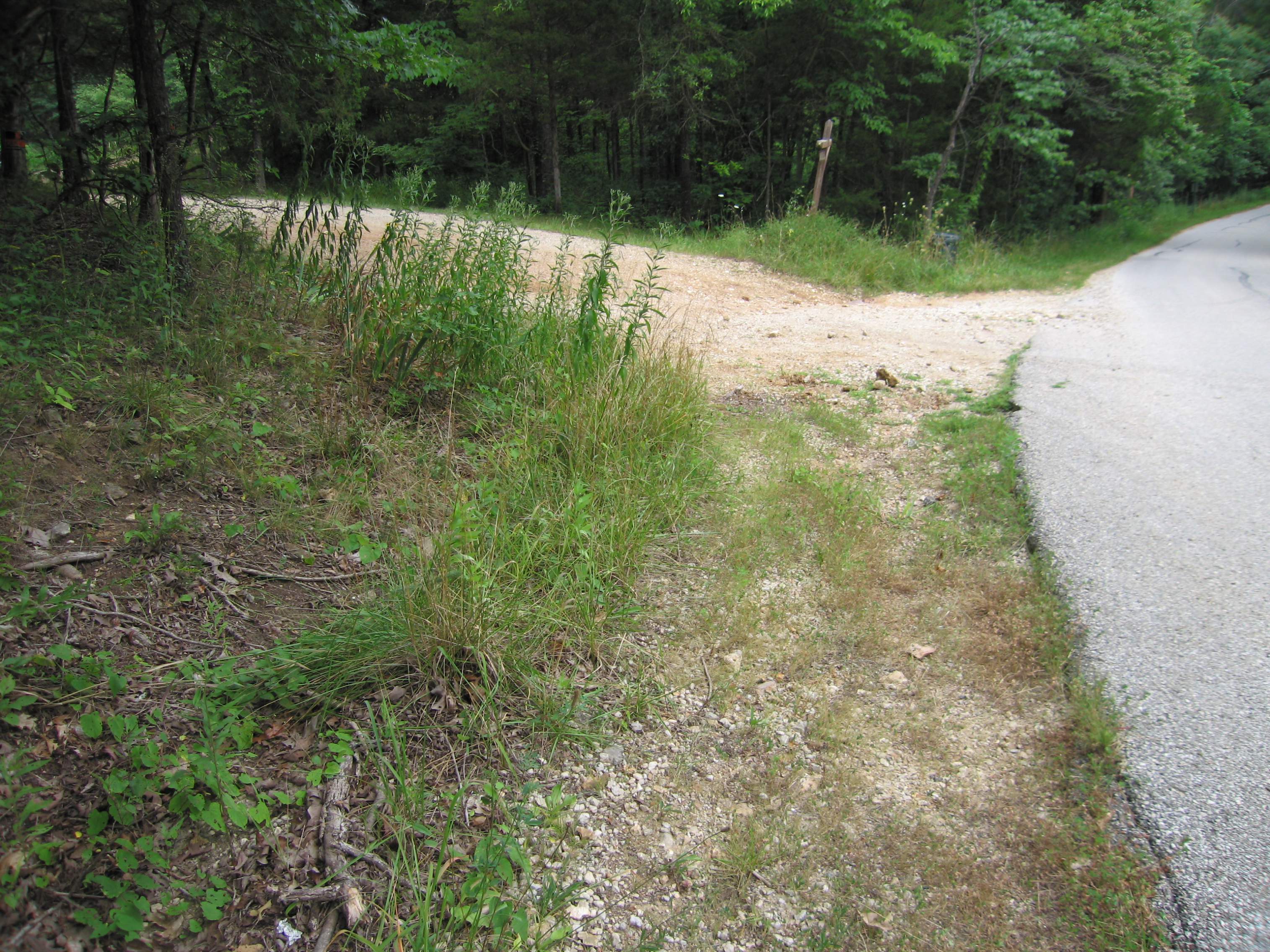

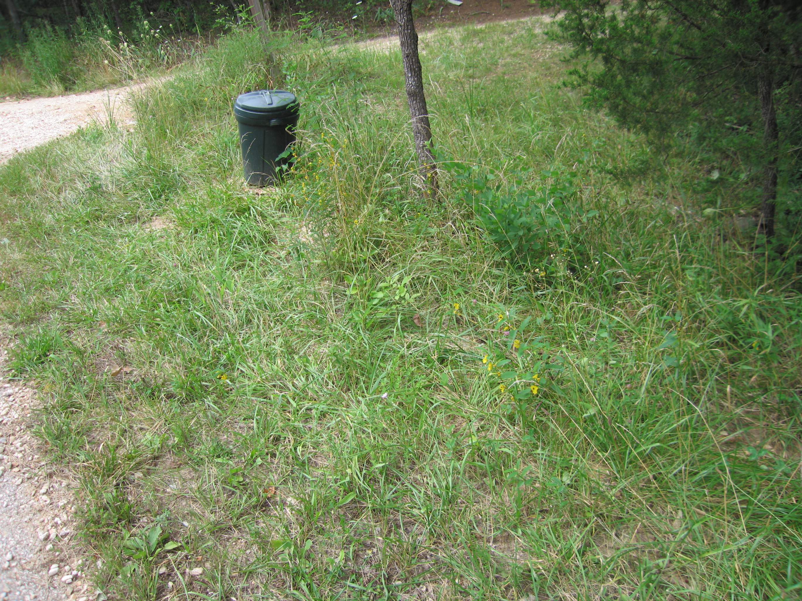

Hello all,
This thread is intended to document the success or failure of the following project:
Replace a shallow 12" x 20' steel culvert that is mostly full of debris with an HDPE equivalent. I estimate the empty steel culvert weighs 200 pounds and the HDPE less than that. For estimating debris weight, a full column 12" x 20' would be less than 16 ft^3. I only need to expose then push/pull the culvert to the side where a scrapper will pick it up.
Cost is the primary constraint. Time is not a constraint, but one weekend is the goal.
In addition to hand tools and physical labor, I plan to introduce a Deere 2305 tractor with 200CX loader and 260 backhoe. The loader has a 61" smooth bucket. The backhoe has a 16" tooth bucket, a ripper/trencher and a static thumb. I also have a 60" 3PT rear blade for final road grading. The loader breakout force is about 1,000 pounds. The backhoe breakout force is about 2,000 pounds.
I'm using this machine because it is what I have at no additional cost. Will rent or hire a larger machine only if necessary.
Photos attached. Opinions welcome.

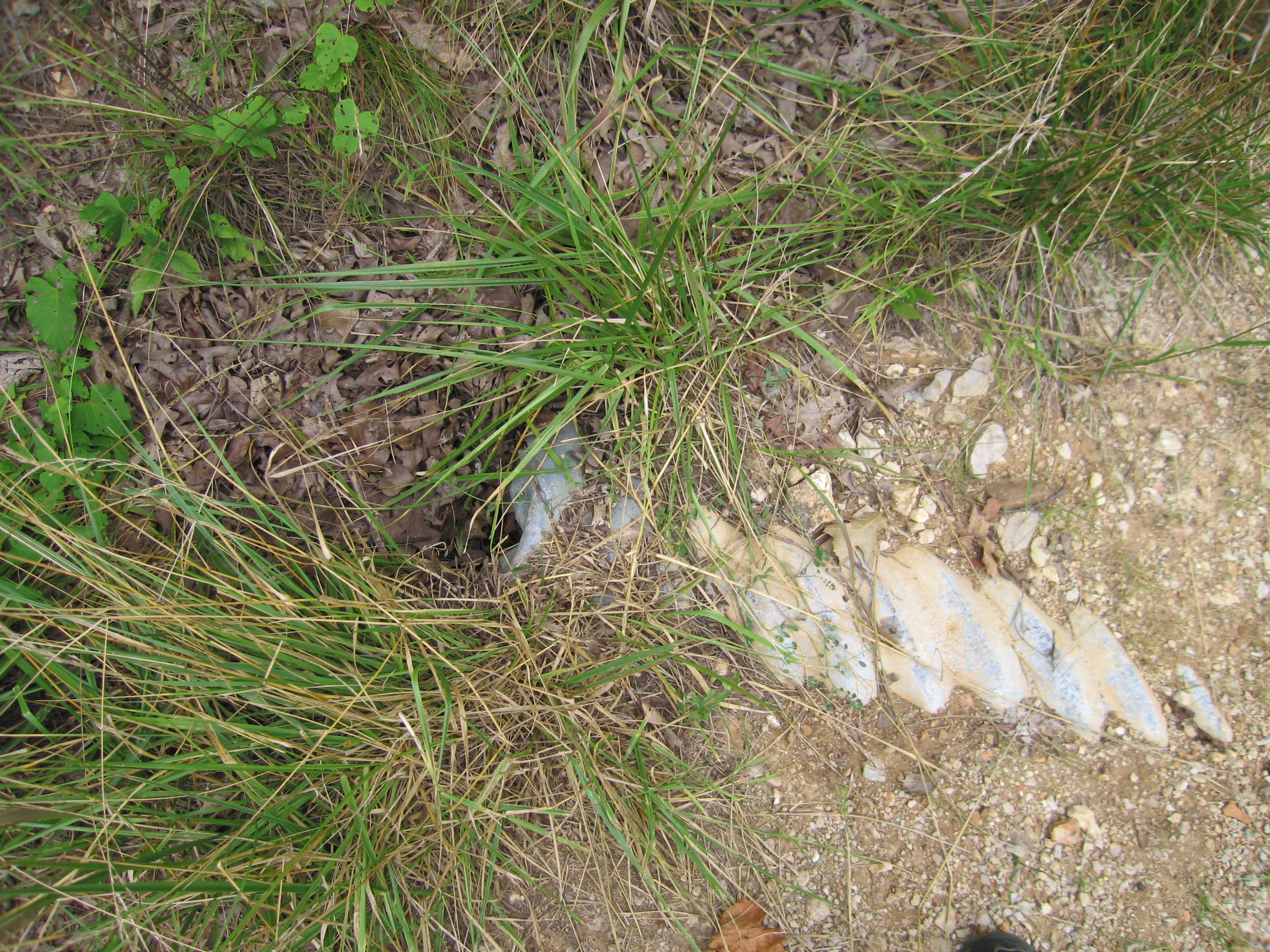

Is the culver just full of debris/dirt or is is crushed. From the pics, the culvert appears to be usable. I've cleaned culverts out before. Open up the ditch at each end to get good access, use water and shovels and other tools to loosen the dirt/gravel out of the inside of the culvert. If you could get a power washer in the area, that would help clean the it out.
Of course, that would be more manual labor compared to using the loader and backhoe to rip it out of there, contour the ditch and place a new culvert in there. You might also be able to reuse the current culvert it you remove the gravel from the top and are somewhat gentle with it.

Should be a good weekend project. We've done several similar culvert replacements over the years, although we used steel replacements. You'll find the backhoe will help a lot in loosening up the packed gravel. Try to keep the actual gravel separated from any fill material underneath so you can replace it in the same order. Be sure to compact the filled-in material as much as possible, but it will take some time to settle fully. It looks like the ditch on either side needs reshaping so it drains better. That may help keep the new culvert from filling up so badly. Are there any buried phone lines, etc. to worry about?
/ Culvert replacement - How big? #5
So I assume you will bring in more fill material for the top of the pipe? That's definitely sketchy right now. Should have 9-12" fill over top of an HDPE pipe, and go for 12" to accommodate cement trucks, etc. I agree with the others, if the steel pipe can be jetted out, then don't even mess with pulling it out. Add some material over the top to make a real culvert, and you're good to go. I'd only pull the pipe if it was damaged/rusted beyond repair, or improperly installed.

If the HDPF is exposed like the steel one you will slice the top off the first time you grade the road. To bury it deep enough you will have to lower the grade on your ditch, which will def add to your time frame.

If me, I would take the backhoe and clean the ditch out at each end of the culvert. Clean back several feet. I would then take a round nose shovel and see if the silt had closed in more than three or four foot of the culvert.
You may be over engineering, or over thinking. The front end loader in float and used to back drag will spread a lot of materials. Using the loader to spread gravel or dirt will save removing and replacing the backhoe.

Adequate drainage is indeed a concern. But looking at Stbill's pictures, I'm not seeing how to fit in a larger diameter culvert and also add topfill material above it. His smaller culvert is already barely covered underneath his driveway, which appears to be level and on grade with the road, and the ditch looks quite shallow (pictures can be deceiving). Seems to me to make his culvert bigger and also cover it with something like 12" of material, he'd have to either re-dig the entire ditchline along the road a foot or more deeper or he'd need to build an 18-24" whoop-de-doo hump over that culvert. If it were my place, I wouldn't want to do either. Maybe a better answer would be doubling up with a second culvert.
Because of the shallow cover, another steel or even concrete culvert might offer more strength than HDPE. Also, we've found packing the culvert in crusher run , stone dust or similar material seems to help carry traffic loads because it packs so tightly over time.

I decided to take FTG-05's advice (a big personal thank you!) and try to clear the culvert. It would save the cost of a new culvert... at least until we get enough rain to verify the pipe can handle all the runoff.
@PSDSTu: This is a private subdivision project and not on a county road.
The 260 backhoe exceeded my expectation on this now tiny effort.
I used the 16" tooth bucket to expose the downstream end of the culvert giving water a place to exit. Then I switched to the smaller Bro-Tek Ripper/Plow bucket and in two quick passes made a ditch downstream of the culvert all the way to the tree line. The ripper/plow earned it's keep for this one task alone because with the 16" bucket I could not dig into the rocky ground using the dipper circuit. It was troublesome enough to switch buckets that a hand shovel proved easier to move the pile at the end of the ditch.
Once the downstream end of the culvert was exposed we used just about anything we could to chip away at hard clay and roots occupying the culvert. Eventually we achieved daylight - a horizon really. The bottom half of the pipe is still clogged about 4 feet in, but we expect rain will quickly erode it (see below - still waiting to know if we are right).
I also spread 2 yards of 1 inch clean gravel where water had washed. I am mad at myself for not matching it better. Now I have to do the whole thing in limestone color. :thumbdown:
