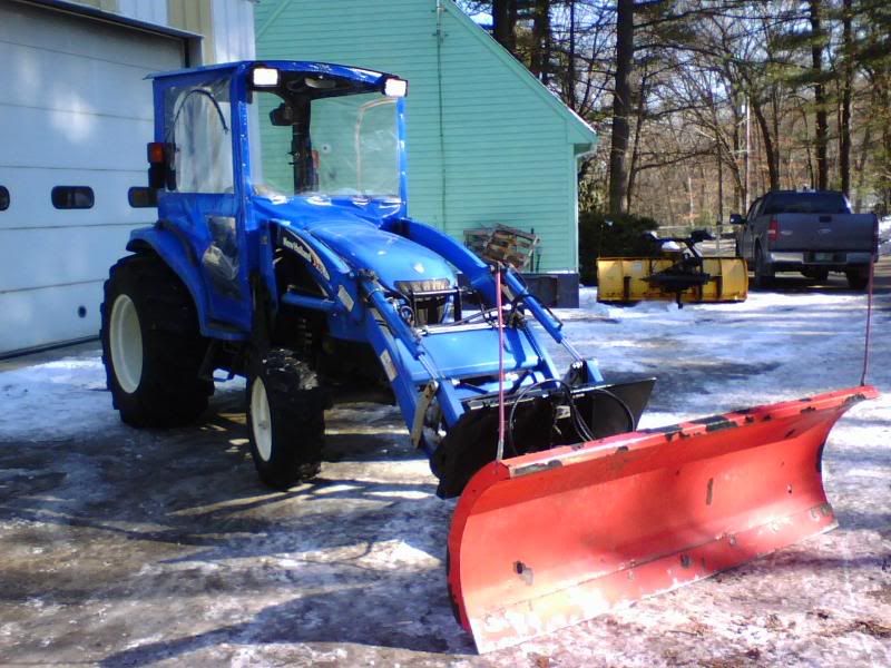

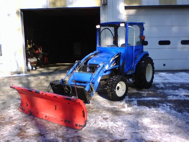

New Holland TC40DA
from front left
http://i147.photobucket.com/albums/r287/257nh/Tractor pics/0114001232-1.jpg
from front right
http://i147.photobucket.com/albums/r287/257nh/Tractor pics/0114001236.jpg

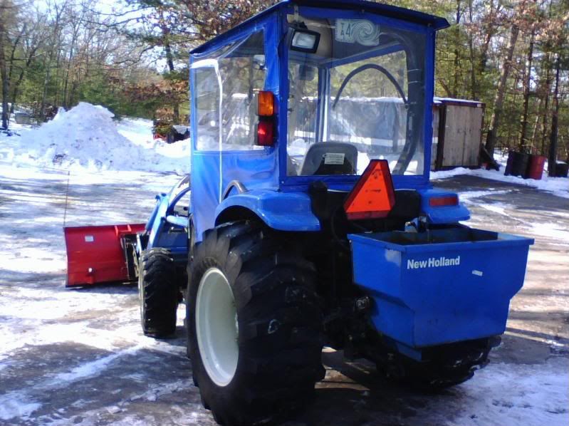

from the back
http://i147.photobucket.com/albums/r287/257nh/Tractor pics/0114001234.jpg

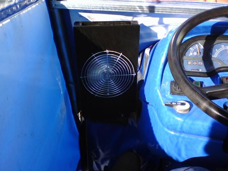

heater mounted on loader tower
http://i147.photobucket.com/albums/r287/257nh/Tractor pics/0114001237.jpg

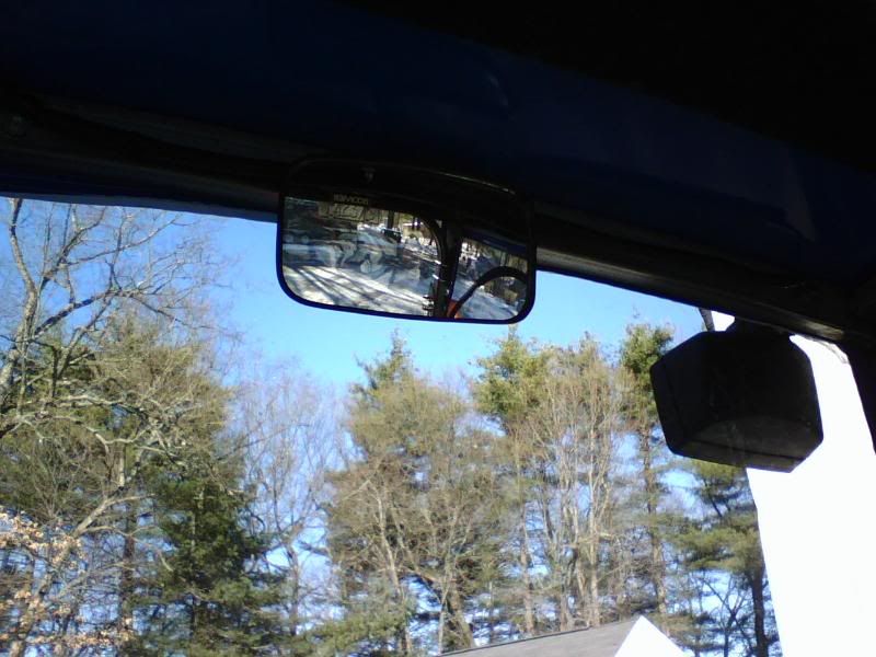

rear view mirror
http://i147.photobucket.com/albums/r287/257nh/Tractor pics/0114001238.jpg
84"ingersoll rand QA plow
http://i147.photobucket.com/albums/r287/257nh/plow3.jpg
Have already put in quite a few hours plowing with this setup and It does what I need. Installed a second remote in case I need to put a blower on the back.The heater is a 2 speed that blows up and down (the fan you see sucks air in)and does a perfect job of keeping things from fogging up,cab is not totally sealed up so that probably helps too.I was in the lucky position of being able to lend my tractor to my neighbor,(who is a professional boat canvas builder).to rebuild/regrade his yard and this enclosure was how he returned the favor.

WOW, that is really nice. Would it be too much to ask to have more detailed pictures???
Is the roof a regular tractor canopy or something he fabricated, if so, out of what. What did he use for the framing? How did he attached the framing, as well as the fabric, such as to the fenders?

I too would like more info about this like djradz. i.e. material used, how the frame was made etc. looks GREAT! Congrats.

I'll get some pics of the framing a little later but the material looks to be 1x1 square tubing that is used in awnings for buildings.The roof Is a wells ag canopy that I purchased online after hearing good reports by Bird and others.Also because it's advertised as a fops although it doesn't come with any sort of documentation stating that it is?I gave him full rein over how to do the enclosure and what to build it out of and to be honest I had a picture in my mind of an all black product so when I saw the blue on It I was shocked.I instantly liked it.I have also trailered it at 65 mph with no ill effect.Which,he told me I would be able to do because he has put the same materials on ocean going boats that do 80 mph.
