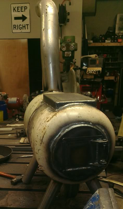

2 tanks, a section of diesel exhaust pipe and some other aluminized drops I scrounged from an exhaust shop, some channel, plate, flat stock, and a lot of electrode. :) Never did get around to putting the latch on it, but I have the spring knob for that.
I ended up extending the stack a bit since it didn't draft well that short. I've been planning on putting this in a deer stand someday - still haven't built the stand yet either. :eek:

I had plasma'd off the top end on several of these a number of years ago for making into little vertical oriented stoves and just never did it after my prototype with charcoal failed to produce any appreciable heat for the amount of fuel I had in it. So I took a pair of those for my donors and mated them up. I used the open end of the tank I cut the radius'd shoulder off to mark where to cut the one to fit inside it and leave a minimal seam. You could cut these to make a butt joint, but the lap is easier to align and holds itself from warping when you put the final weld in.
The two tanks together allows for 18" front to rear depth, so it'll hold a 16" split. Just need to get a little fire started in there and then add bigger wood. What's nice about the design is that you can dry your wood on top before feeding it if it's a little wet.
I also added some vent holes to the bottom and boxed in the air path with the intention of adding a gate to control the fire and a sweeper to pull the ashes out with, but found that I get a better burn varying the door's opening and leaving the bottom vent wide open. Probably an issue of too much fire for the firebox volume - but it still works.
I was lucky in scrounging a whole mess of these tanks (had over 30 at one point) back when the OPD valves were being phased in and no one was converting the old tanks so people just tossed them or gave them away. Now I use them for all my waste motor oil and store it to dump on my brush piles for accelerant. :)
