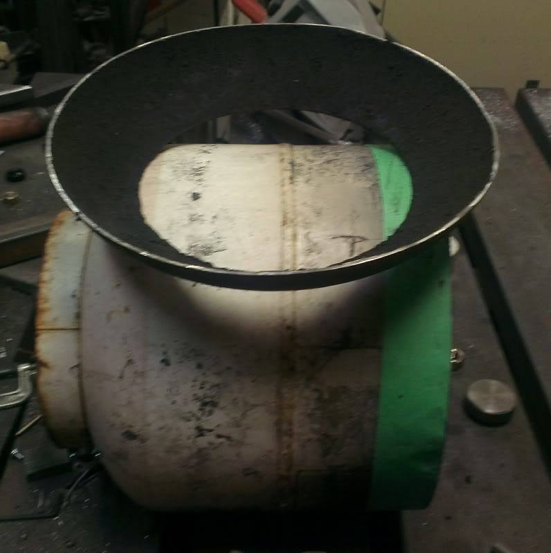

   / cut open a propane tank #50
I was reading a post on moving a propane tank.
Got me to thinking. How could I cut it open and make a fire pit out of the end caps.
Some information.
[video]http://www.business.govt.nz/worksafe/information-guidance/all-guidance-items/hot-work-on-tanks-and-drums/hot-work-tanks-drums.pdf[/video]
Here's a video of welding on a C3 tank. Sorta a
"How Not To Do It".
Don't think the fellar can weld either. Don't think he's got the right type of 90 there either.
