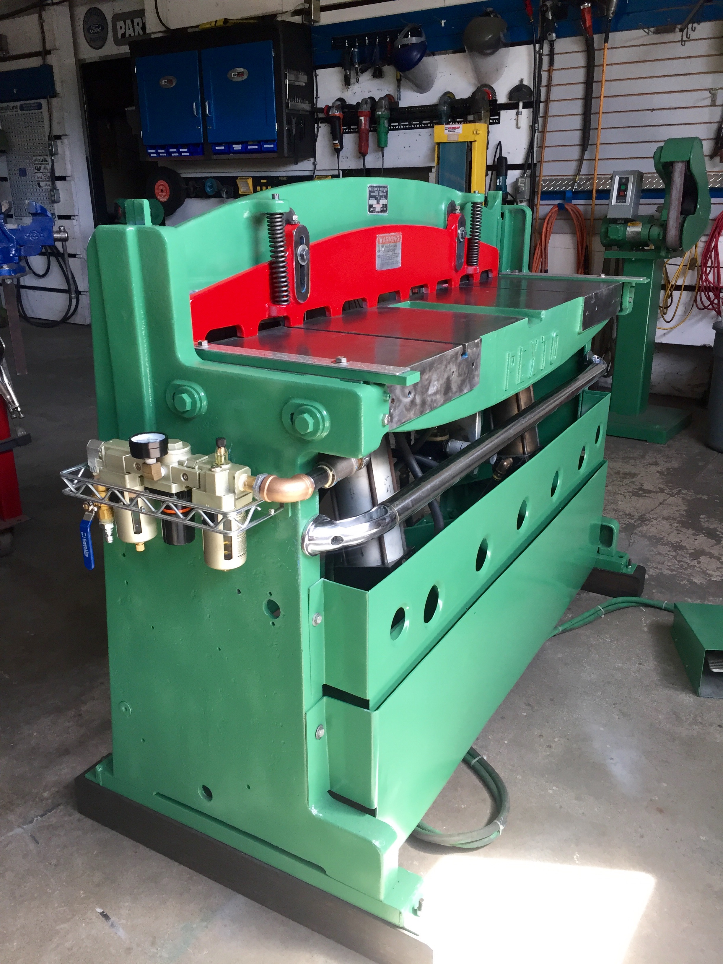

But again, it's all about the length of each cut. I can make a 12-18" (maybe up to 36") straight, clean cut with those shears in less time than it would take to set up for a circular saw cut. I got to where I only used the saw when I wanted to cut longer (up to 13') panels lengthwise.
Another option you'd have to test on some scrap ... You can score (with a razor knife), then bend and snap 29G roof panels. I don't know if you can do that with 20G Galvanized.
One more thought. With a circular saw blade, you lose 1/8" minimum with each cut. Shears mean no loss of material at all.

For 20ga, the Harbor Freight shear would be nice. I use a DeWalt shear 18V Cordless 18 Gauge Swivel Head and Shear Kit - DC49KA | DEWALT for some things like that. If you're figuring closely on the material, be aware that each cut costs about 1/4" of material to make the "Spam can strip" of waste. The shears Diggin It used can cut on the line and require no extra material. Cutoff discs, circular saws and plasma do use a little.

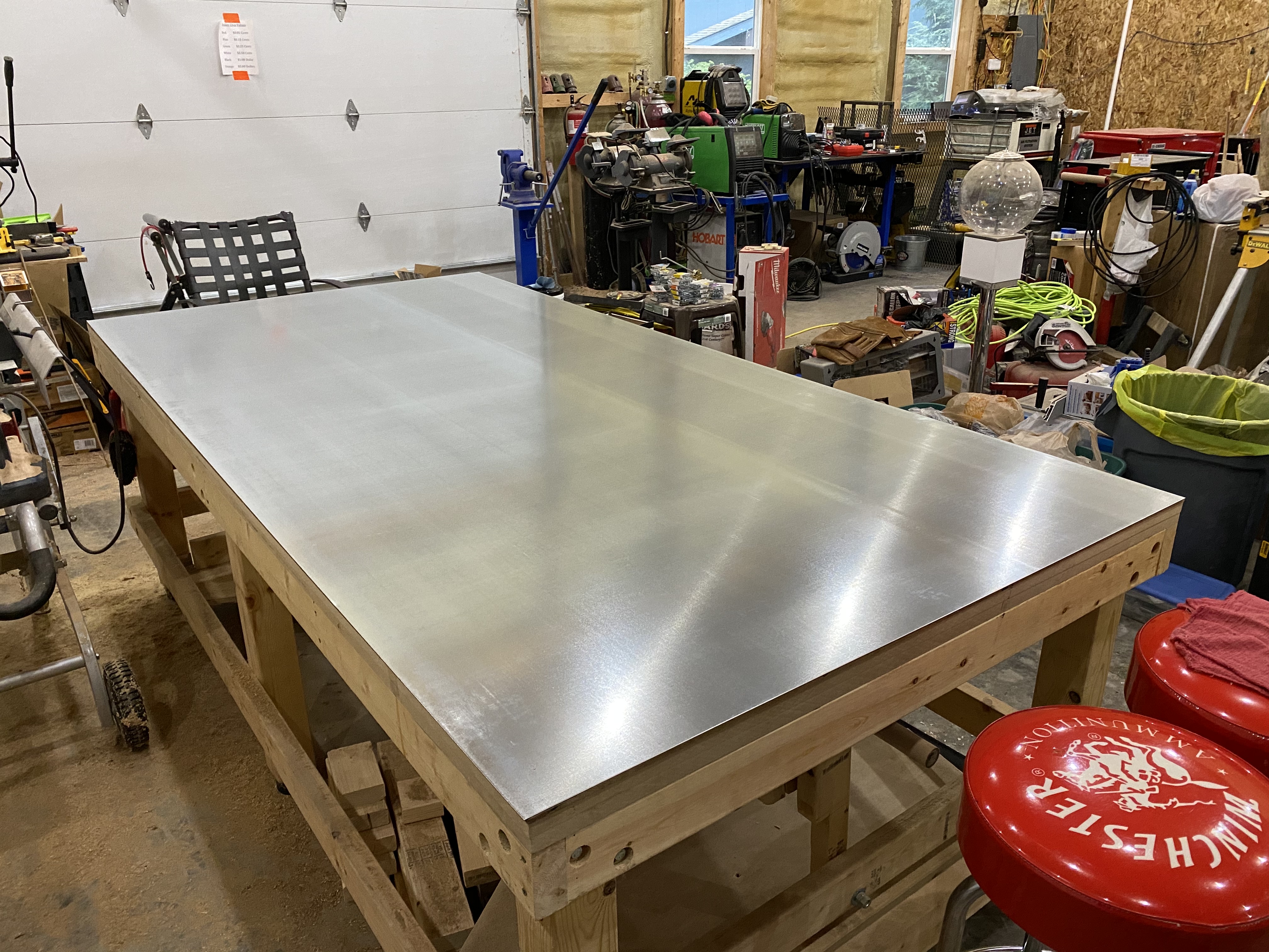

Holy Cow, Big Barn!! I’m experiencing extreme tool
Envy!
Got the sheet metal onto the project table yesterday. It makes a great looking top to the table. Too bad it’s going to get cut up.
