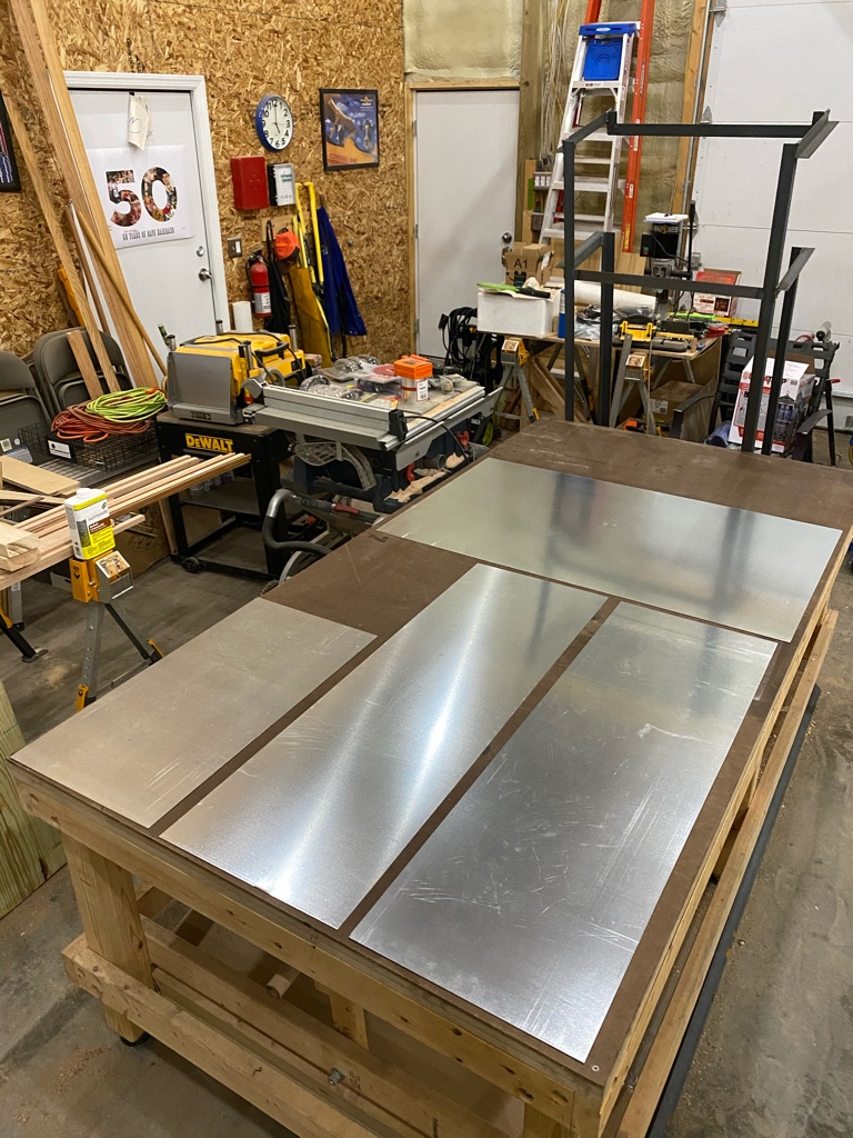

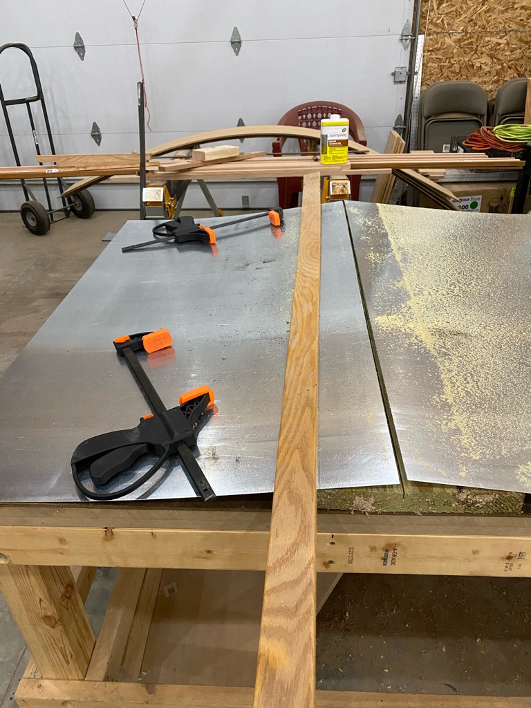

#40
Well, the carbide circular saw blade worked great. I was able to get a smaller one for my cordless trim saw and the upside to that is that the kerf was only about 1/16”.
I put a sacrificial piece of 2x12 under the cut line, clamped the edges down the 2x12 so it laid flat and set up a fence for the saw to follow. It worked great!
A very clean cut, no deburring needed and nice, straight lines
Thanks for all the good advice. (And even with a full face shield, I managed to get a fair amount of finely cut metal flakes in my hair!) : -D
Here’s some pics:
