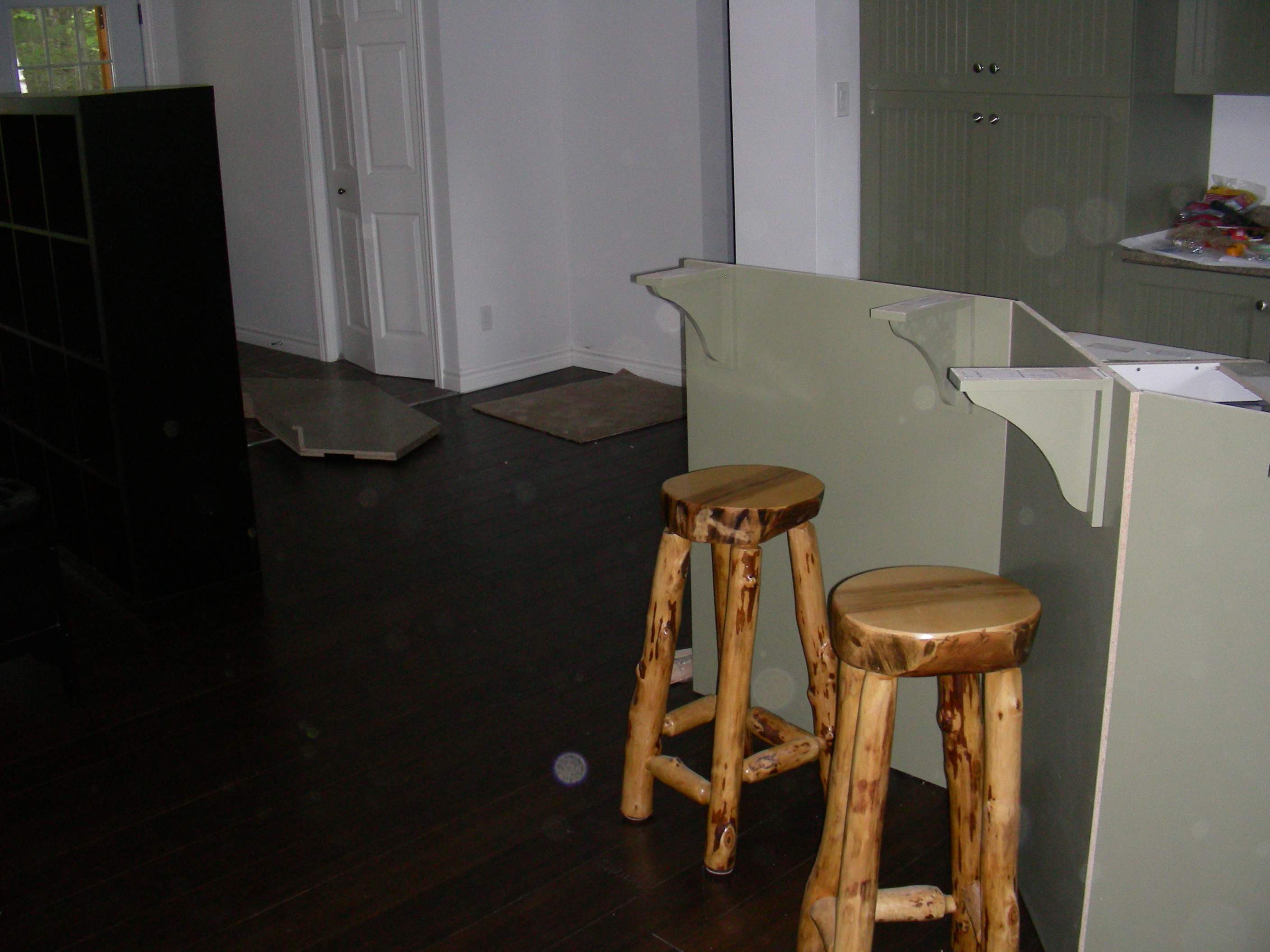

My daughter has enlisted me to get her a piece of maple 5 inches thick x 9 inches wide by 72 inches long for a rustic fireplace mantle...from my woodlot. Now I have made rustic furniture out of my maple trees in the past (bunk beds, bar stools etc). But this time the length wise cut 6 feet along a log (twice) with my Husky 435 chainsaw 16 inch bar seems intimidating without some advice.
