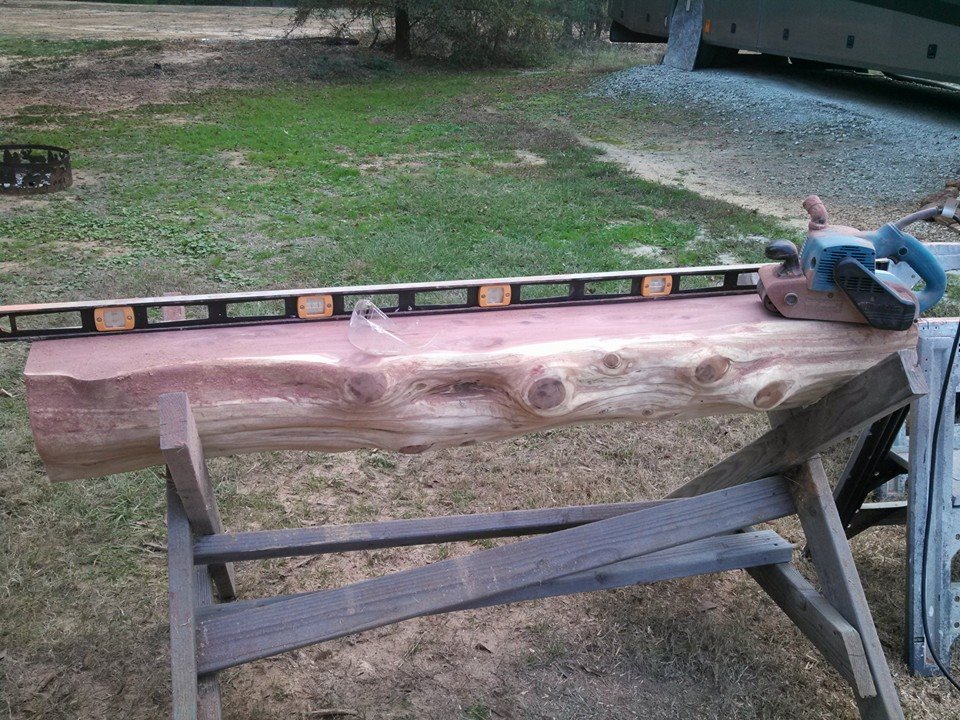

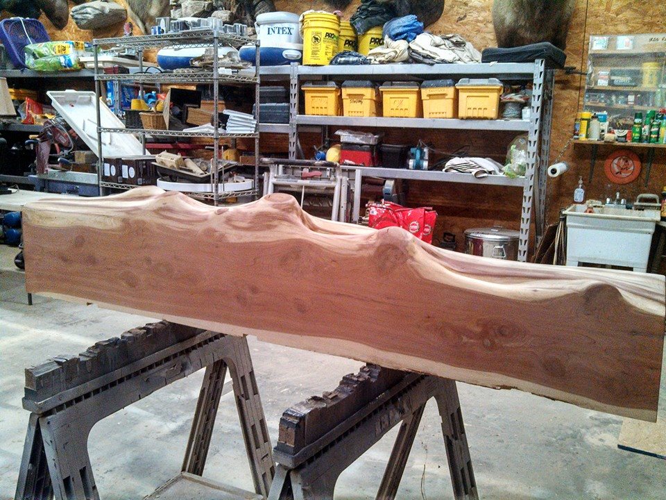

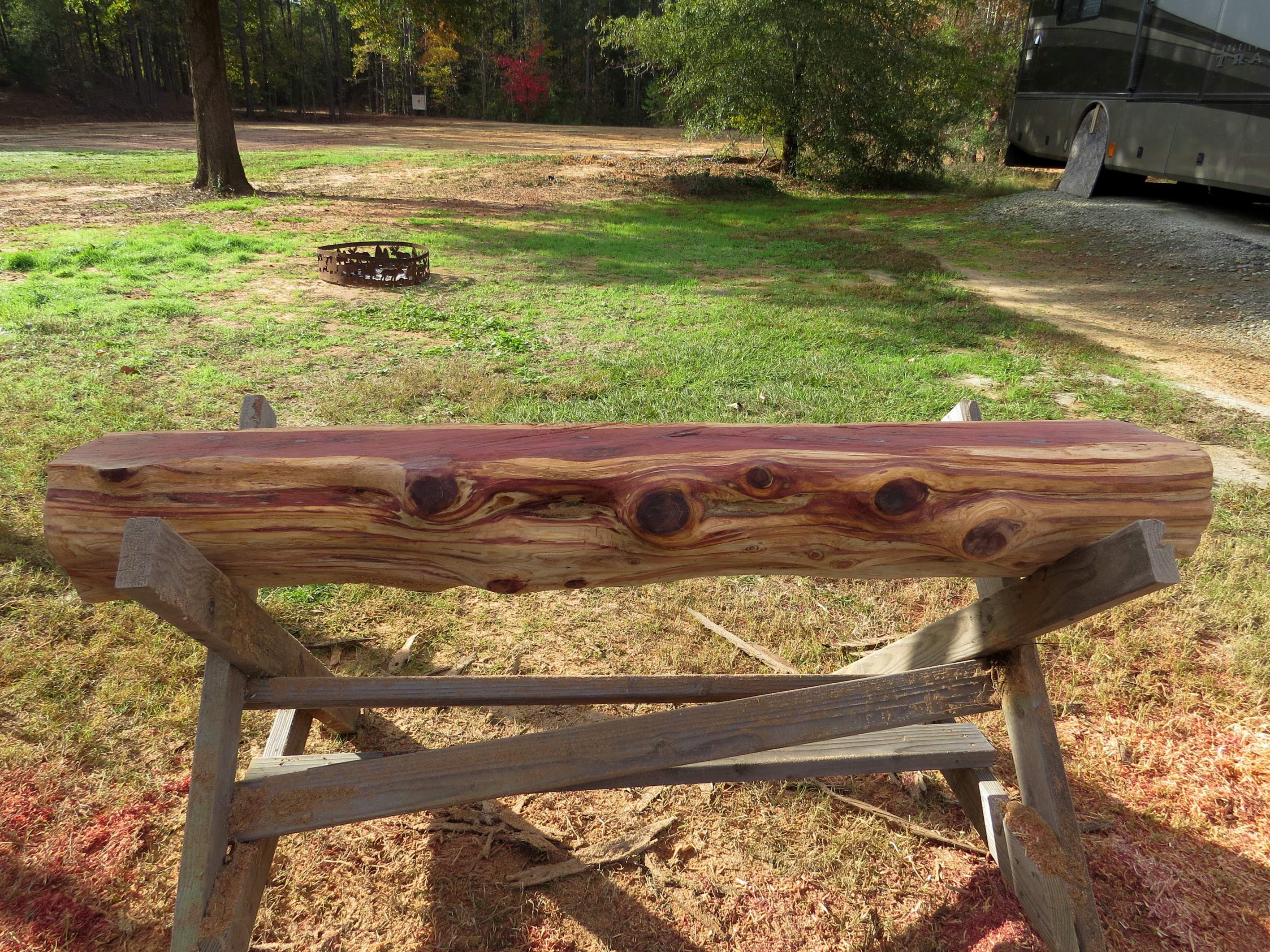

I just finished a mantle for my parents fireplace that was a cedar tree from the land. It had been down for a couple of years and had a really nice shape to it. I wanted it to be 5 1/2 feet long with a flat top and back. The front and bottom where to remain natural in shape, but highly sanded.
To cut it, I used a chalk line to have something to follow. I put the log in a pair X shaped saw horses that I made from scrap 2x4's at an easy to cut height. First I cut it shallow with the chainsaw to get my line. Then I cut it all the way, taking my time to make sure I kept the blade straight down. Then I rotated the log 90 degrees, put down another chalk line, cut it shallow, then cut it all the way.
The log was about a foot longer then I wanted it, so after cutting the length, I cut it down to the exact length that I wanted it to be.
Then I sanded it with my big belt sander and used a six foot level as a straight edge to find my high and low spots. With 40 grit paper, it got it all leveled and smoothed out in a couple of hours.

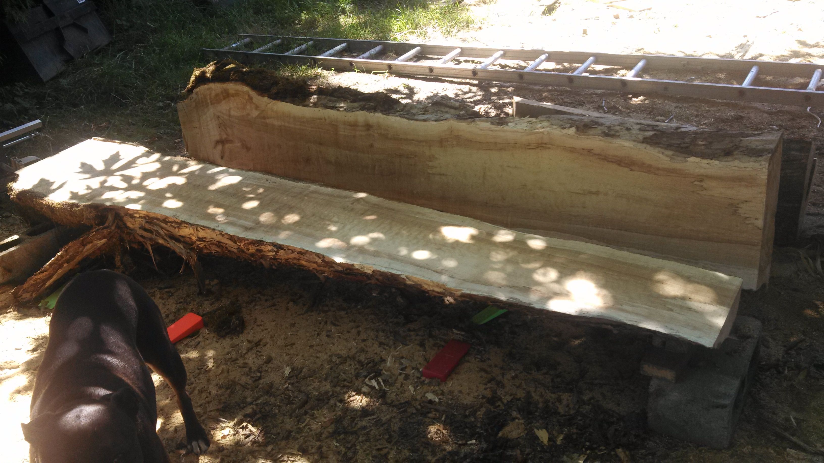

I used my Alaskan mill to do a mantle for my neighbor. No pix, had to build a custom mill head (not so custom but it works) to do the verticle cut. A ripping chain is very nice to have in the process. Downside is that a big piece of wood needs years to properly dry.

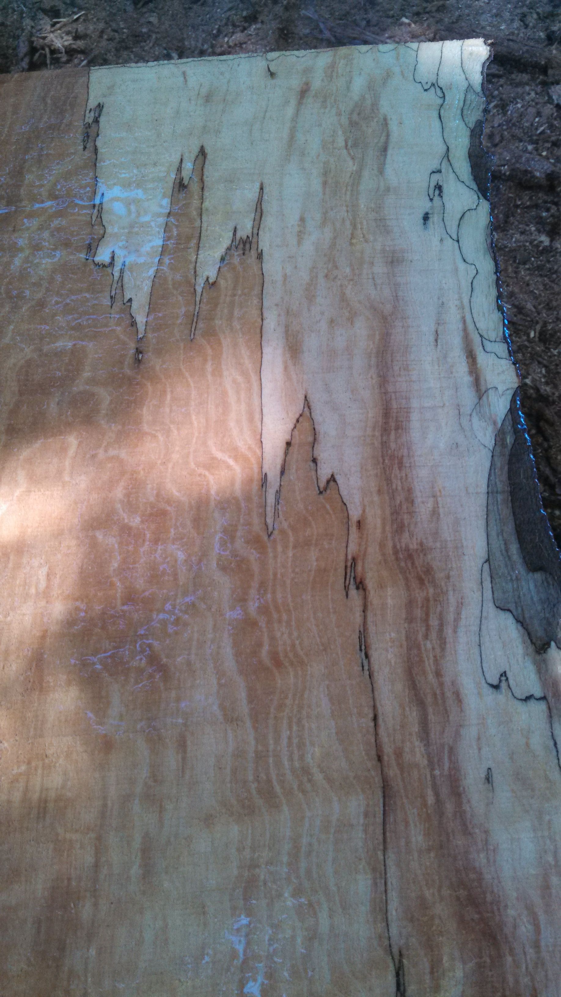

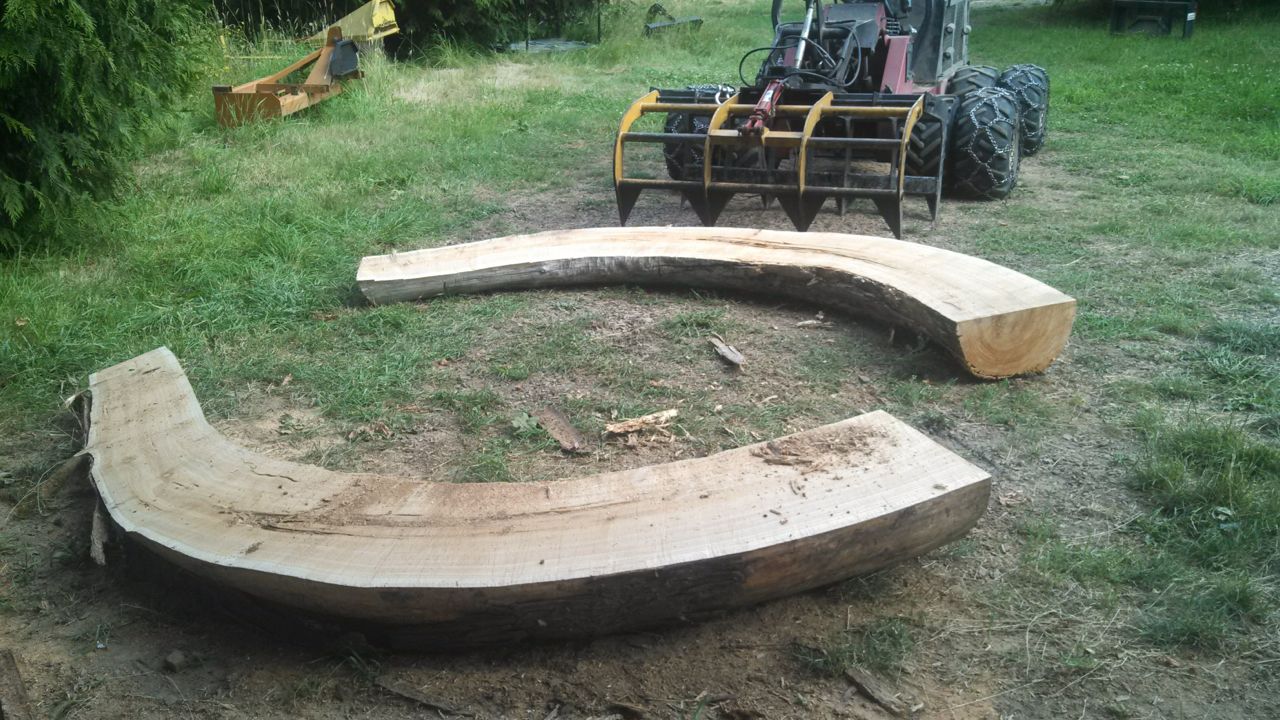

These are some pictures of maple and cedar I cut up.... Making property benches (benches along hiking trails)

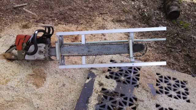

I have a Granberg Alaskan Chainsaw Mill, as well as their Mini Mill (which is cheaper and the only thing you need for sawing beams or a piece like this mantle). However, I use a 77cc chainsaw, because that is what's required for milling (and many people go even bigger). I also use rip chains. You will most likely melt down your little Husky if you attempt to use that saw for such a long (time wise) set of cuts. It will not cool quickly enough, and it's not a pro saw that can handle repeated long cuts.
As far as drying, do not expect quick results if you want to do it right. A piece like that is going to need to air dry for a few years. The only way to accelerate it without wrecking the wood is to find someone with a kiln who knows how to use it.
Not trying to rain on your parade here, but you're heading in a direction that will trash your saw and leave you with a big warped piece of green wood.
