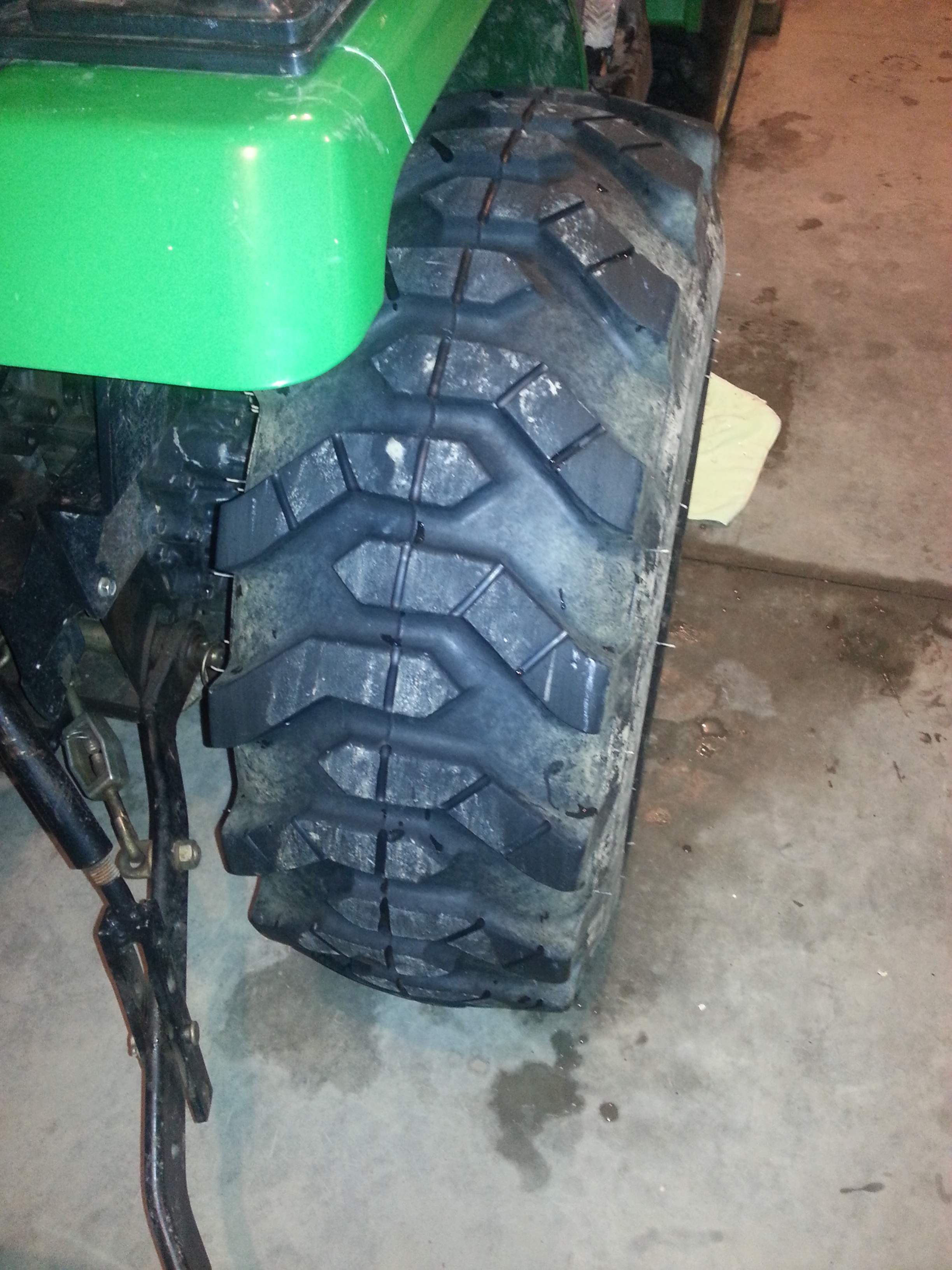

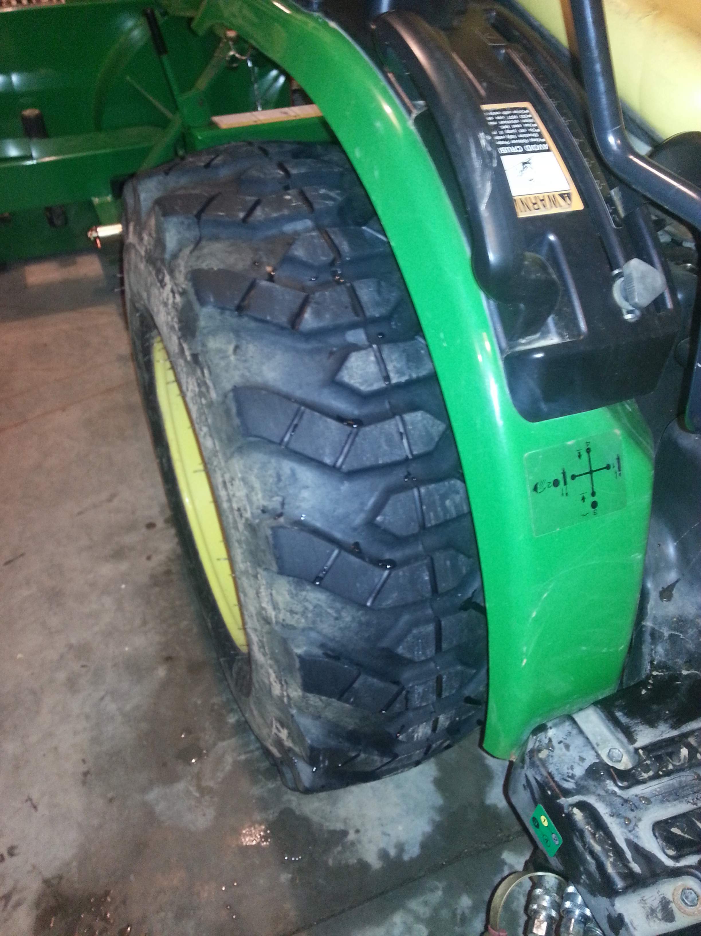

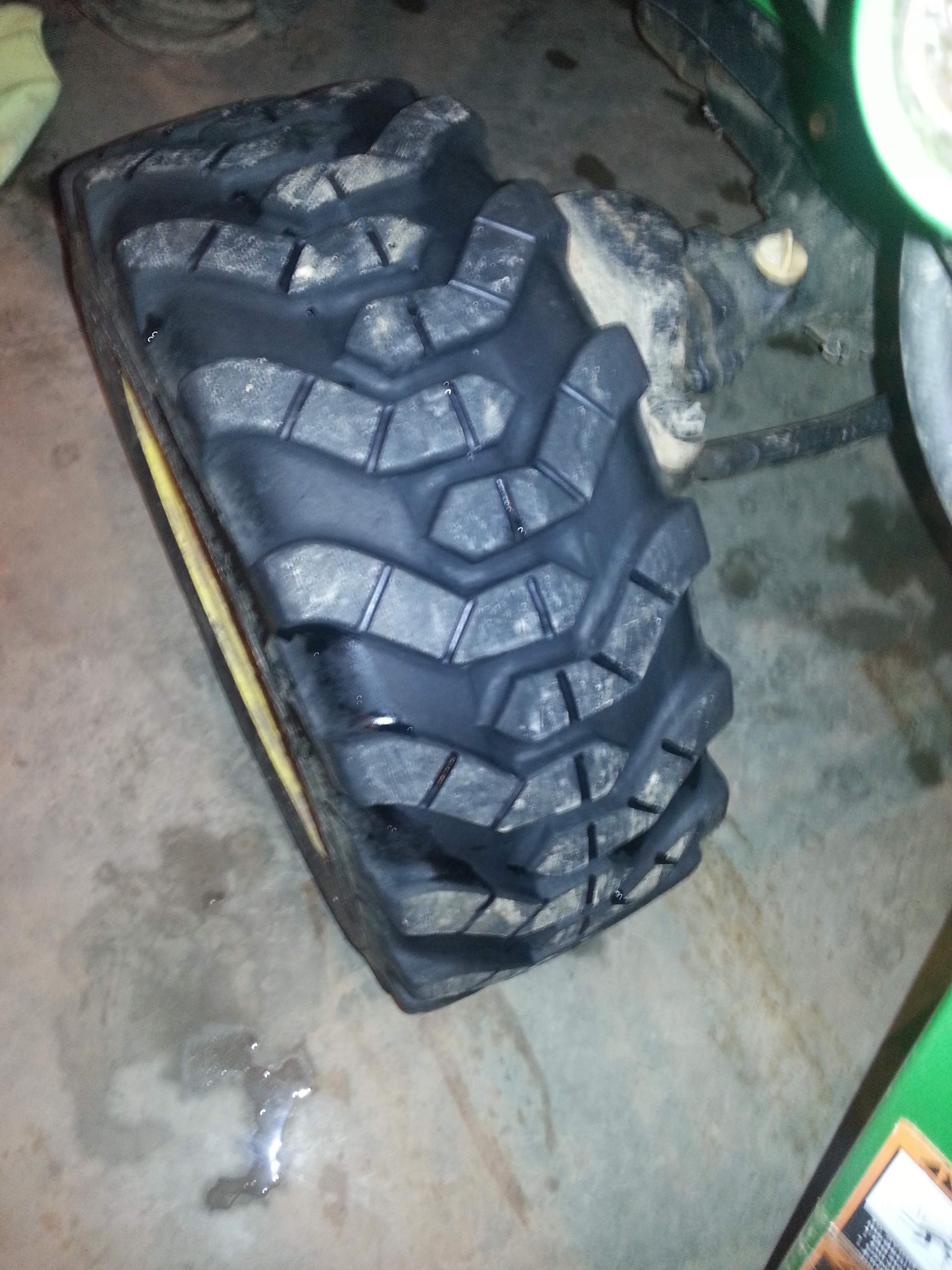

Ordered my grooving tool on Monday, came yesterday. Guess what I did today?:D I started on the front tires by measuring 1/2" in from the outside edge of the lugs for a starting point. As long as you give the tool time to heat up properly it was pretty straightforward. I put one groove in the center of each lug then ran a groove all the way around the center of the tire. That part was easy as the tires are still fairly new so I could see where the mold met in the middle of the tire. I went with a single groove on each of the rear tire lugs. The outside lugs were like butter, just put my azz behind it and the tool went right through. I used a very complicated technical method of marking where I wanted to start the groove on the rear tires. I took a flat carpenter's pencil, lined it up with the outside of the lug and used a sharpie to mark a line. The inside lugs took longer and required more arm work, but I got it done.

I saw someone else ran a groove around the center of the tire and I thought that based on everything I've learned that it made sense. When turning, the front tires can grab snow on the centerline of the tire for lateral traction.
Rear tires I went with a single groove per tire. 1/4" deep on the front tires, about 3/8" on the rears. Did it all freehand, I just marked where I wanted to start on the outside edge of each lug.
