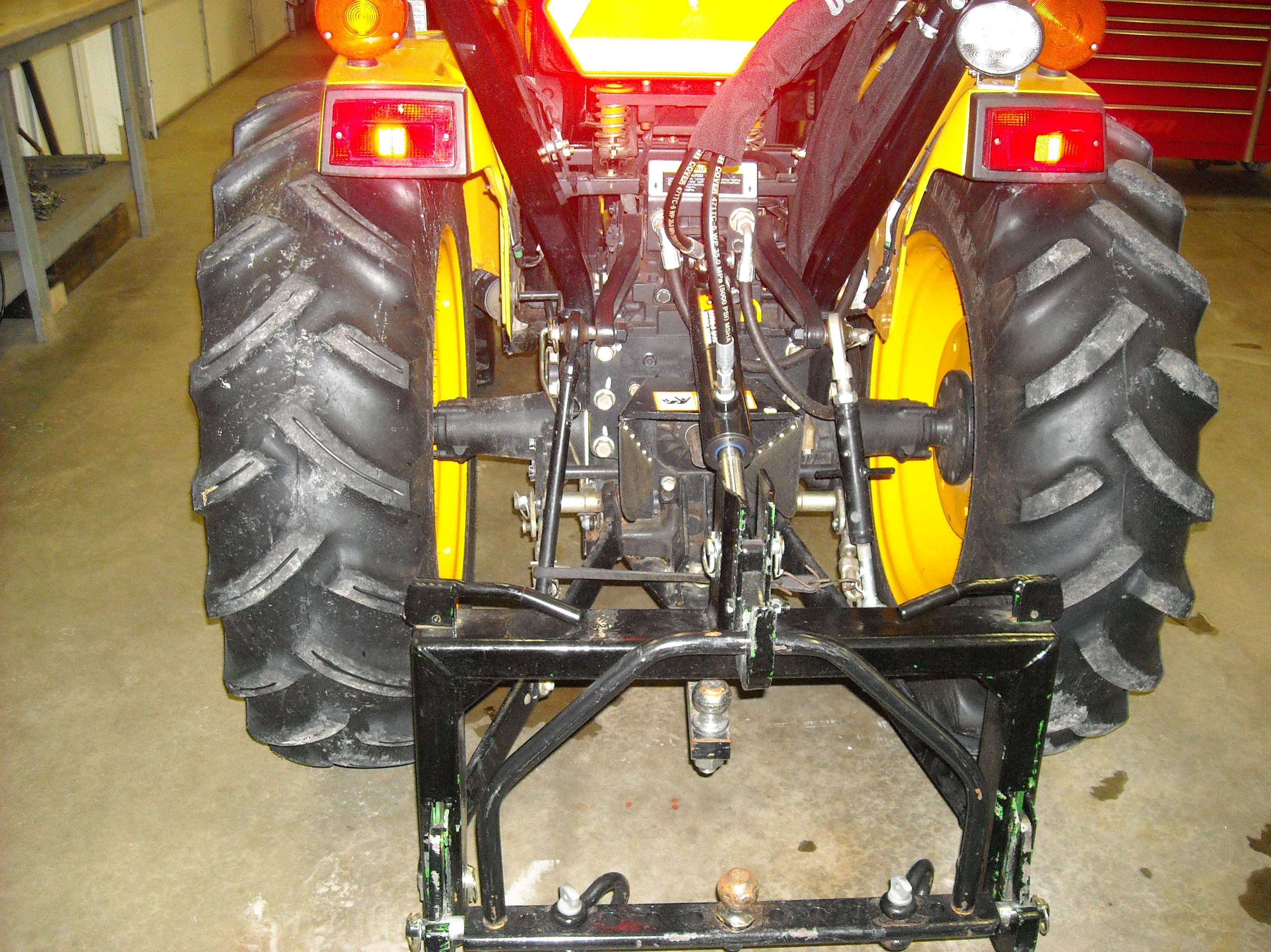

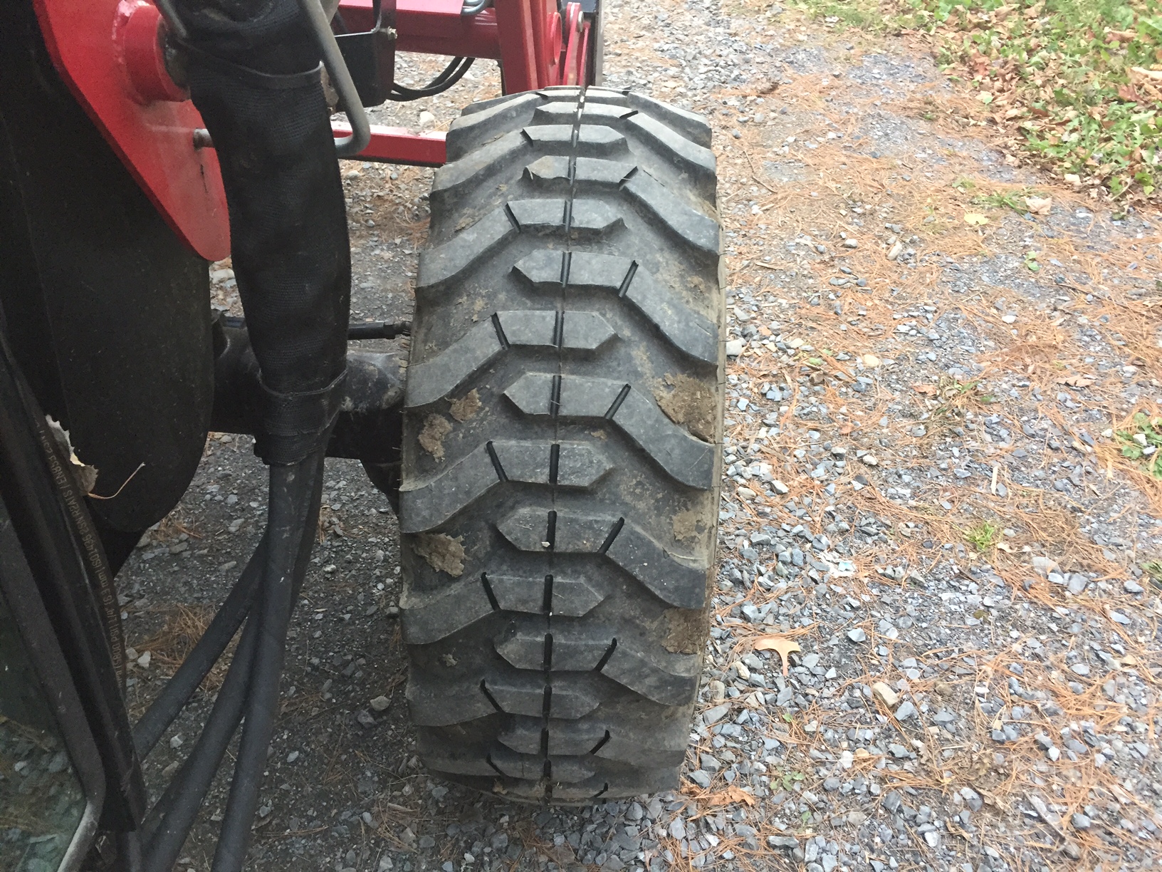

For the sake of science, you should groove the tires on your new machine...
Ok, since it's in the interest of science!
Here's the rears on the new machine:

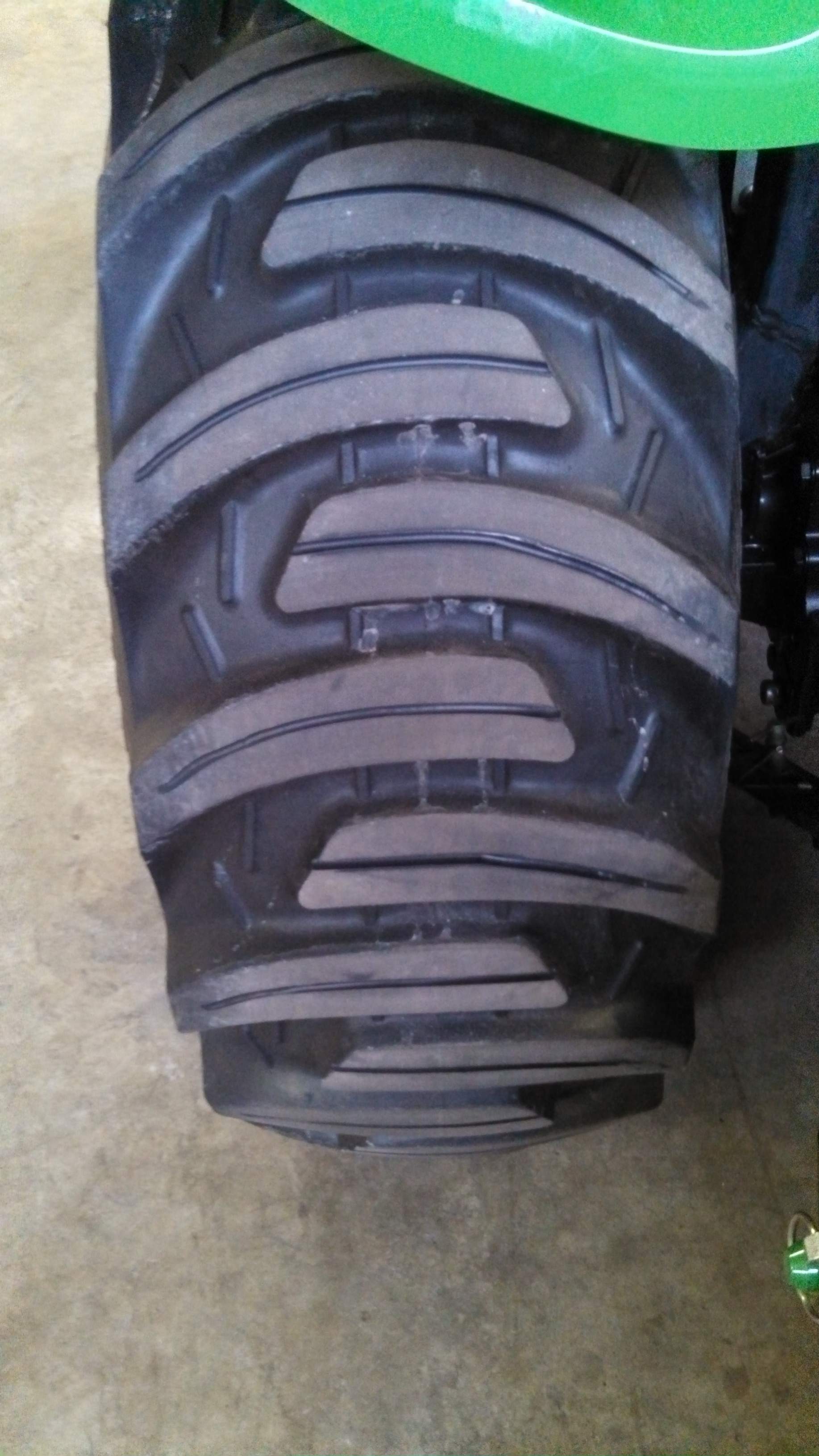

Well after making a pattern of the lugs I felt that a double grove on the rear would lead to chunking so I came up with a different pattern that would give me a double grove where the lug was thicker and would also allow for the most traction. On the front tires I used a pattern that was shown earlier in this thread, if it doesn't offer enough traction to prevent sideways slide I can always add another grove.
View attachment 487604View attachment 487605View attachment 487606View attachment 487607
:drink:
Looks awesome! Love the creativity on this thread! :thumbsup:

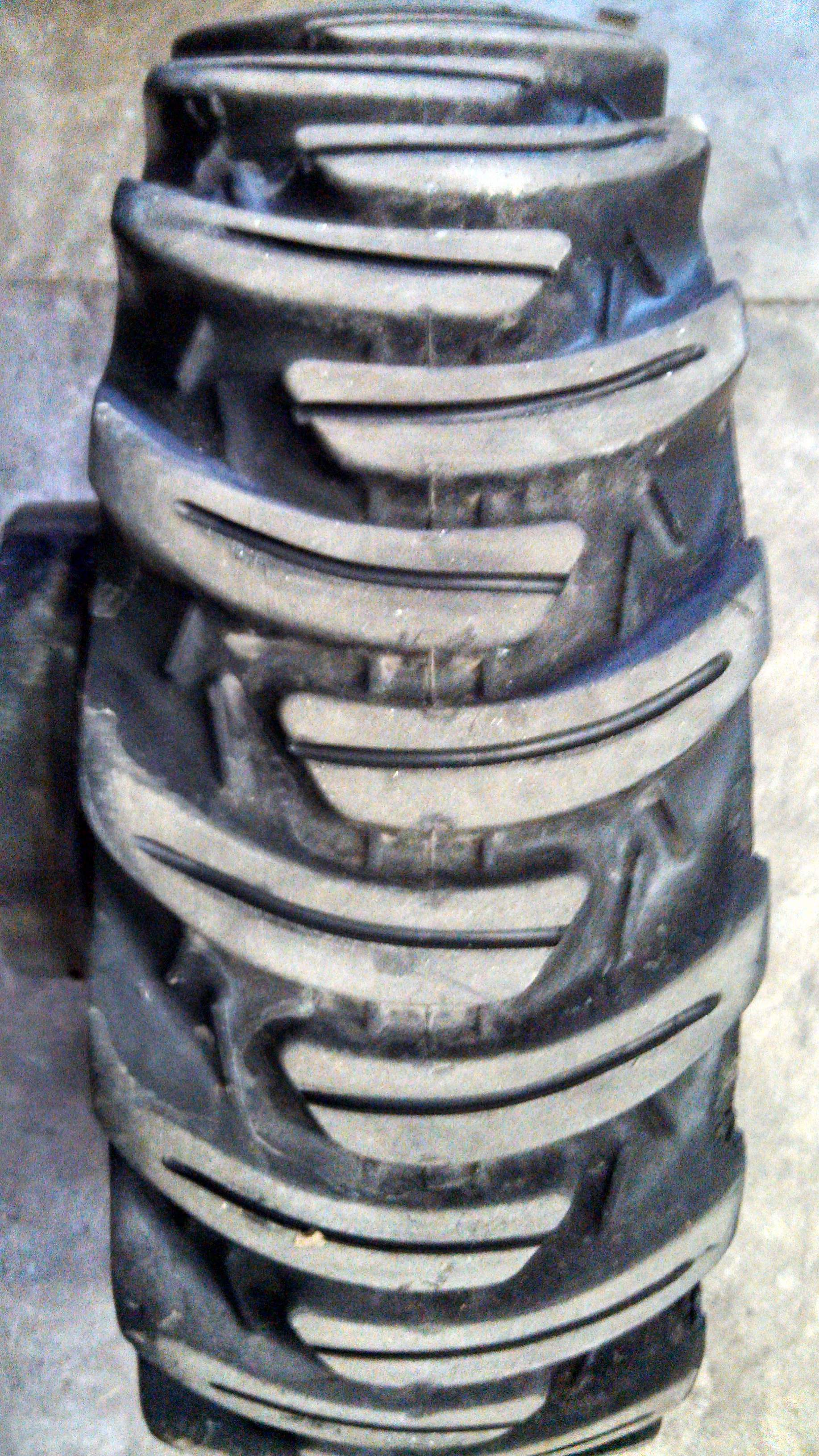

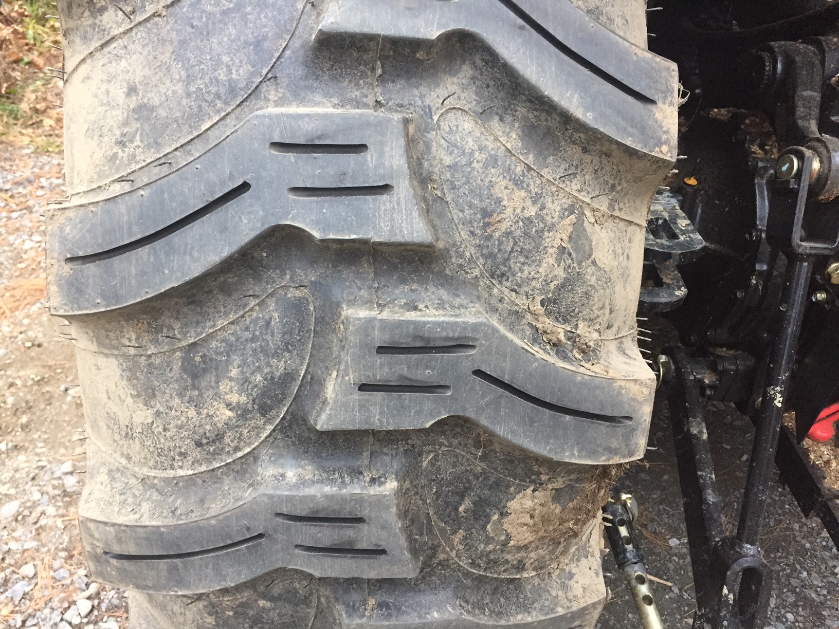

Someone had asked for a pic of my "double grooved" rears ... Finally had a chance to snap a pic...

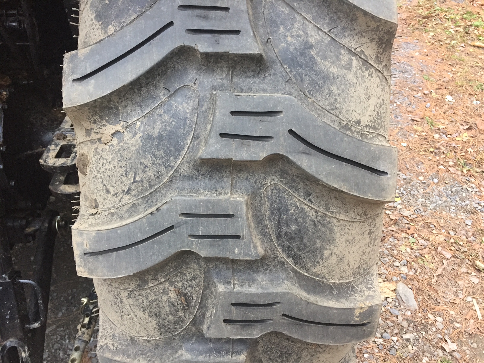

:drink:
Nice cuts. Did you have any trouble lifting out at the end of the cut? I can see that plunging in is easy due to the shape of the cutting head but pulling up and out would seem to be a bit of a trick or twist of the wrist.
   / Cutting / Groving / Siping R-4 for snow #500
Thanks for the compliment dickfoster.....It took a little practice to end the cut like you say, but a combination of tilting the iron forward on the tip along with a twist of the wrist seemed to deliver the best results.
