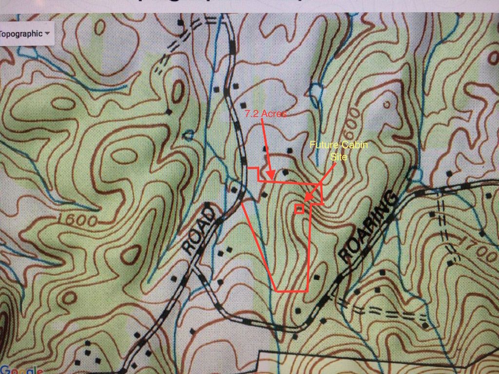

Here is a picture of my property Topo.
I'm estimating the total length will be 500-800 yards, some flat logging road then rest on hillside going up to top of ridge.
Soil is rocky and clay mix.
Time: I'm retired
Money: As little as possible, hence ME doing it.
Equipment: What I have available, Kioti CK2610 TLB and 5' Scraper Blade.

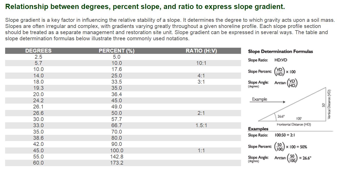

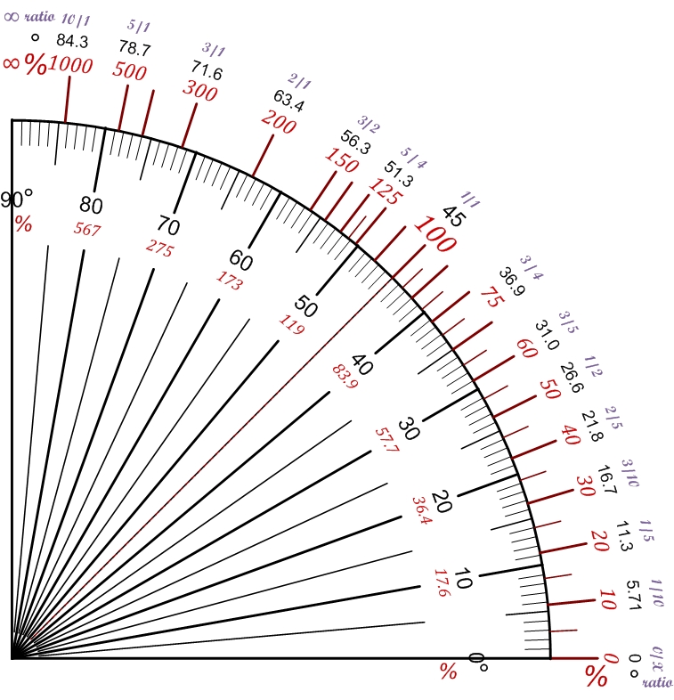

Just so there is no confusion between slope % and slope degrees:

If you look at the picture I provided of the property you will see a destination, the red square on top of the hill, labeled "FUTURE CABIN SITE". So it's not just a switch back and there is a purpose.

Great information, thank you for the informative post.
