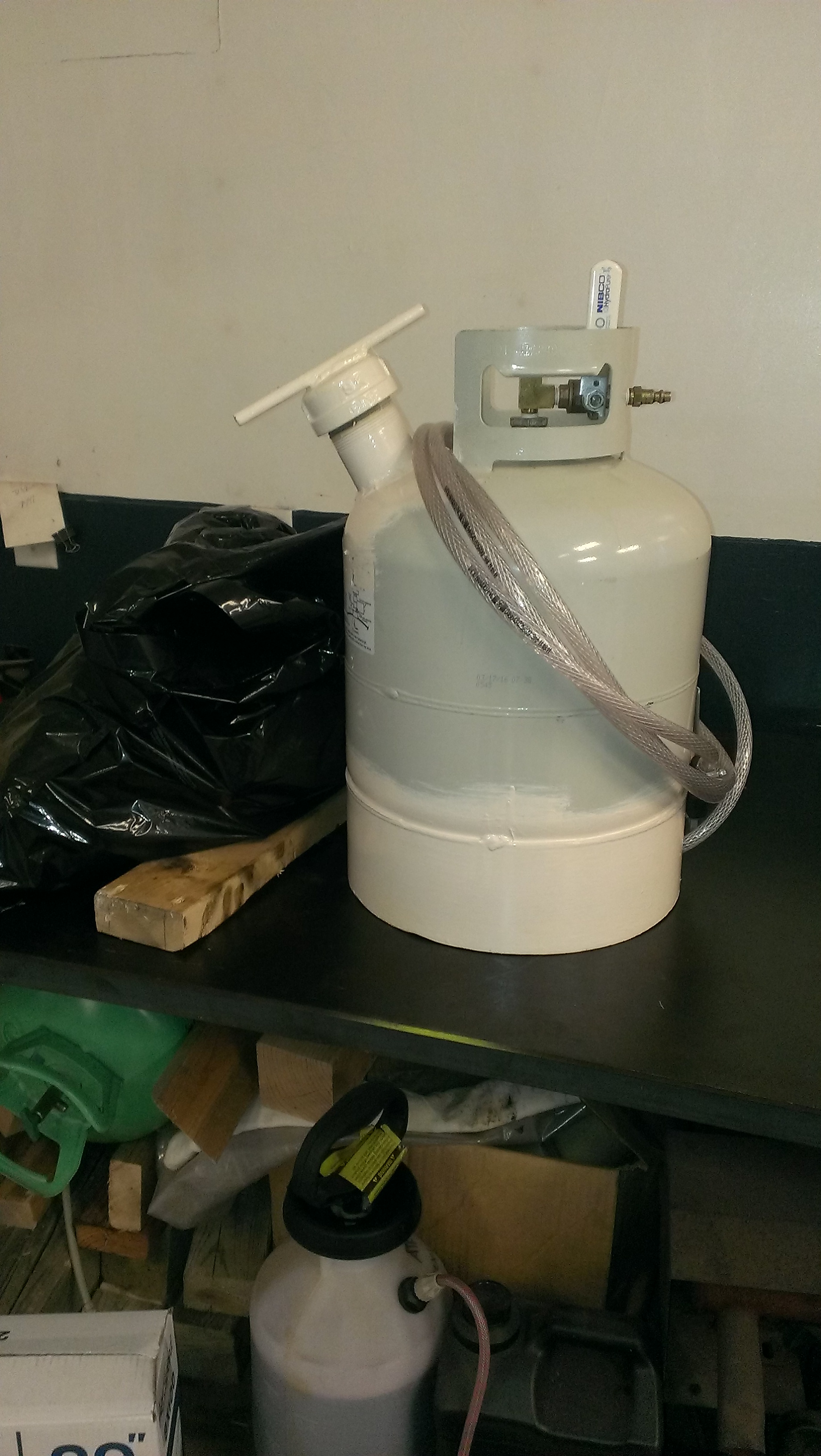

Something like the above to prelube the engine? I believe it would check the rear main before installing the engine. Somewhat anyway.
I built it to prelube the boat engine my sons rebuilt, plan is to put the 5 qts into the tank, run the line to the galley the oil psi sending unit is in and pressurize tank with regulated air PSI to 30.

We planned on leaving the fuel off so we could crank the engine to make sure the oil gets primed. I did hear someone say that the oil pump will not self prime from being empty. Could that be true? I can't find anything to back up that statement in the manual.
It will eventually prime. Helps if the gears have oil on them, better yet, packed with white engine builders lithium grease. Fill the oil filter with oil. I have also used the oil pressure tanks as shown above. Check that engine oil pan is not over filled if using tank. Philip.

A dry oil pump most likely will NOT prime unless it is below the oil level.
Best, quickest way is to remove the oil filter and use a shop vacuum on the adapter while someone cranks the engine over a few times with the fuel disabled.
It will make a bit of a mess but ensures a fast prime to the pump.
