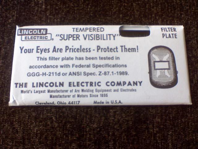

Yomax - Not sure what you are saying there...I wasn't implying Z87.1 wasn't applicable, as it is - but for impact protection, not for welding arc protection. Z87.1 eyewear is required for use when welding for impact protection by OSHA standards. But Z87 says nothing about welding arcs to my knowledge.
Check out the Thermadyne Hoods, EN379 Specification for Welding Filters with Switchable Luminous Transmittance.
Yomax, I'm really not sure what you are getting at. It is hard to find EN standards without paying for them, and searching on your topic didn't tell me much other than EN379 is the standard for auto darkening welding lenses in the Europe. I don't know if there is one in the US, though I suspect there must be.
Miller notes the ANSI impact standard here:
Miller - Selecting the Right Welding Helmet For You
And Wikipedia:
Welding helmet - Wikipedia, the free encyclopedia
