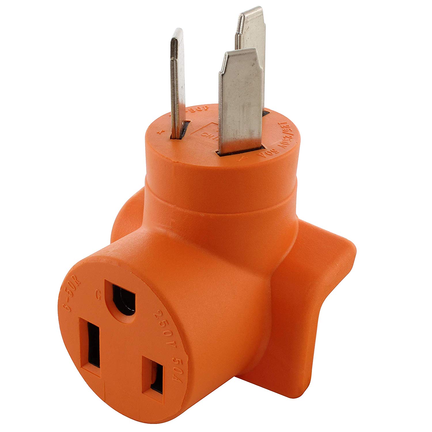

I decided on the Hobart 210MVP. Now I have to figure out my best plan to adapt my shop's 50A welder circuit, which currently has a 10-50 receptacle, to something that supports the Hobart's 6-50 plug but also the 10--50 of my Lincoln AC-225. Changing the receptacle to 6-50R and using some type of adapter for my Lincoln seems like the right path.

Your choices would be make a pigtail adapter for the new welder OR preferably upgrade your wall receptacle to 6-50 to accommodate your new welder and replace the plug on your Lincoln with a new 6-50 plug.
Shopping list: 6-50 wall receptacle and 6-50 plug.
This way you will be ready to go when you buy your NEXT welder.

I'm pretty sure it will be best to swap the receptacle to 6-50 because the Hobart will likely be used far more than the Lincoln. I could definitely replace the plug on the Lincoln but I'm leaning towards an adapter/pigtail instead. I just like to keep stuff original.

Rob, I got this guy to use 6-50 plugs in my 10-50 outlets. https://www.amazon.com/gp/product/B07R3FP8G9/ref=ppx_yo_dt_b_asin_title_o05_s01?ie=UTF8&psc=1
All our outlets are 10-50 and fused/wired for full loads. This keeps things simple, and rather than buy a 25' 6-50 extension cord and put the adapter at the wall I bought a 20' 10-50 cord (6Ga) and can use the 6-50 adapter at the end of that.

Thanks. I found that one in my searching last night too. Expensive little buggers though! Looks like $50-70 for any solution I come up with besides cutting the AC-225 cord and swapping plugs.
