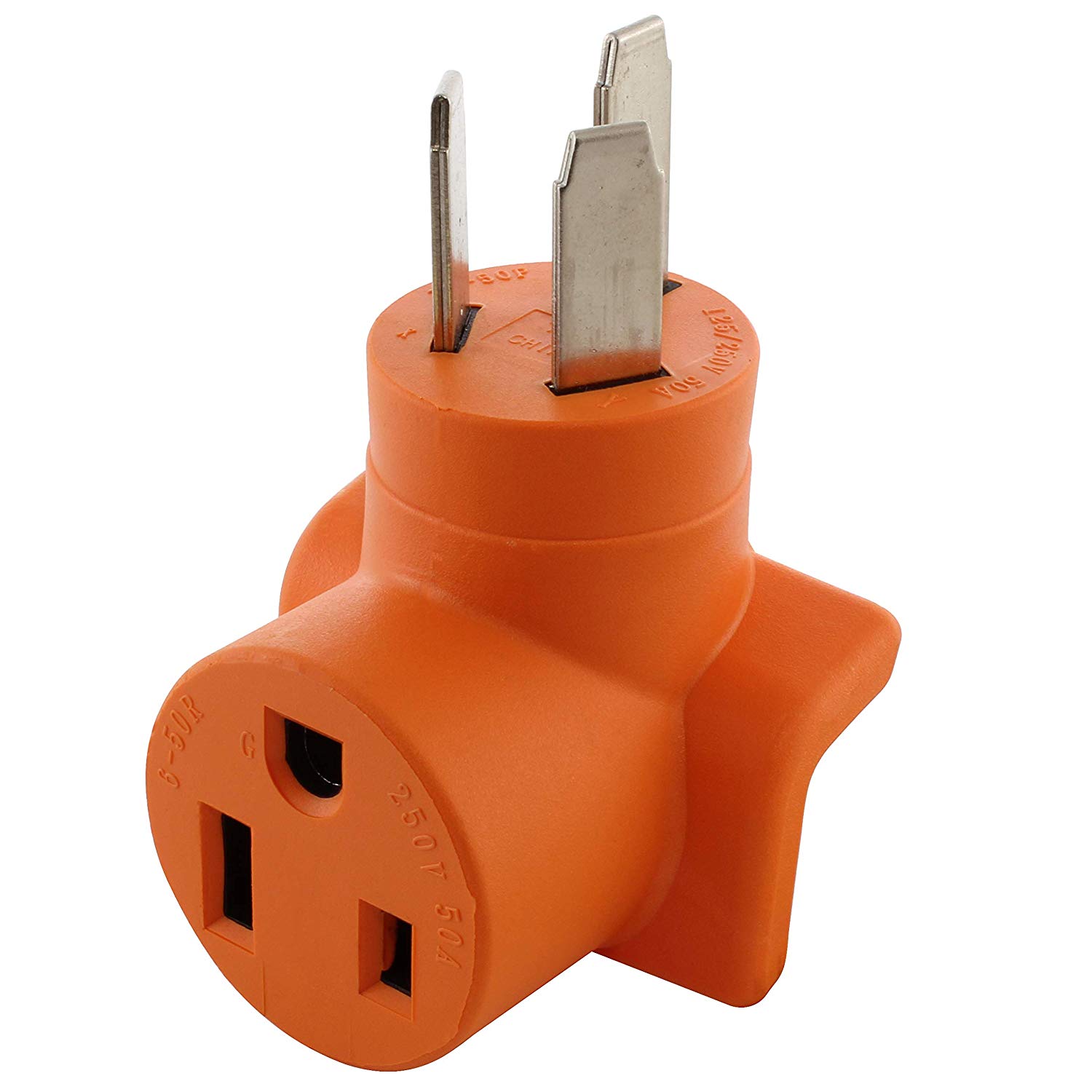

Rob, I got this guy to use 6-50 plugs in my 10-50 outlets. https://www.amazon.com/gp/product/B07R3FP8G9/ref=ppx_yo_dt_b_asin_title_o05_s01?ie=UTF8&psc=1
All our outlets are 10-50 and fused/wired for full loads. This keeps things simple, and rather than buy a 25' 6-50 extension cord and put the adapter at the wall I bought a 20' 10-50 cord (6Ga) and can use the 6-50 adapter at the end of that.

I wired all my outlets & extension cords as NEMA 14-50. 110 or 220 & the common plug on generators. I made my own adapters to go from the 14-50 male to the appropriate socket for my welders or plasma. Not the cheapest option, but the most flexible. I'll have the right extension cable & adapter if I ever go mobile. Easy to back feed my shop with a suicide cable during a power outage too (although I have a proper generator disconnect & inlet).

I just replaced the receptacle with 6-50R so the Hobart is a direct plug-in. Also bought a 6-50P plug end for the Lincoln welder. Not my ideal solution to cut off the original plug on the Lincoln but it seems like the right choice.
