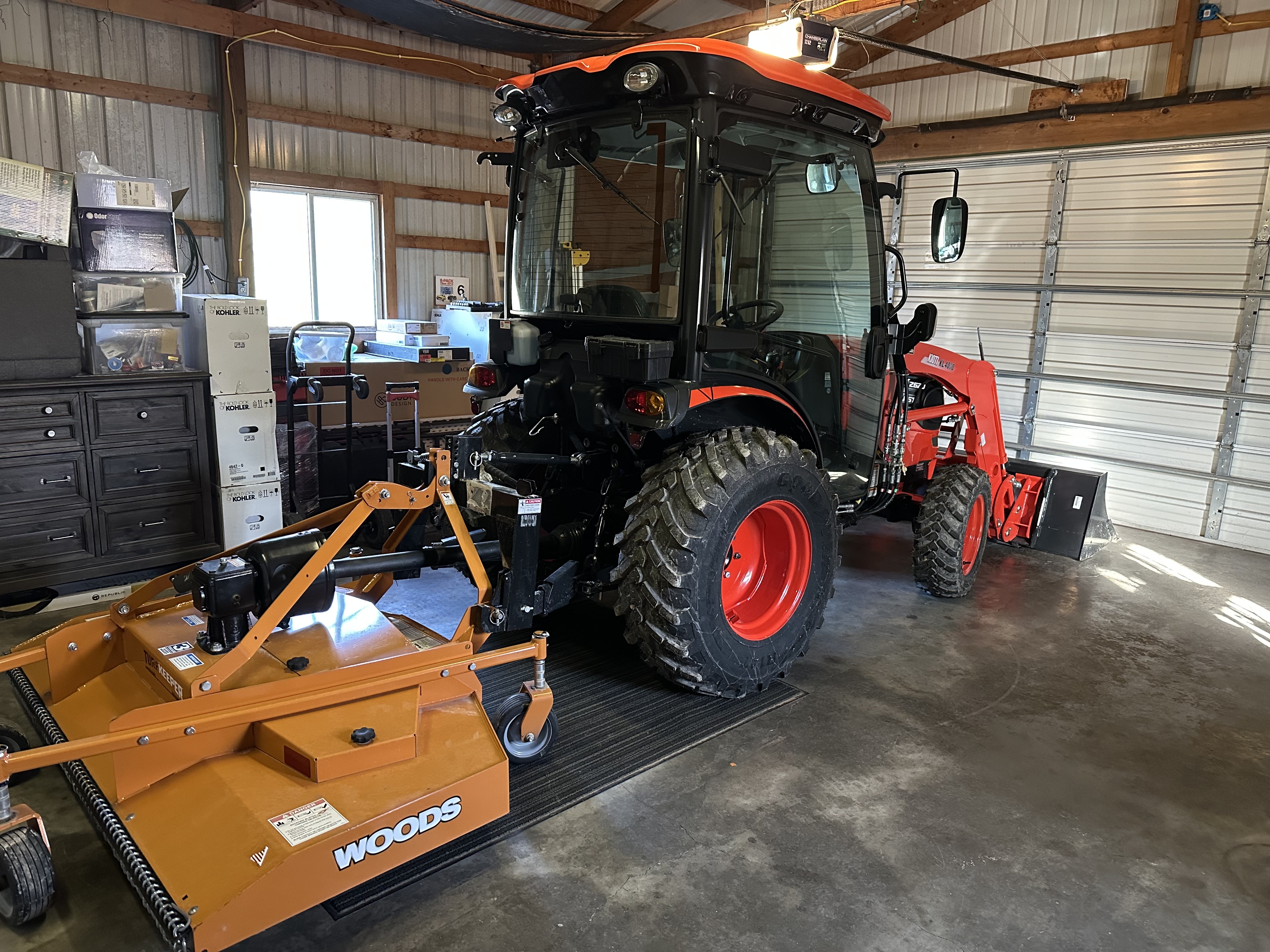

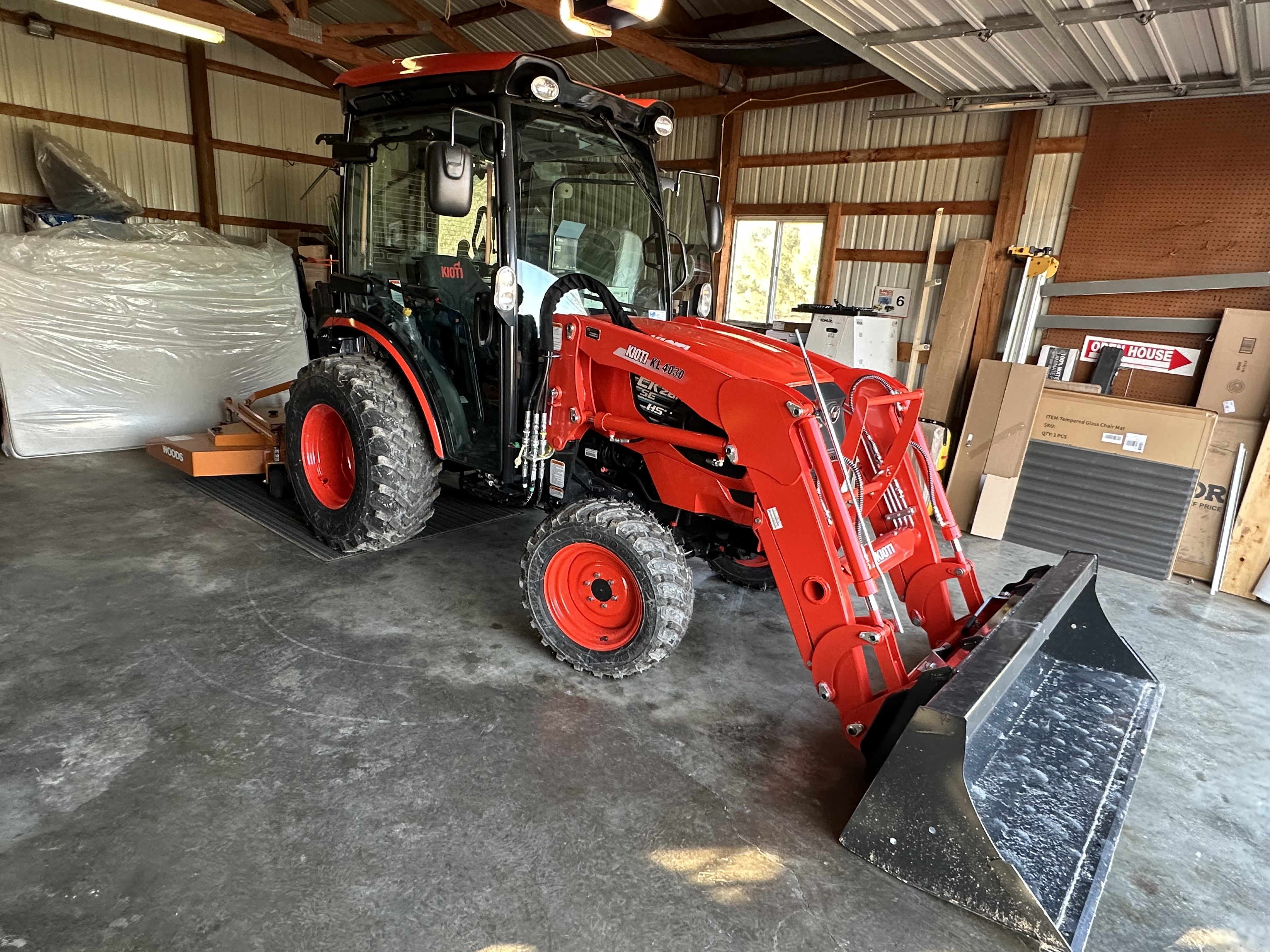

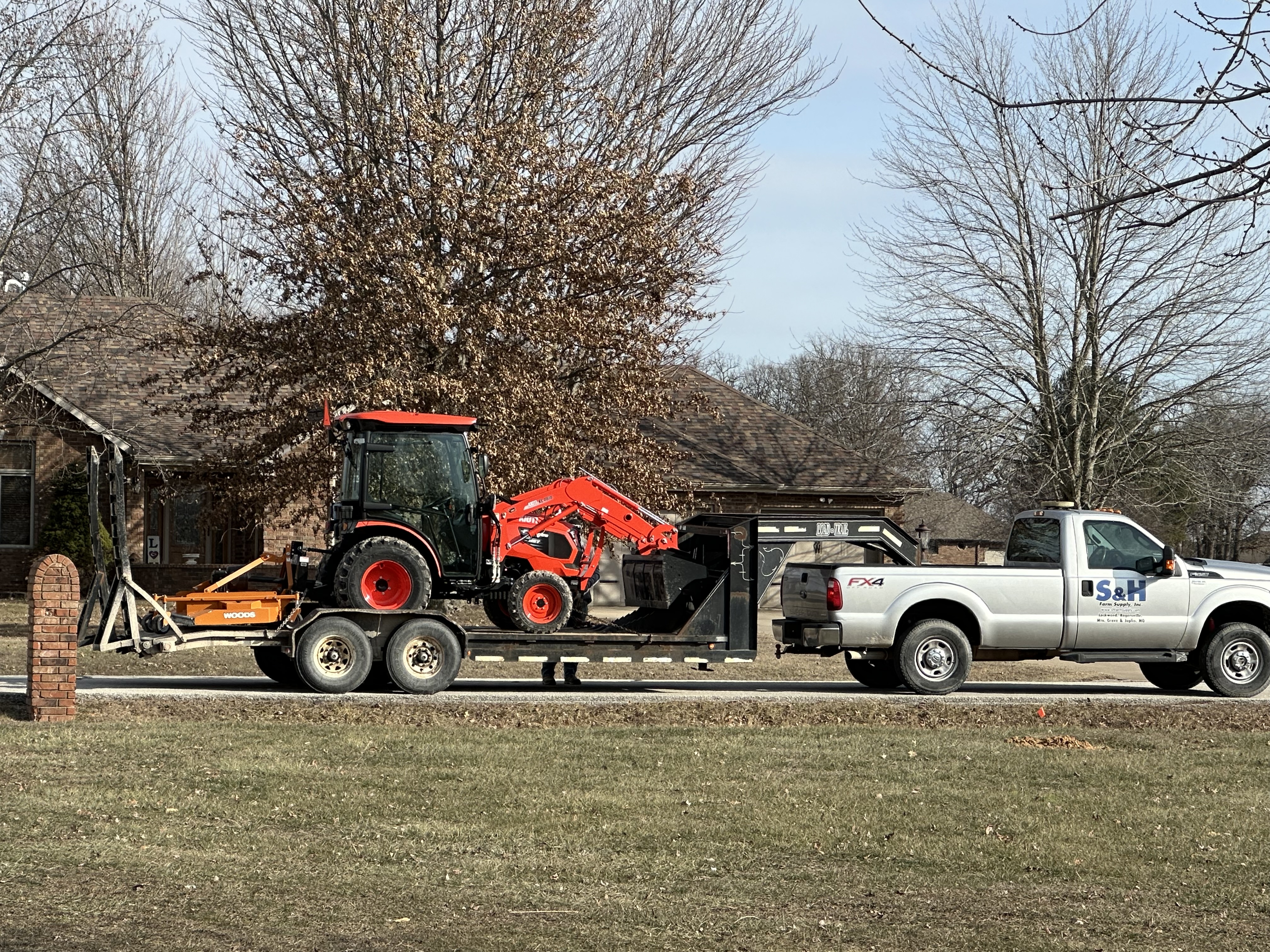

My new toy arrived today. I ordered it with a forklift attachment and a stump bucket. Working on installing a new stereo and subwoofer. Heat works amazing in the 11º cold!

Thank you! I've already removed the roof to get some wiring in for a subwoofer. yeah, I know, its a tractor... I still enjoy a good sounding music while I work. I'm not one to put earbuds in or use headphones. Just my odd personality regarding things in my ears. So far it's coming out nice and factory like. Ran out of supplies and wife wanted to go out for lunch so my day got cut short :)
