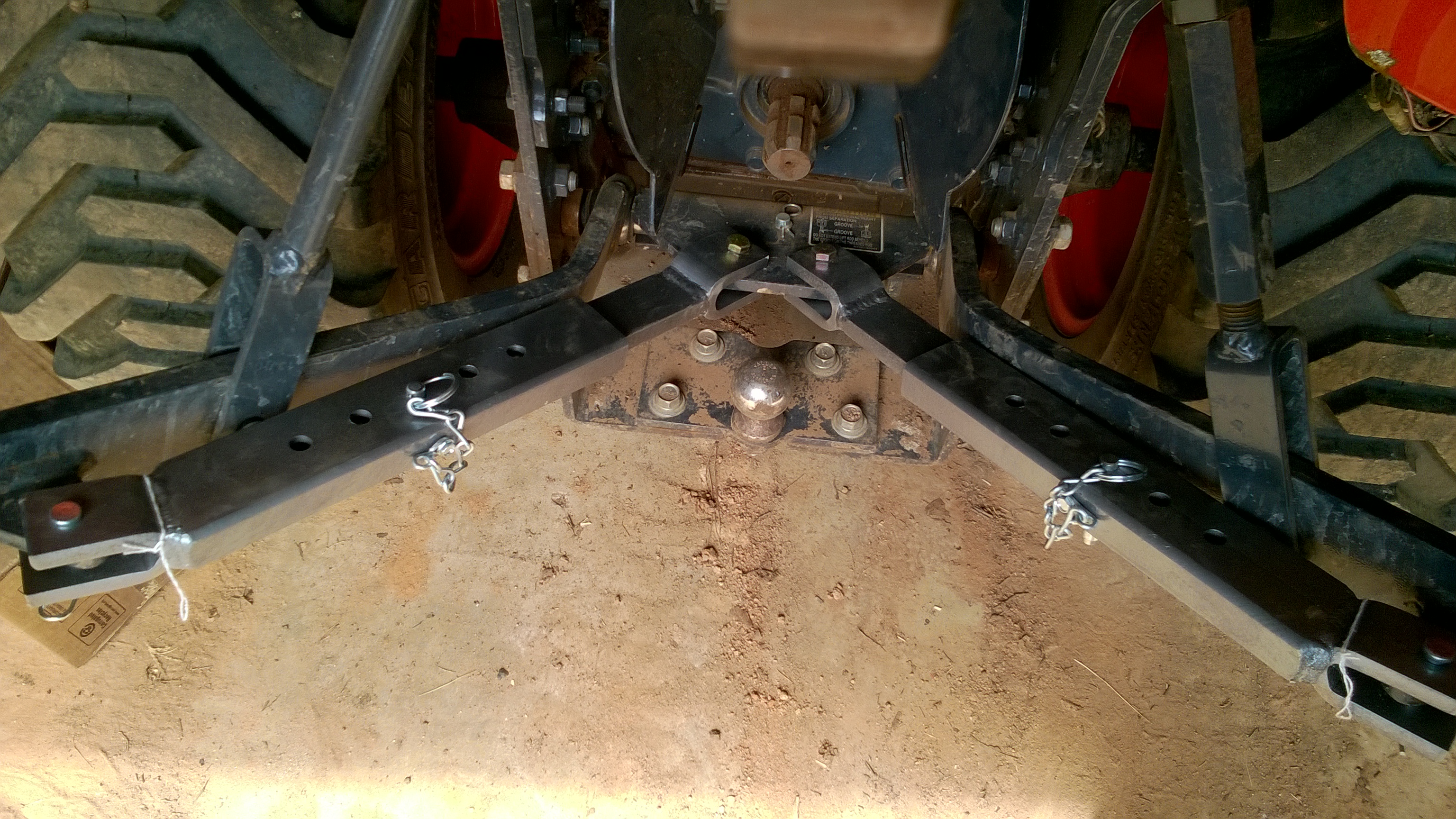

I have a quick hitch for mine and like the ease of switching implements around. I had the Pat's easy change on my last tractor and liked it as well. I like the quick hitch better and the LP on is about $170 if I remember right.
Also, Triple R mentioned the Mike Hodge kit for the extendable stabilizers. I got this too after breaking and replacing turnbuckles. That is my one complaint with this tractor. Don't know if the 80 has a better setup than the 70, but on the 70, that is the weak point of the tractor. The welds would break and then the U bolts would bend pretty easily when doing box blade work.
I haven't had a single issue since adding these beefy items:

View attachment 506622View attachment 506622
Those look really nice, I'll pick up a pair after I get my tractor. Thanks for the advice.

The Mike Hodge kit was about the same price IIRC and so worth it.
