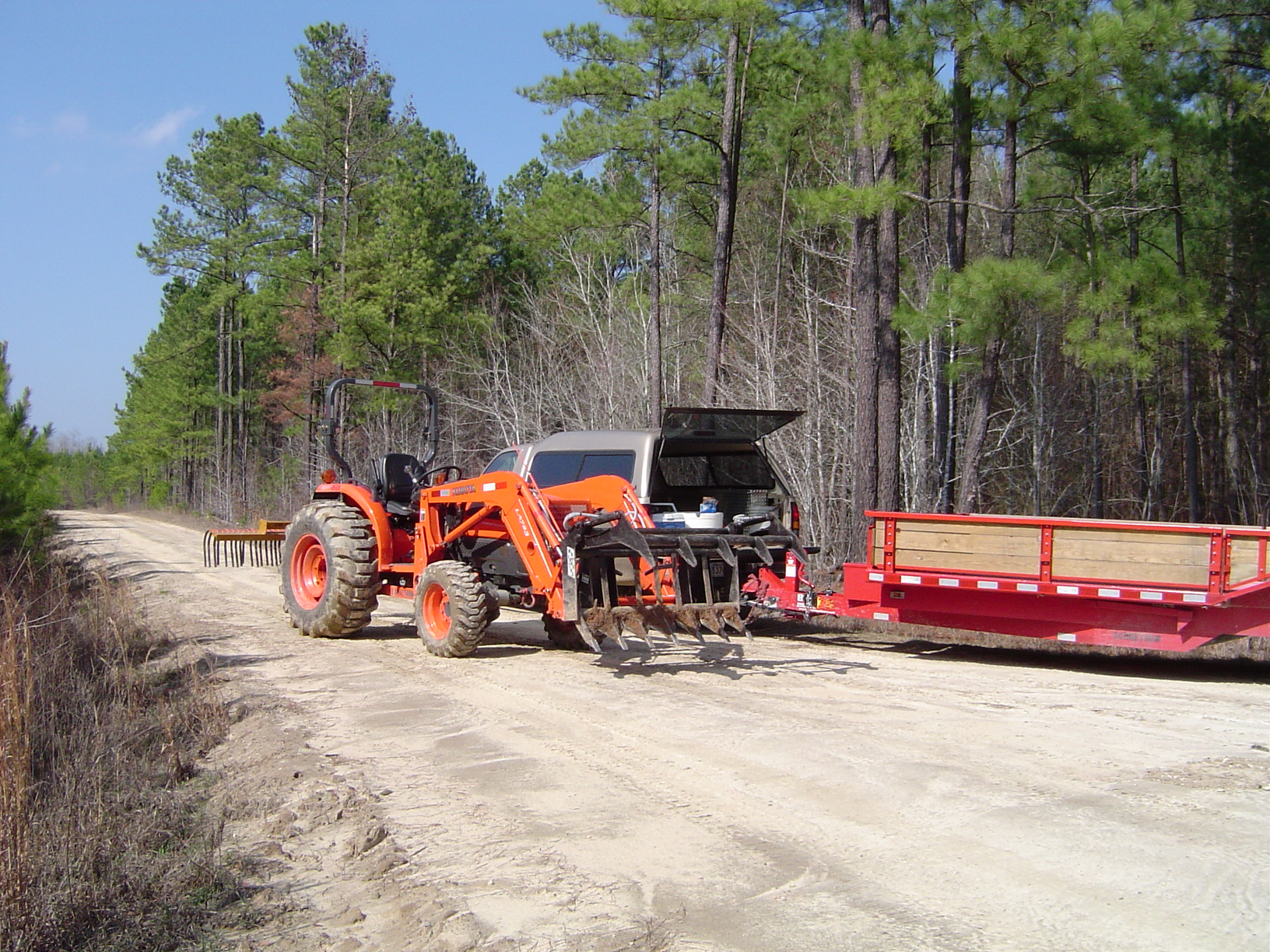

I have a root rake type with single lid made by WR Long. I really like it. I also welded up a brush guard which is needed when using a grapple. Make sure your grapple is as wide as your front tire width. That way you are not driving over debris when pushing up a load.
