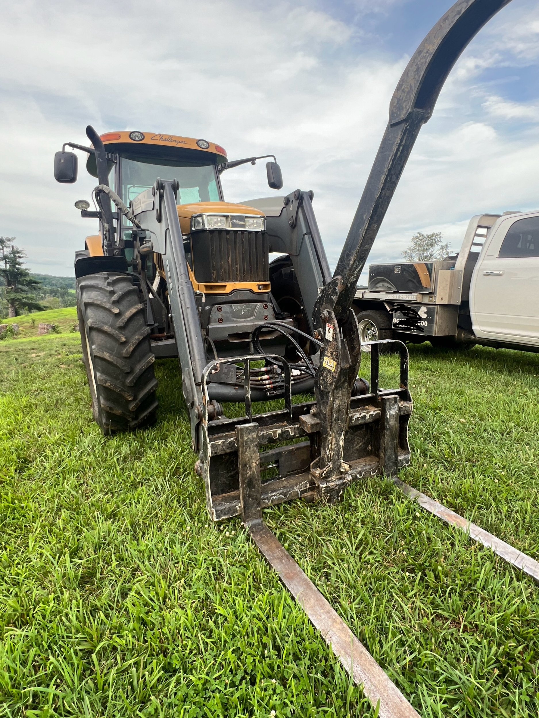

Most of the time I want the grapple for hauling logs, wood and brush. I am tempted to add a thumb onto my forks for the logs. I never feel like I get a full load when handling brush on my current setup.

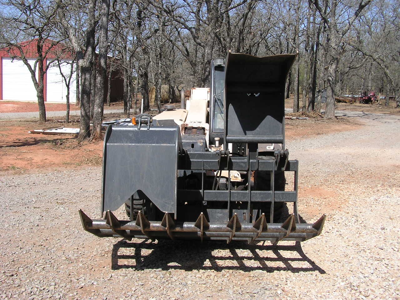

I have a root rake type with single lid made by WR Long. I really like it. I also welded up a brush guard which is needed when using a grapple. Make sure your grapple is as wide as your front tire width. That way you are not driving over debris when pushing up a load.
