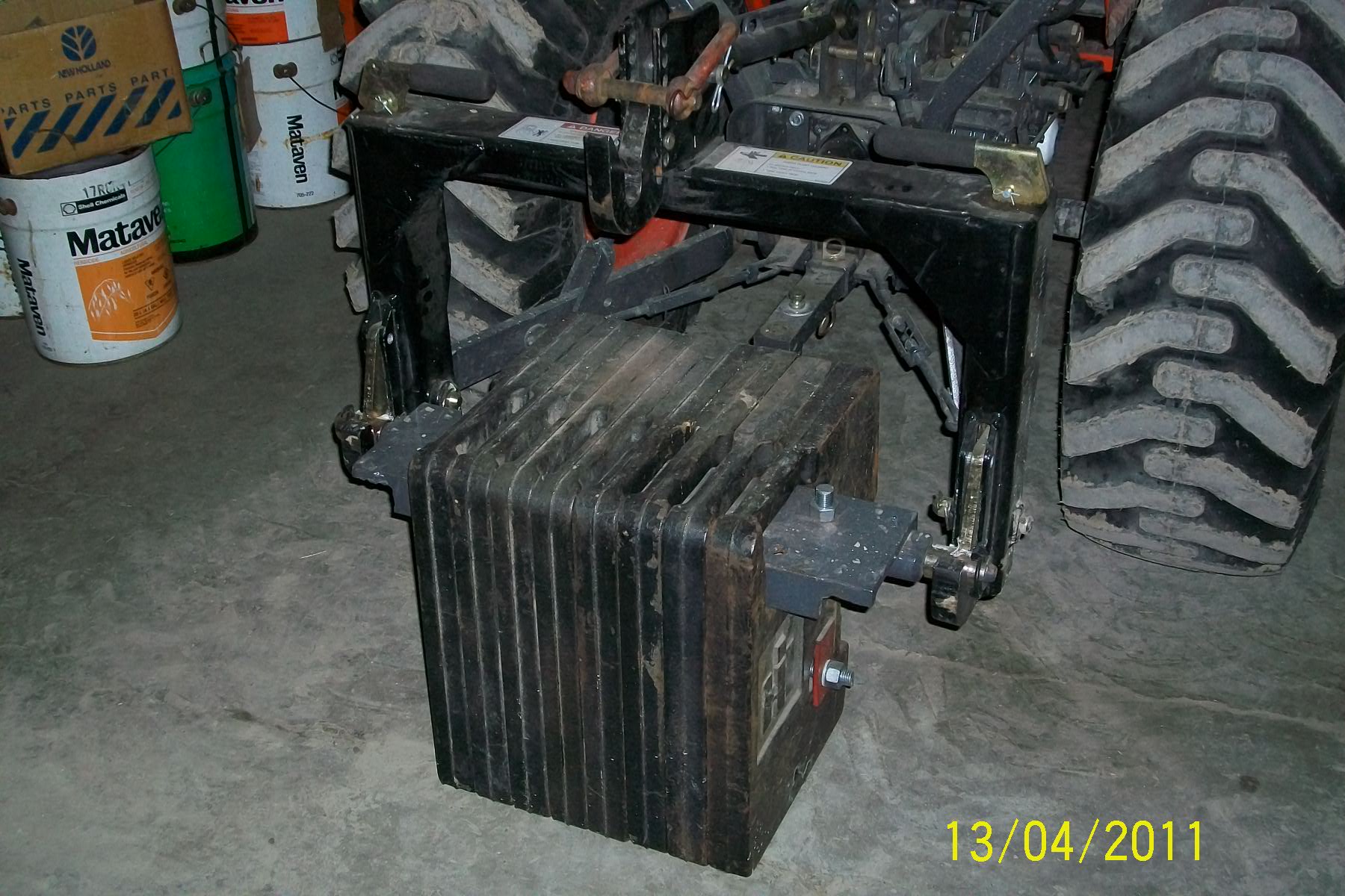

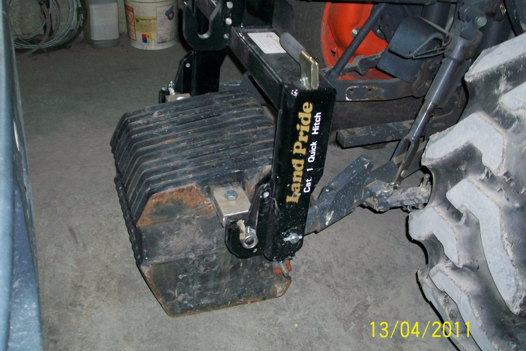

Here are a few pics of what I did for ballast. The IH weights are on my B3200 and the other is my L3130. They work great because of the QH I can come away from the weight in seconds and hook back up in seconds.
They are front suitcase weights for farm tractors and the one pack weighs about 1300# and the other about 1000#.:thumbsup:
