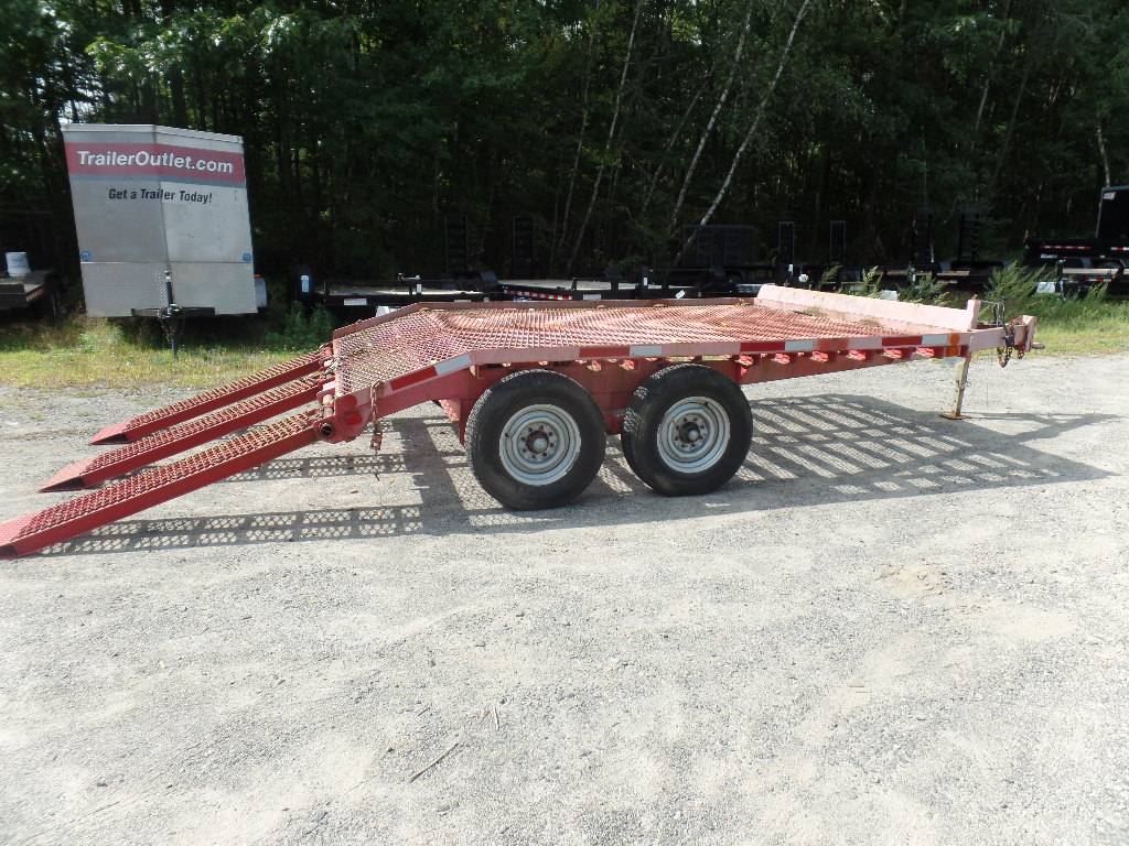

Anyone running a bumper pull 12-14k full 8 wide deck over trailer and loading a zero turn without difficulty? I hear zero turns get stuck on the hump ? A dovetail would help. I have a small low profile 3500lb trailer for my zero turn, but its not useful for much else.
What I REALLY want is a deck over trailer with a wide mesh reinforced, spring assist ramp that can be used for:
1. Zero turn mower is the primary week in week out use.
2. Side by side round bales (hence the need for 8 wide deck over) in a 4-6 on bottom, 2-4 on top configuration is secondary use.
3. Occasional skid steer or Toolcat.
Want to get away with a short as possible so I think 16 is the best length. I think 12k is minimum GVWR.
As some of read in a previous thread, I found this trailer. Its cheap, heavy duty and the right size, maybe a tad short, but needs ramp modifications.
Any suggestions appreciated.

I'd just get a second trailer, each suitable for their use. Since the zero turn gets most use, a purpose built trailer for it is useful. Small trailers are cheap, so no real need to get rid for it.

Yeah, I have thought of doing that, but the barn & garage is getting awfully full of equipment and my existing small trailer is pretty beat up and in need of replacement anyway, so I thought I would do a SAK (Swiss army knife) trailer.

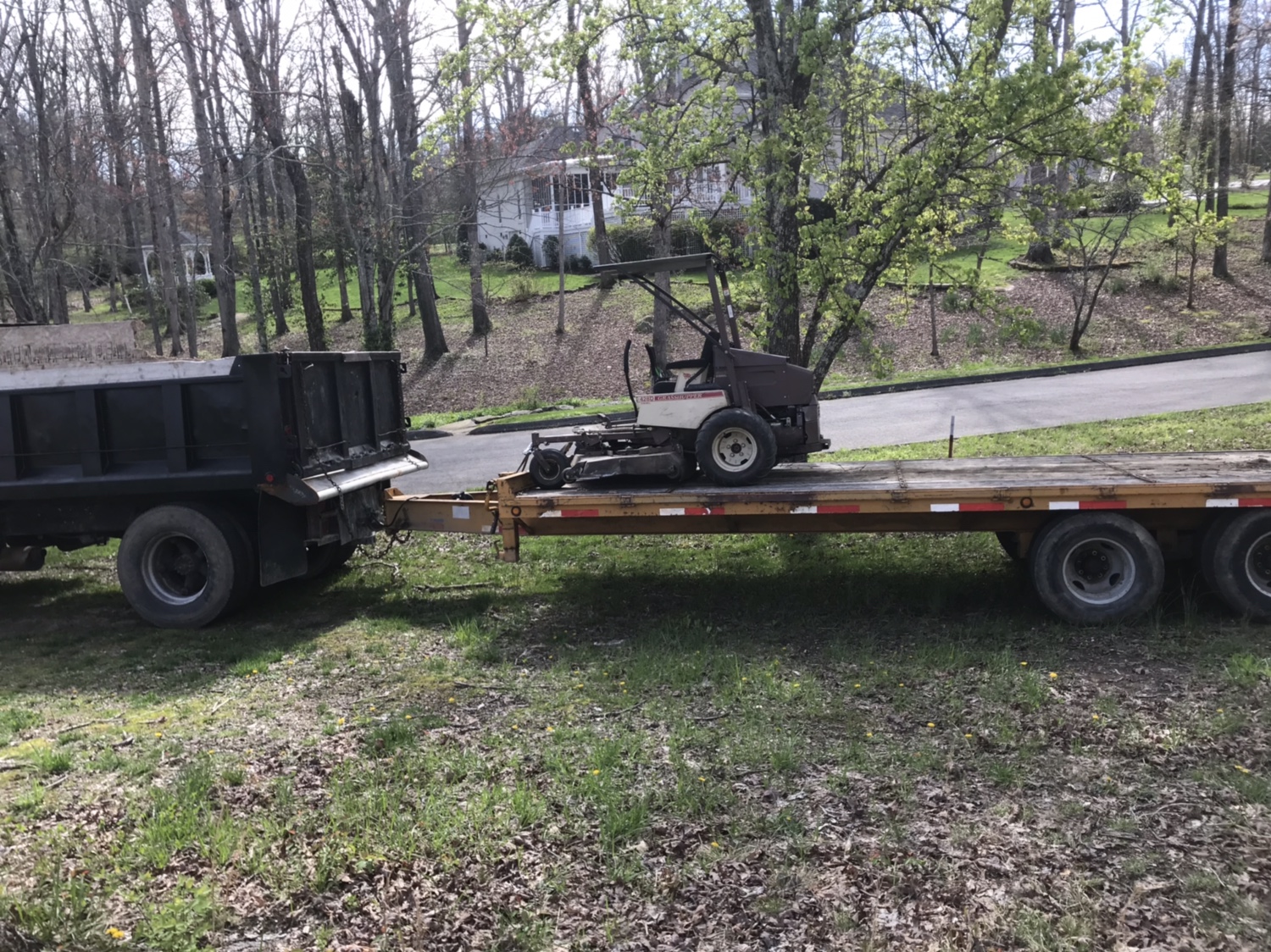

I’ve hauled my mower on my deck over 10 ton and it didn’t drag. It’s probably not as steep as yours but my trailer is pretty steep. That being said I much prefer hauling the mower on my car hauler trailer. IMG_8518.JPG
