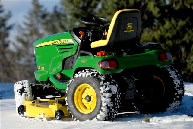

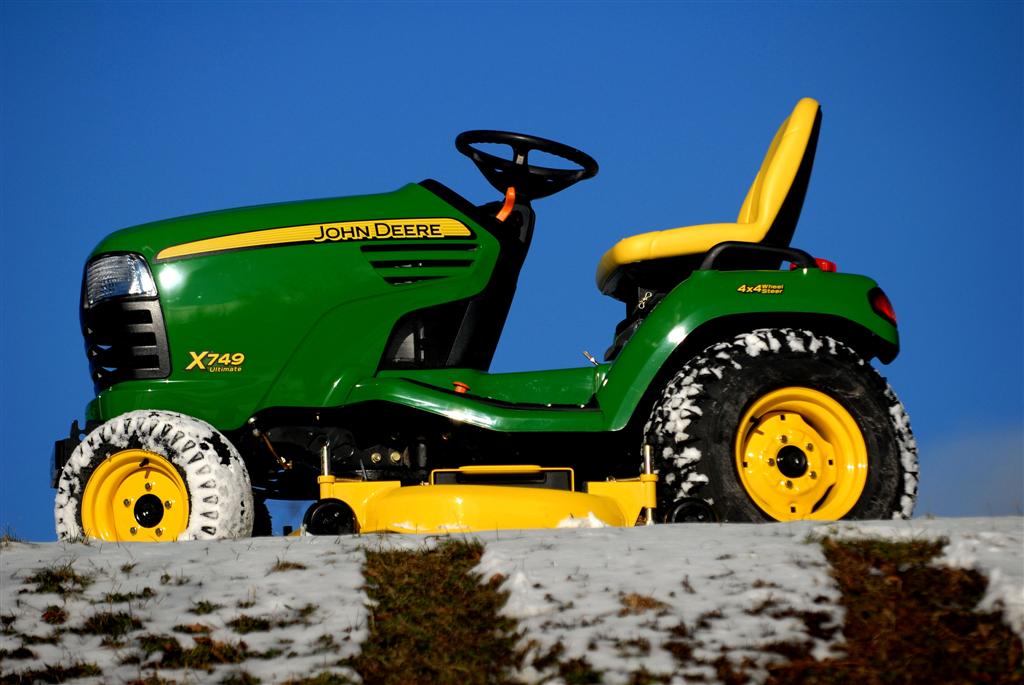

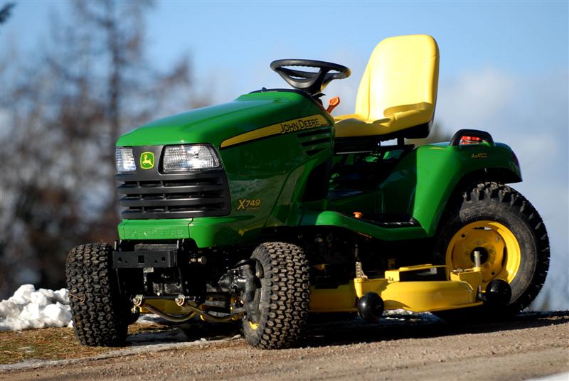

It was a nice day today, so I got it washed up for more photos. The snow melted some and this time it went up that hill without the diff lock.

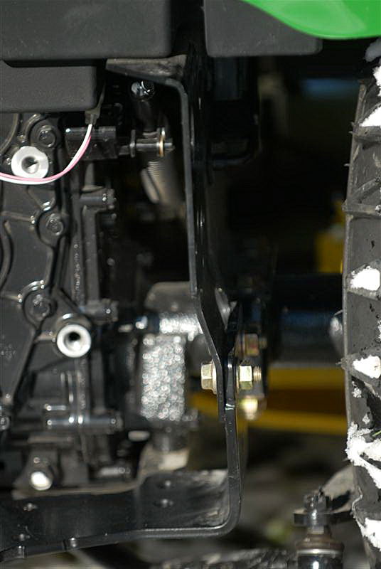

To me, the frame seems a bit thin. Granted, there are areas where it is doubled up and re-inforced, but not the entire length. I am wondering how this compares to the previous X595, or 455 frames. Anyone care to measure theirs? Mine measures 0.184" including finish where this hitch (measuring 0.312") attaches.

My X595 measures about .190 (maybe the paint jobs were a little thicker back in the day!). I would have sworn it was thicker, but I usually have a tractor trunk on, so I guess I never noticed. I've never had any problems, but I am just about to add a rear PTO and 3 point hitch for a box blade and rotary cutter, so I guess I'll find out if it is thick enough...
   / Deere new models #95
I guess that makes them at least a 7 gauge steel frame or better. Not bad for a mower. Seems to be a big difference from the 2520 though.
   / Deere new models #96
The X700 series is basically a big riding lawn mower and as such I imagine they want them to be fairly light.

The frames are not as think as the frames on the tractors we use, but the key here is the frame design. The X series tractors use essentially a unit body design frame which has several designed reinforcement points. It is plehty strong. In my opinion, it likely is as strong, if not stronger, than a 2305 frame.
