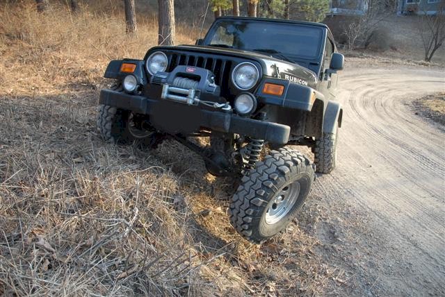

LBrown59 said:
:D You should have called me to pull it on up the slope for you with my bx1500.:) LOL
Sorry I couldn't resist funnin ya a little.
Thanks anyway, I already have the resources to pull stuff up. Now, if I can just mod it to flex like this, or perhaps I should just mod this to accept a mower deck :D
