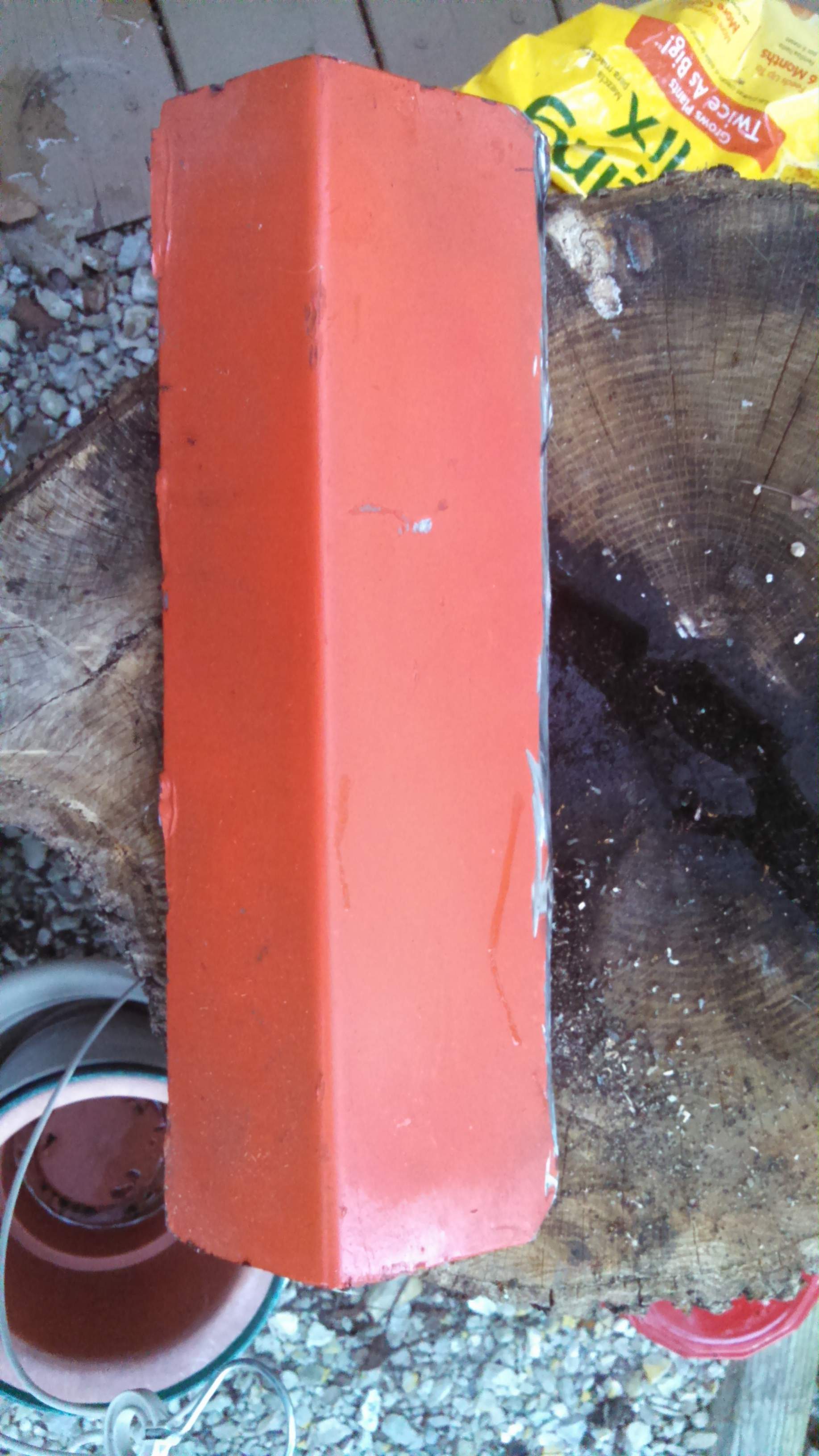

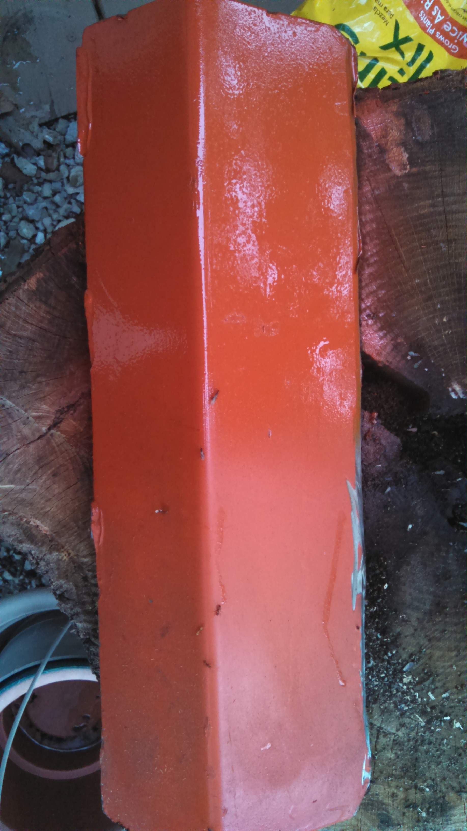

Take a look at this. This is a piece of metal off of a 2010 Kubota L3400hst so it is Kubota II also known as "new Kubota orange". First photo is the original painted metal.. It is dirty, so take that into account.
The second photo is one half freshly sprayed with the Rustoleum Lobster Red paint bought today from Wally World. .. still wet. It looks like a really good match to me, about as good as I have seen. It looks better in person than this photo!

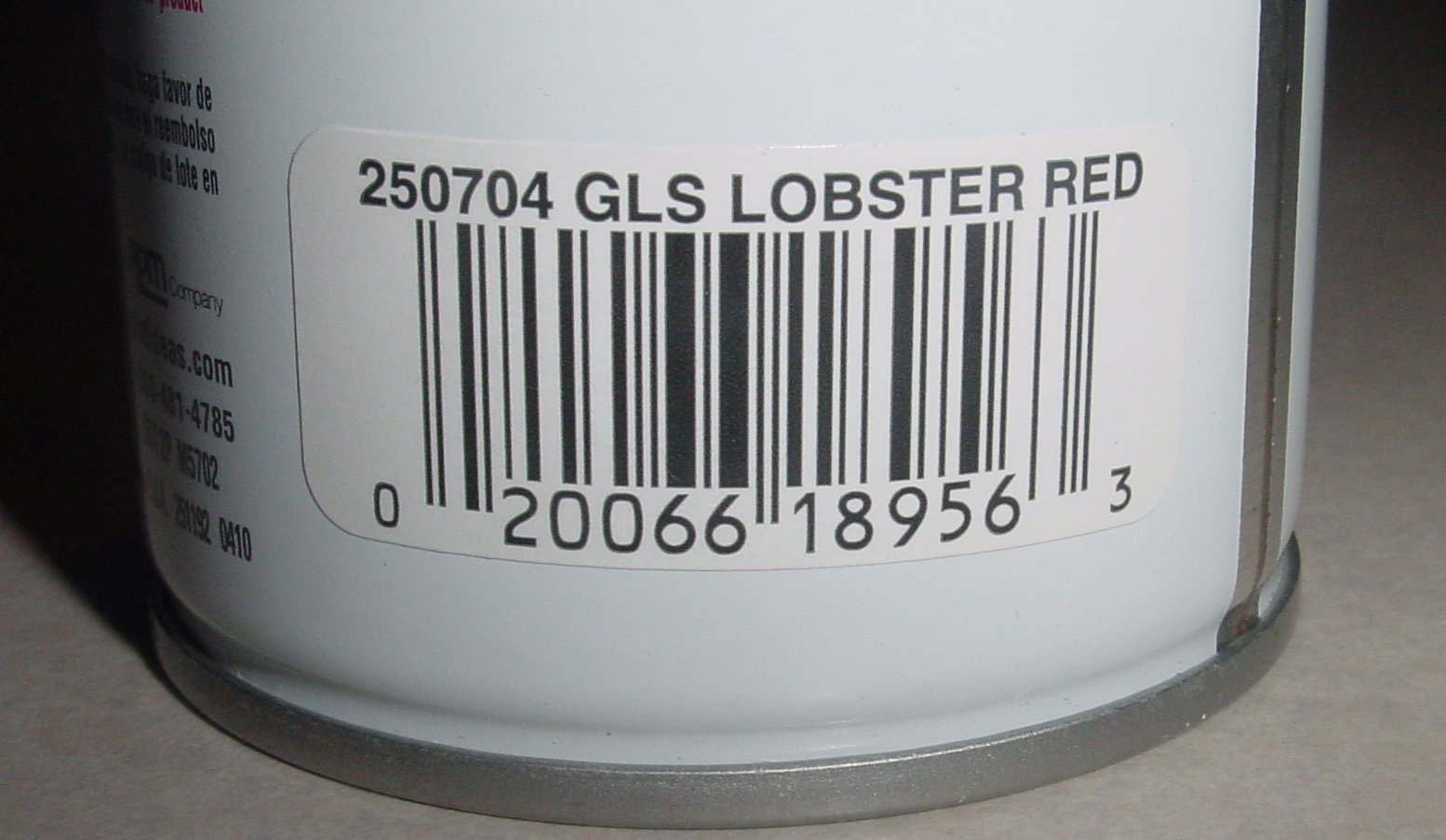

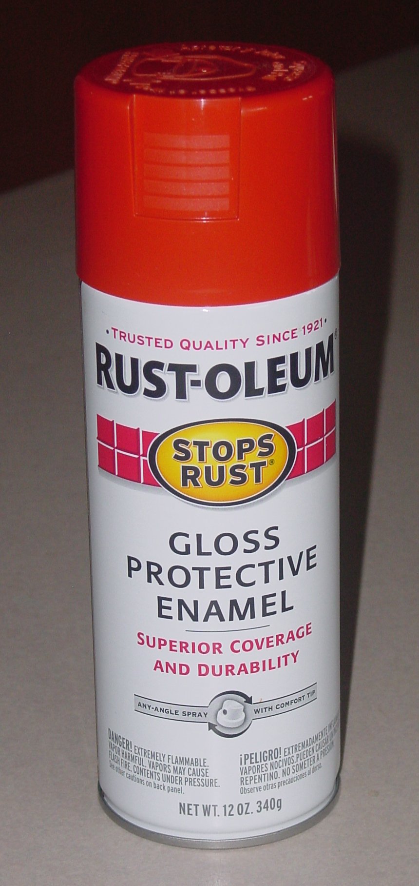

FYI: I found the PERFECT budget Kubota Orange paint.......
Great tip Jay - thanks. I'm doing a blast-prime-paint on parts of my L3250 - this is the right stuff at the right time - perfect. We have a Home Depot closer than a Walmart and they sell it too - online, shipped to the store in a six-pack same price per can.

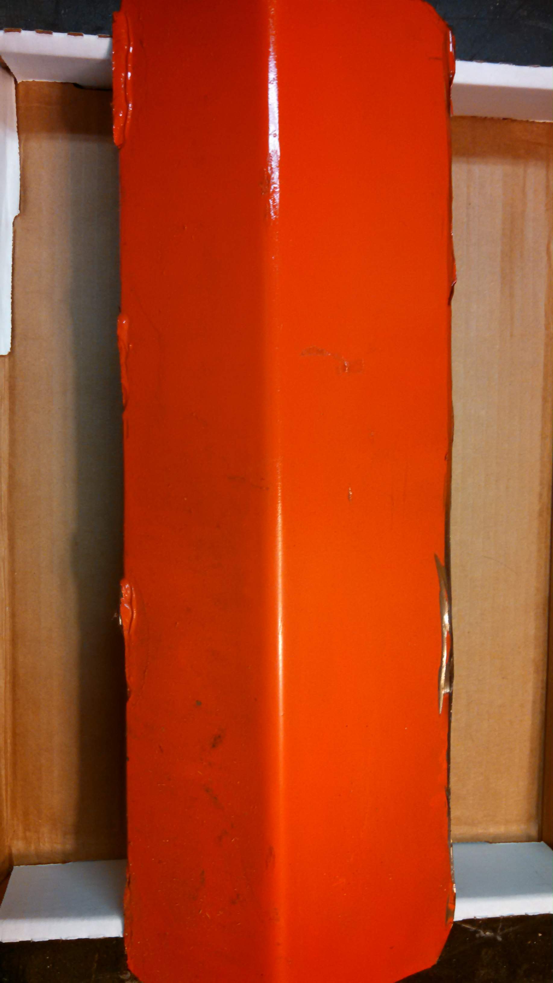

Here is a photo under fluorescent lighting after the paint has dried. As you can see( within the limitations of computer images) a very good match.

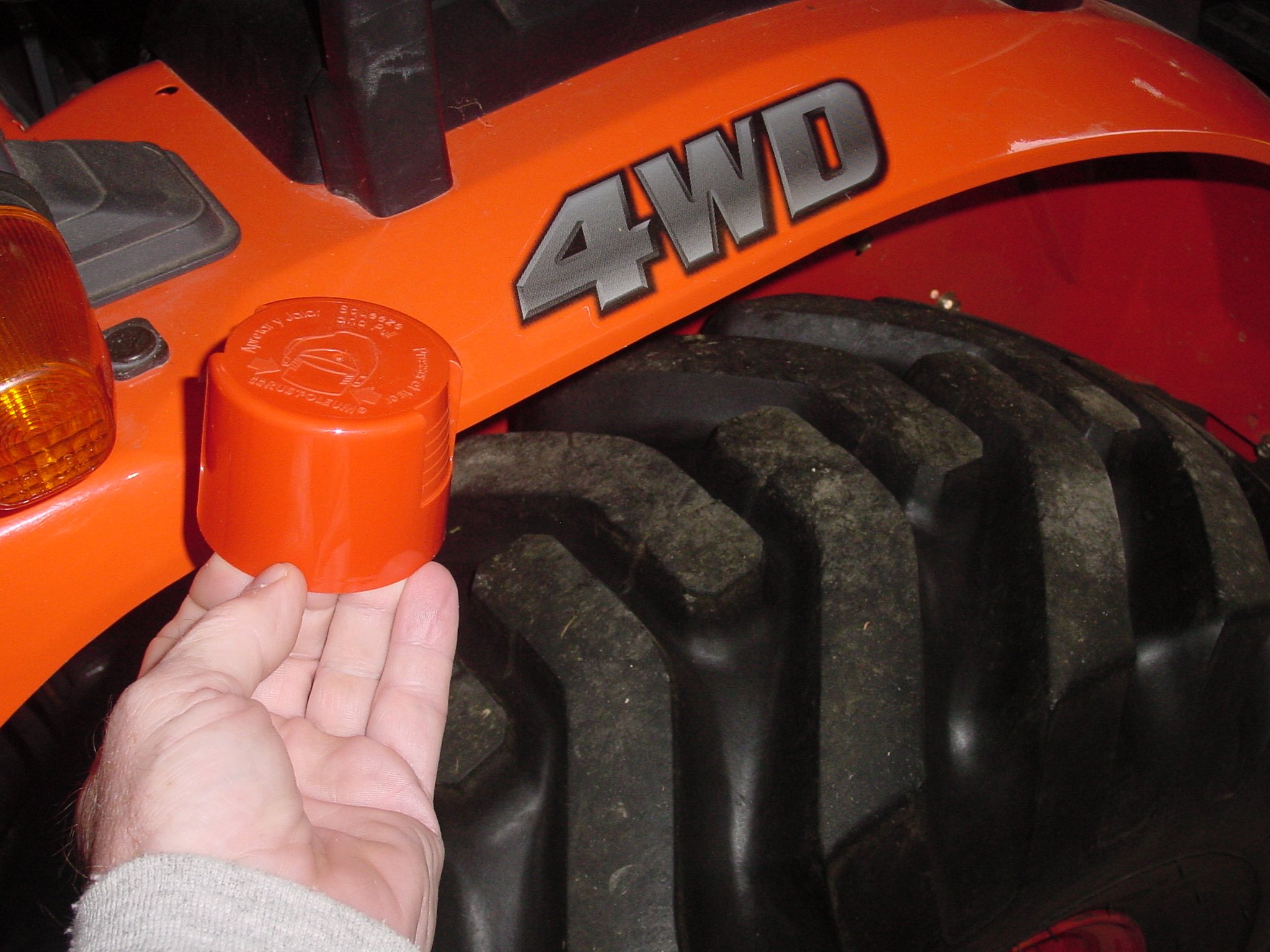

I bought a can yesterday and hope to try it out this weekend.
To my eyes, the color of the plastic cap seems to have a little too much red in it to match my 2007/2008 factory paint.
To those that have already tried this color, if you still have the cap how close is the color of the cap to the finished/dried object that you painted?
