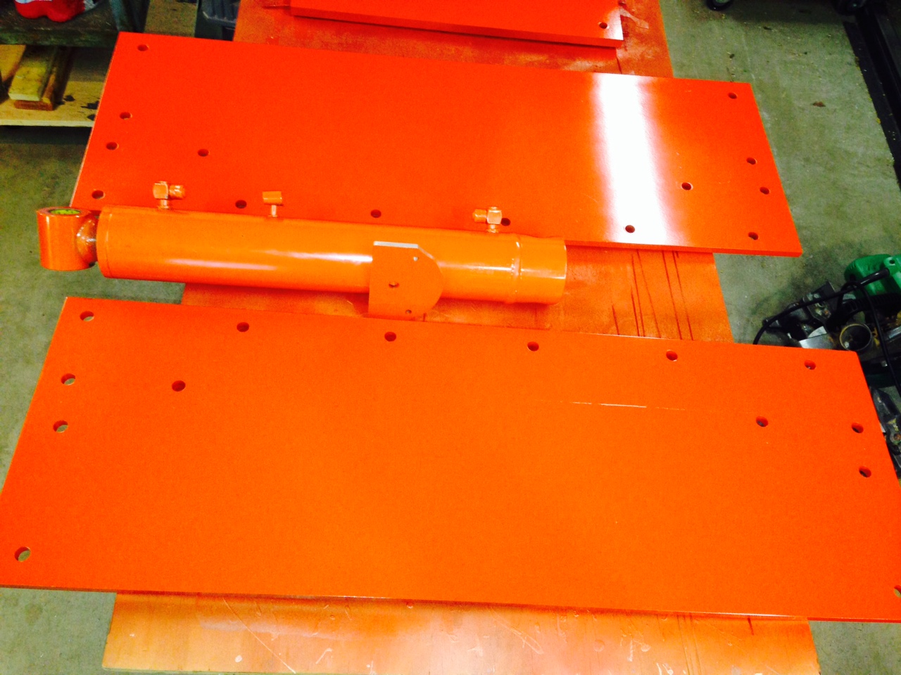

   / Definitive Kubota Orange budget replacement #42
The large plates are Lobster Red. The small curved plate is Kubota Orange II from a new (today) spray can. The cylinder is for a B21 backhoe stabilizer that I got from surplus center. It is shinier and brighter but otherwise identical to those on the 2004 B21. The LR is a nice color but seems to me redder than the comparisons I have available. No point comparing with the faded paint on the tractor.

   / Definitive Kubota Orange budget replacement #43
FYI: I found the PERFECT budget Kubota Orange paint.
Its Rustoleum "Lobster Red" - $3.77/can at Walmart.
It is absolutely identical to the 'new' Kubota orange.
Jay, I've been painting my L3250's loader and body panels using a HVLP sprayer and a gallon of factory New Orange acrylic enamel. It looks good (considering I'm terrible at painting) but the really great thing is if any small areas need painting or touching up (brackets bolt heads, loader pins, clamp bars, valve box, etc etc) the Rustoleum Lobster Red is dead on - it looks lighter when wet, but it dries to a VERY close match. And there's no spray gun cleaning! Great find!
