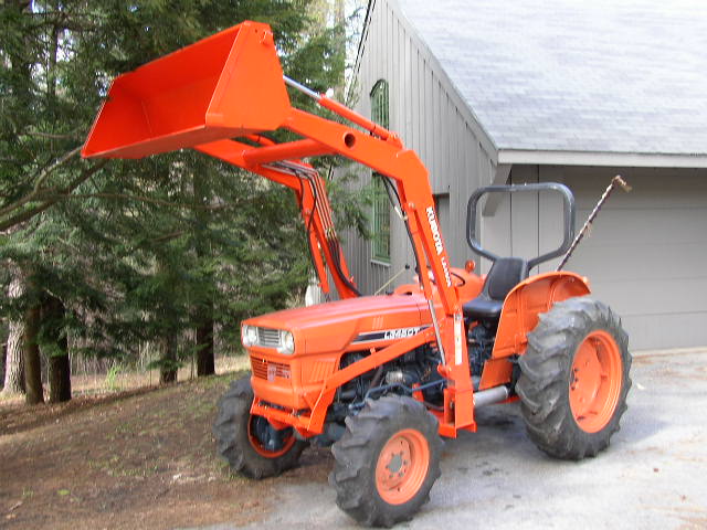

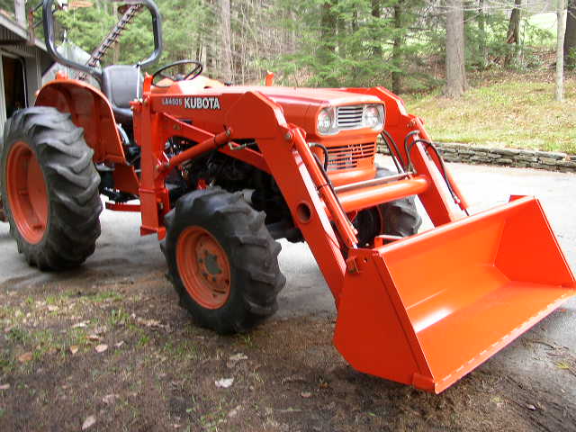

The "new orange" is no longer new - the change was in the mid '90s I think. My L345 and L4150 were the old less-red shade - but the L5450 is the redder "new orange". Color matching is iffy because the "new orange" fades in the sun. Pics below are my old-orange L345 with new-orange loader.
I posted above that Home Depot sells Rustoleum lobster red online for store pickup. But it's slow. After ordering a case, they say the store will have it in 2-3 weeks.

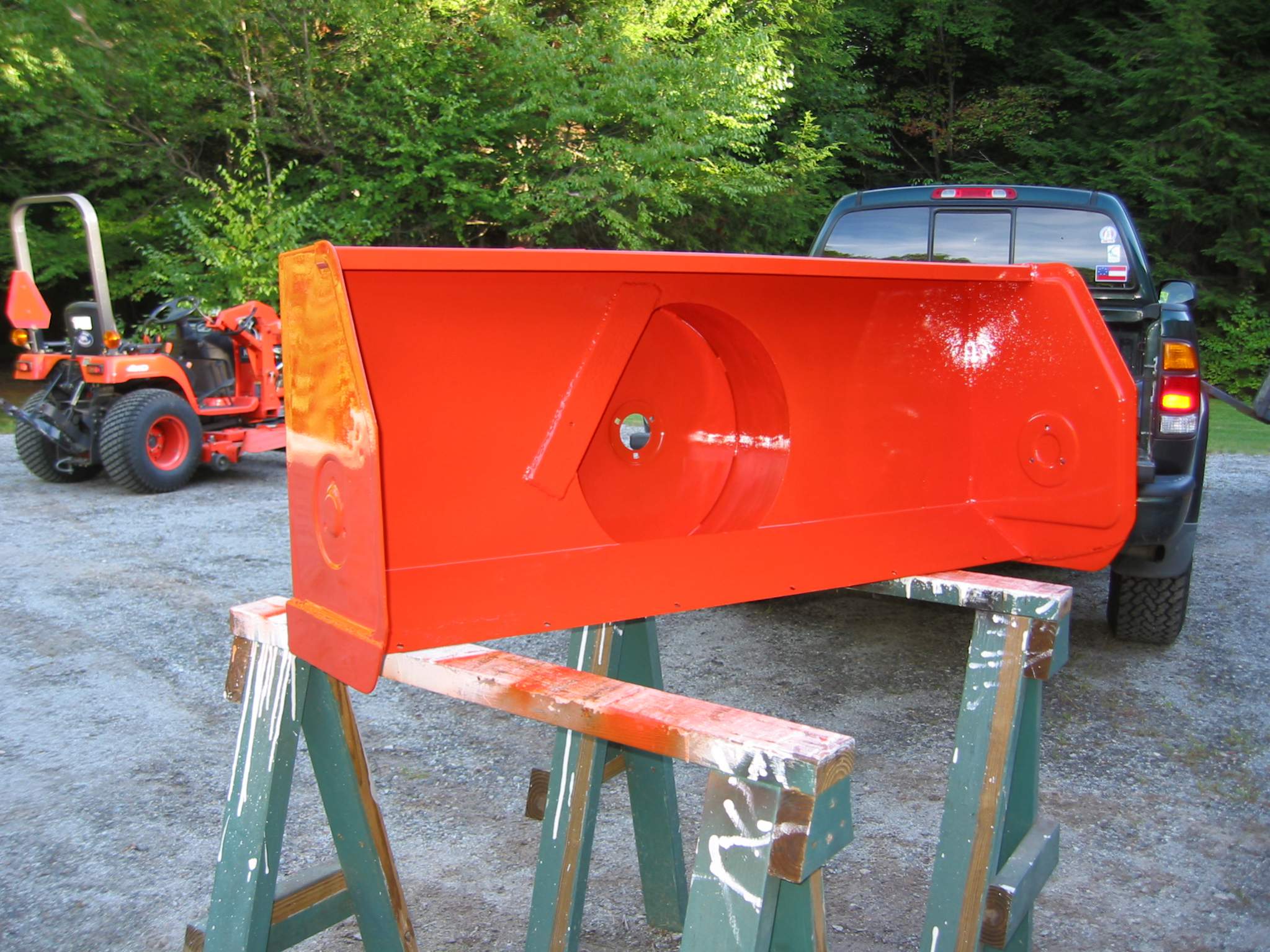

Here's a color comparison for those interested - I painted my snowblower chassis yesterday with the lobbie red - my BX is in the background. It does appear a little more red, but it's pretty subtle. (note the re-engineered side skids and fan blade reinforcement...)

   / Definitive Kubota Orange budget replacement #26
Jay, how old is your BX -- I bet the paint has faded a little. I painted a hydraulic cylinder and cannot tell the difference between this paint and the Kubota orange on my relatively new (~9 months) L3200. It's a darn good match. Does look redder than my box blade though, but I know that paint has faded a bit.
