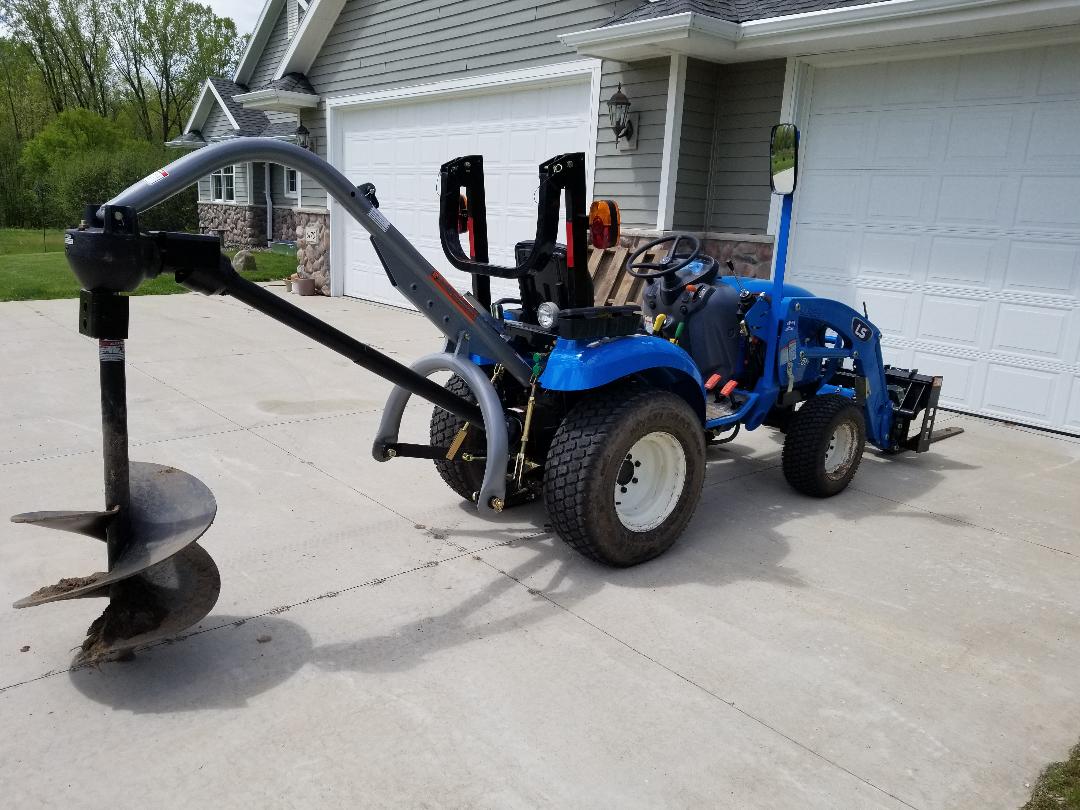

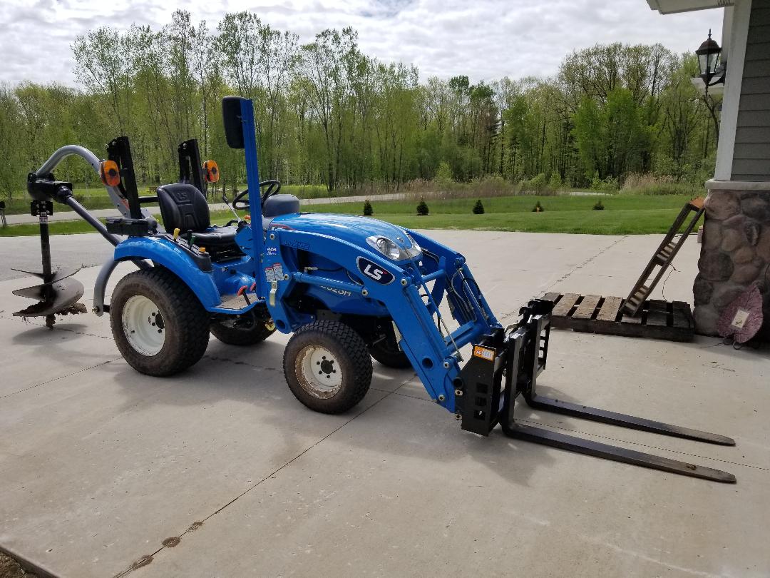

Just planted 8 - 3' to 4' 200# Meier Spruce Trees with the 24" auger.
The forks worked well for removing the trees from the truck and moving them around.
The 24" auger was a perfect size for planting this size of tree.
The very last hole went too deep so I could not raise it out of the hole. I then used a 4,000# hand winch which I attached to the top of the ROPS and was able to quickly raise the auger out of the hole.
A local contractor wanted $250 to plant each tree + the price of the tree. We already paid for our PHD and plan to get more trees.
I put the forks on the ground and lifted up the front while drilling. I ran the engine around 1,500 rpms.

/ Delivered Post Hole Digger Issues #32
Like to see some pictures of what ya got goin? Congrats on makin it work, maybe I underestimated the LS. B
You can see some of the trees in the background.
Yooper Dave

/ Delivered Post Hole Digger Issues #35
Very nicely done and beautiful spot you've got there, thanks for pics. That looks like a nicely built phd, if u don't mind me asking what you have to give for it? Mine is probably 40 yrs old. I looked up Sobieski, your bout straight across the lake from me, I'm near Williamsburg MI. B
I bought the phd and augers on Amazon. It was less expensive by more than $100 than buying from Tractor Supply 40 minutes away - including delivery to my door which worked out well. It came on a pallet and my tractor has forks so we were good to go.
Putting the phd on the tractor was another issue. Several minor modifications were needed to get an acceptable fit.

Great that you got it to work Dave, -looks like reversing the 3 point pins direction in the U frame and mounting up the 3 point arms from inside worked well.
The LS XJ2025 did a great job spinning that 2 foot auger. Impressive and great looking work:thumbsup:
