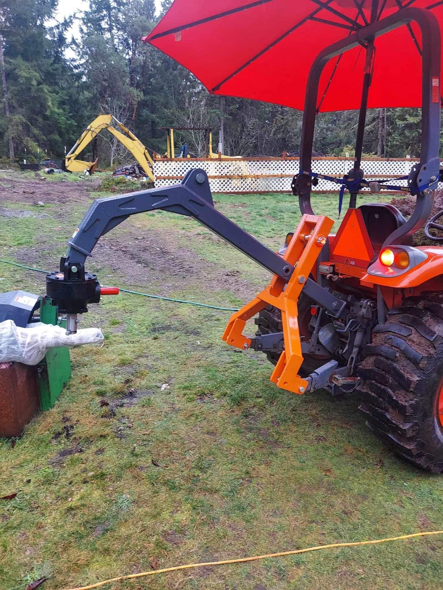

I purchase oversized post hole digger TMG TPD12 rated for 35 to 65 hp got a good deal couldn’t pass .Now I’m scared Putting it on my CK25 .It’s class 1&2 auger .CK25 is class 1 25 hp Opinions.TIA IMG_1586.jpegIMG_1590.jpeg

Are you meaning the lift pins on the digger are category 2, and you tractor is cat. 1 ?? If so, just get cat. 1 pins at a farm store TSC/ Rural King etc. and switch them out. As long as you can lift it high enough for the auger to clear the ground when transporting you should be fine. Depending on your soil just drill down at a time maybe 10"-12" at a time, lift and let it clean the auger out then drill more. Don't just drop it and try to dig a full depth hole all at once, depending on the soil it may just pull itself down and you'll not be able to pull it back up. Just go about 1/3 the total depth (I'm assuming 30" - 36" deep) pull out & clean then go again. If you have rocky soil, it'd be a good idea to have a large pipe wrench in case the auger pulls itself under a rock or wedges itself. About the only way to back them up is with a pipe wrench on the auger.
/ Post hole digger #3
Better to get implements that are rated for your tractor. The pins part is fine 1-2 just means it can work with either.
Just because something can be done doesn't mean it should be done. The potential for long-term damage is not worth whatever savings you had. Even if there is no damage, you will likely deal with frustrations because your tractor is under powered for this implement. The mfg will simply refer you back to their minimum HP and you will be SOL.

Worth a shot, since you bought it already.
Run it at moderate-slow speed, don't just give it it's head and let it drill down at an uncontrolled rate.
Certainly DON'T use the hydraulic ram to push the auger down harder:

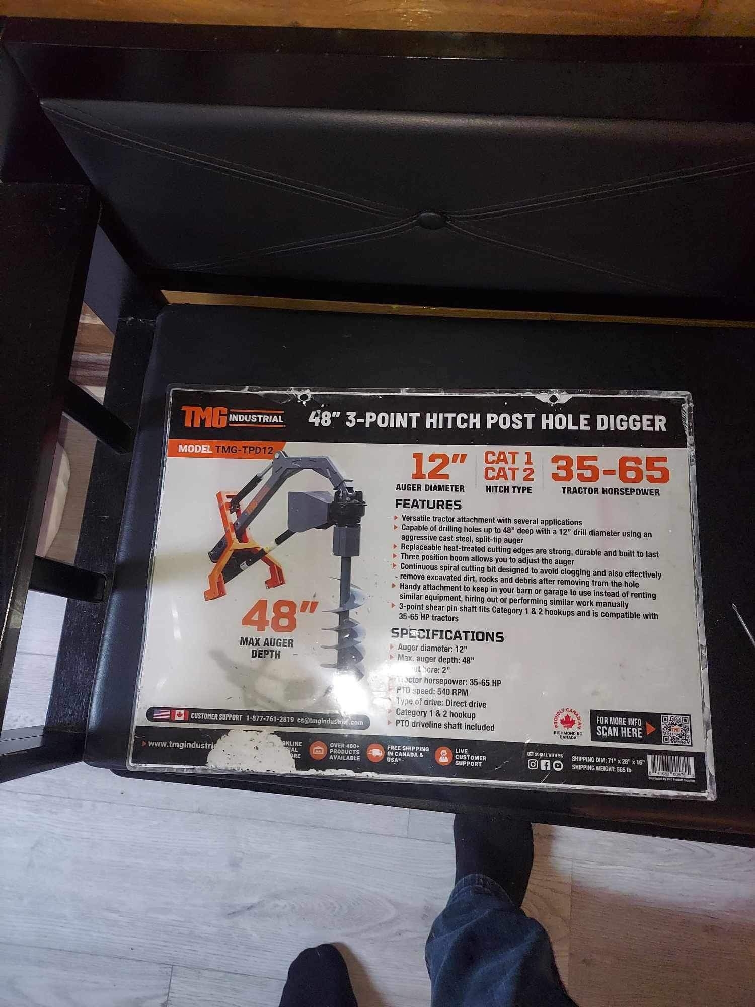

TMG Industrial 48” Hydraulic Assist Post Hole Digger, 12” Auger, Category 1 & 2, PTO Shaft Included, TMG-TPD12
Thank you that’s what I was hoping I wouldn’t use the hydraulic to push it down harder but what about to pull it up if it gets stuck

thanks your right bought at auction site didn’t think I’d win whoops. i’ve been using my Neighbors category 2 with my 6 inch bit. I just don’t like borrowing stuff so I have my own will be careful.low and slow.

I was under the impression from reading the description on the website that the hydraulic ram was for additional downforce only.
From the product description:
Hydraulic cylinder assist to drive the auger into harder ground; oversized 3-point hitch A-frame with additional reinforcement

I have the manual and it says that if you attach it to the hydraulics, it will both push it down and lift it up. They actually say once the hydraulics is there that’s what you should use to do the lifting and pushing I am not going to use that at this time, I think the 500 pounds of weight is good enough we’ll see how it lifts if I have the power to lift it I will send a picture of that page. Thanks again.
