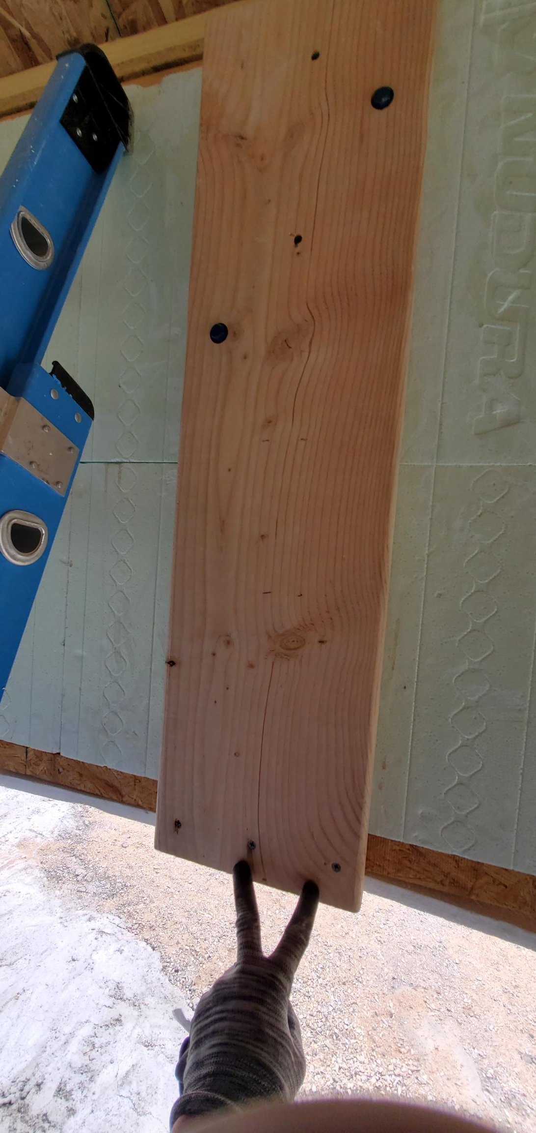

I got the center 2x10 board installed. I used TWO 3/8" Tapcon bolts (6" long) that anchored into the 6" concrete core by about 2" deep. Then I ran THREE 3" long screws on the bottom which anchor into the treated board that is attached to the concrete wall.
Should I run another 3/8" Tapcon where the "X" is shown? That will make 3 total. I don't want to go below the "X" area as the wall rebar is heavy there with #5 bars and also I don't want to interfere with the spring attachment they will install.

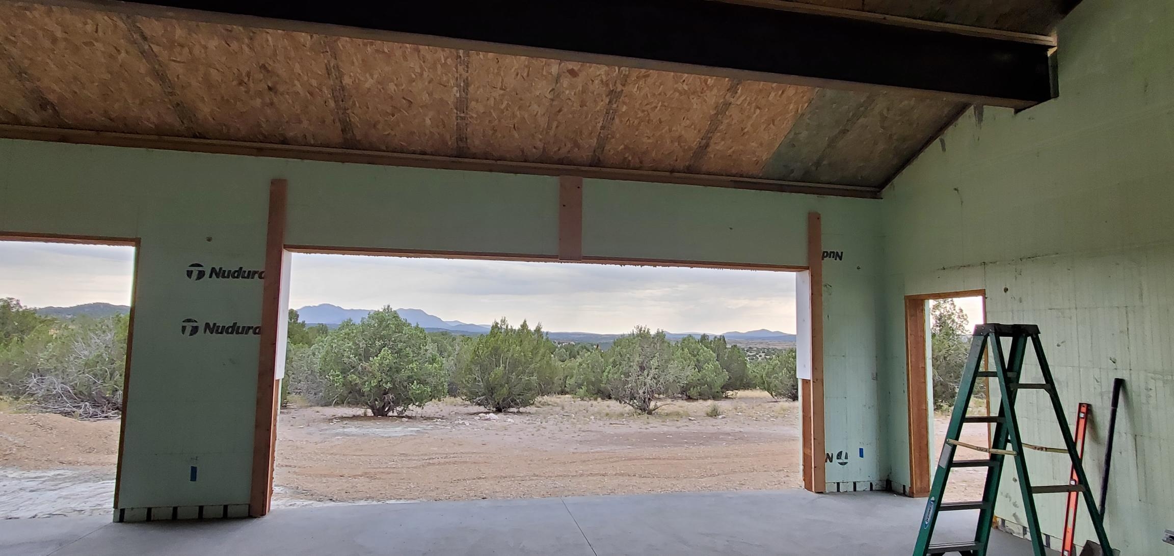

Still have to install the top board over the door. Got the center and 2 side 2x6 boards.
   / Detach 48x28 Garage - Footings #110
You’re probably fine with the tapcons you have.
Most openings are framed with the header 2x6 first, then the spring pad sits on top of that.
A couple “toe screws” would attach the bottom of the spring pad to the top of the header.
