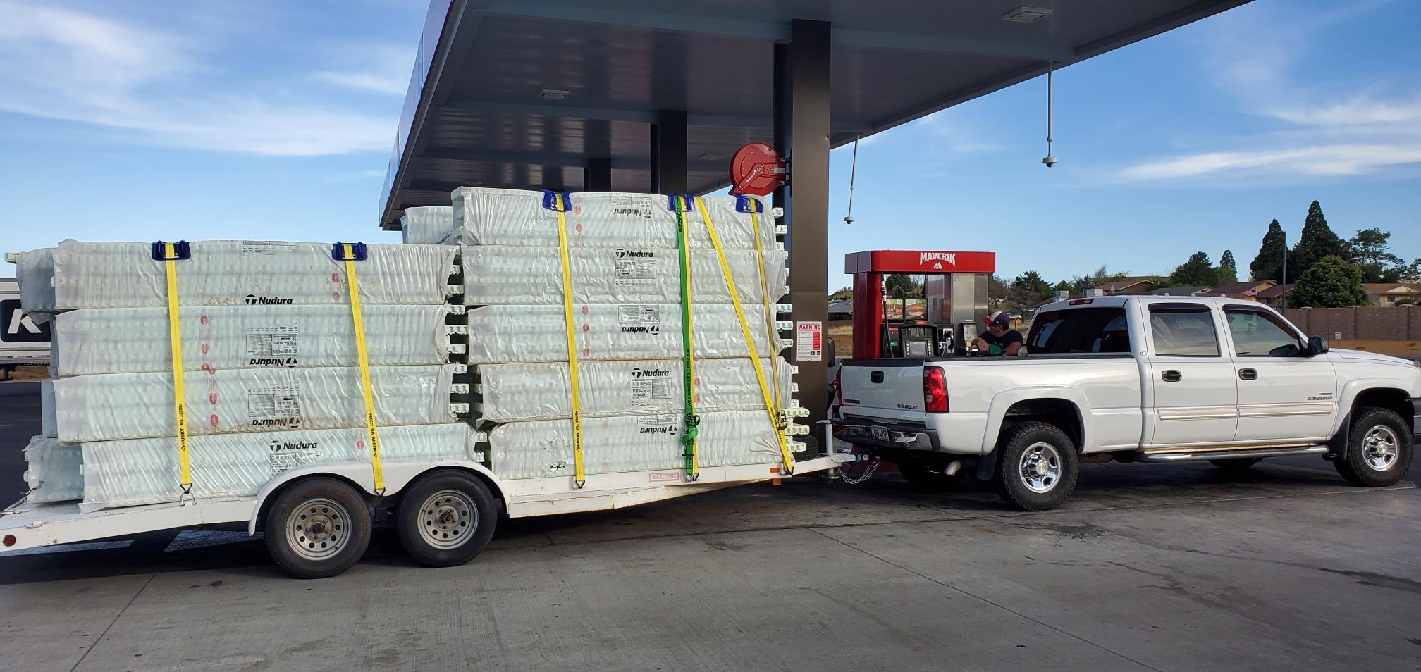

The 53' semi trailer can't make it up my driveway. So I was think of unloading on the street and placing the 48' beam on the 18' long trailer (see pic). Of course that means 30' will hang off the trailer but if we strap down the beam to the trailer, I don't see an issue going 10mph up the driveway.
Any curves or large changes in grade in the driveway?
I agree with @Doorman63 if you can raise the beam to clear the bed of the truck, it can make navigating turns and changes of incline easier. A friend crush the wall on his truck bed trying to make a corner with a large change of grade and the event stuck with me...

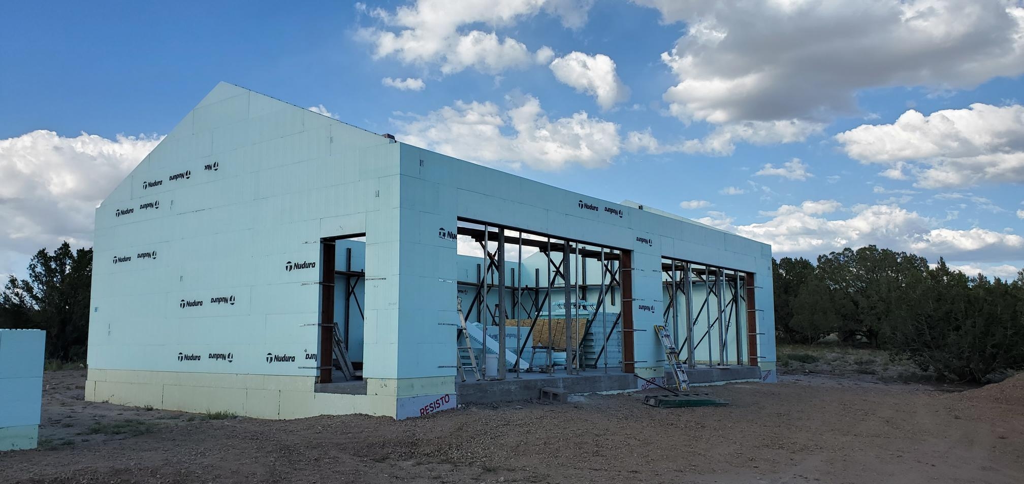

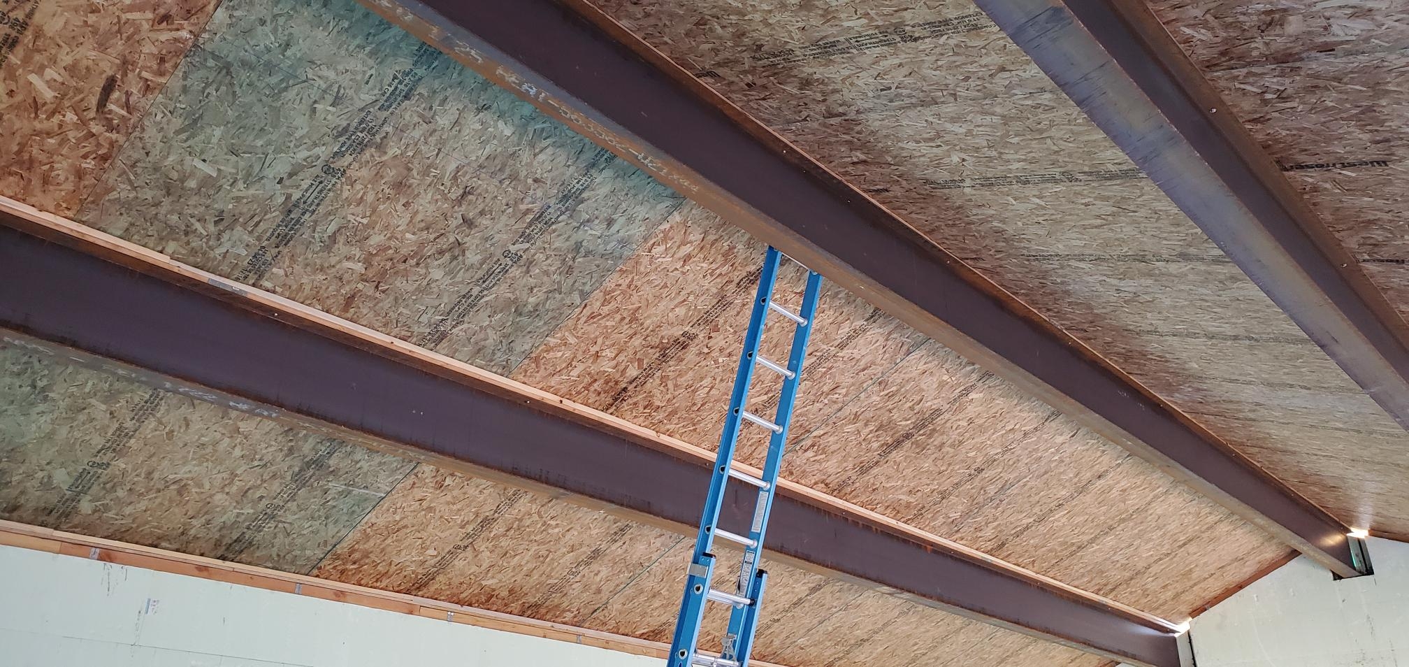

Did the wall pour the other day. 28 yards of concrete. 4,000 psi mix with 3/8". Did 3 lifts.

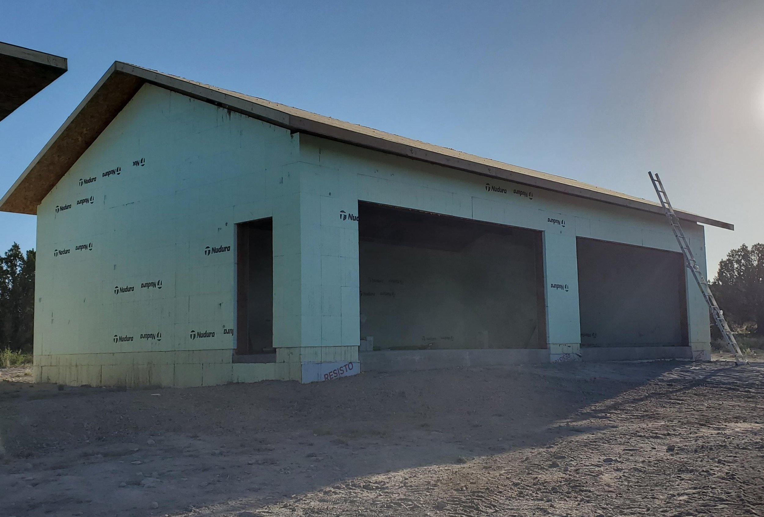

Got the roof on and looking at garage doors.
