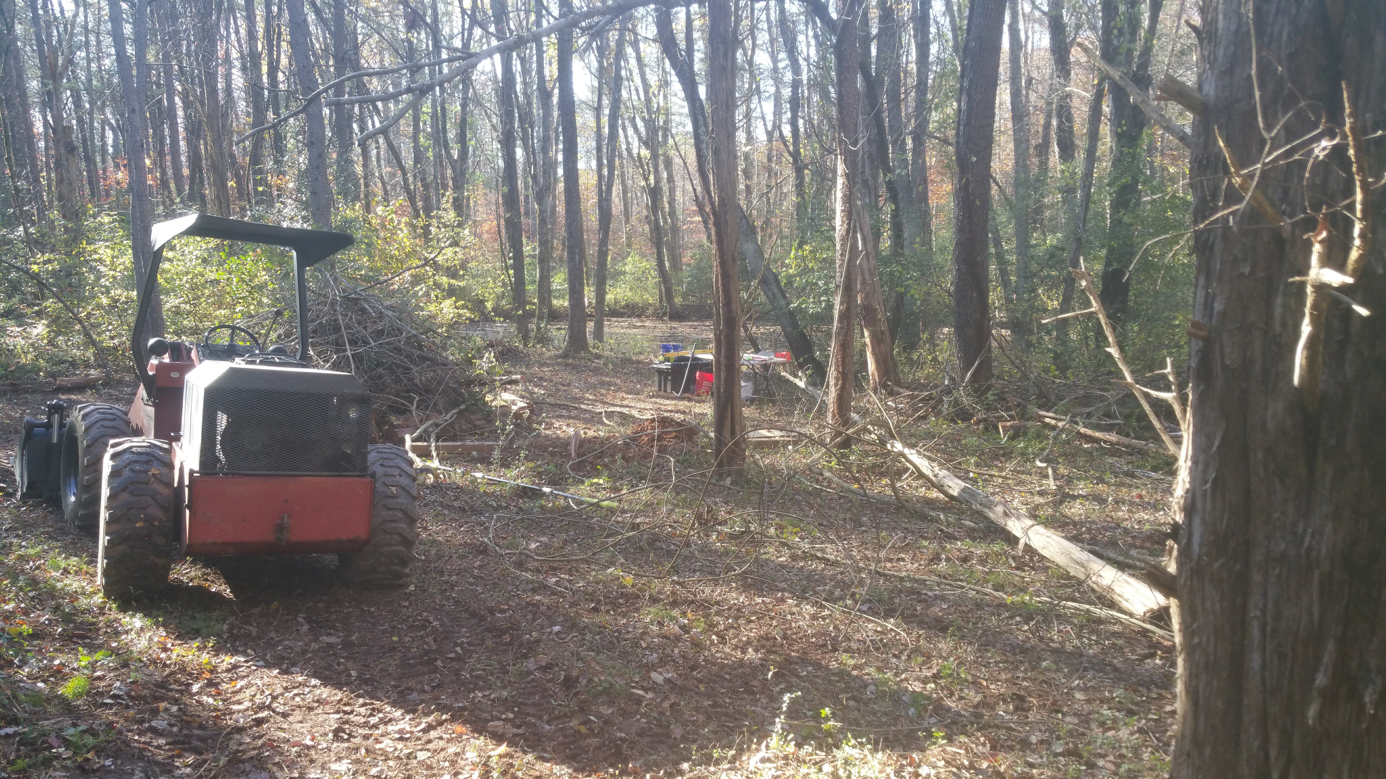

Finally got some time to deal with this properly.
Fuel tank drained completely.
Pressure washed inside of fuel tank.
Removed and replaced all the old lines from tank to engine with new 5/16 fuel lines.
New inline fuel filter.
New mechanical fuel pump. (Got rid of all the previous owners installed junk).
New fuel filter. Filled it with deisel.
Ran fuel up to fuel pump with gravity cause I was worried about the Duetz priming. (Priming is a non issue as she self primed wonderfully!)
New fuel. Treated with biocide and a little marvel mystery oil.
I got in the seat with some aprehension.
I was so happy when she started first turn and I have been running her the last 2 days with no issues.
Getting ready for a bonfire today!
Thnks for all the help!

:thumbsup: Nice!
Your woods reminds me of some of the 2nd growth stuff I push my little PT425 through. Couldn't do it without the little beast. :)
   / Deutz 4 cyl. diesel start, stall, run slow, stop, repeat #34
Congratulations! I'm glad that you got it running well. Thanks for the report. I was wondering.
Your machine looks so BIG! I'm sure it isn't only a few inches wider, but from behind it looks much wider.
