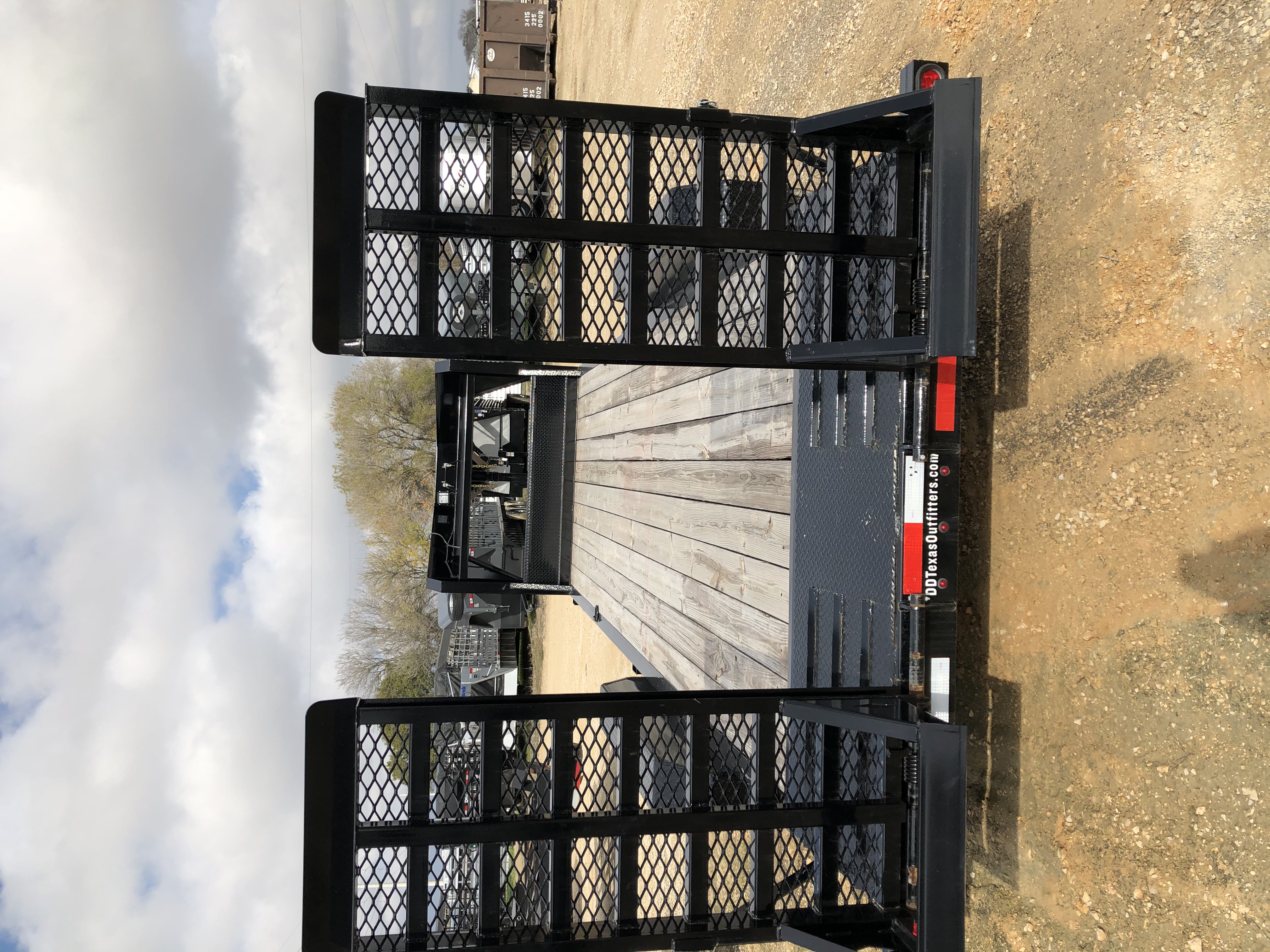

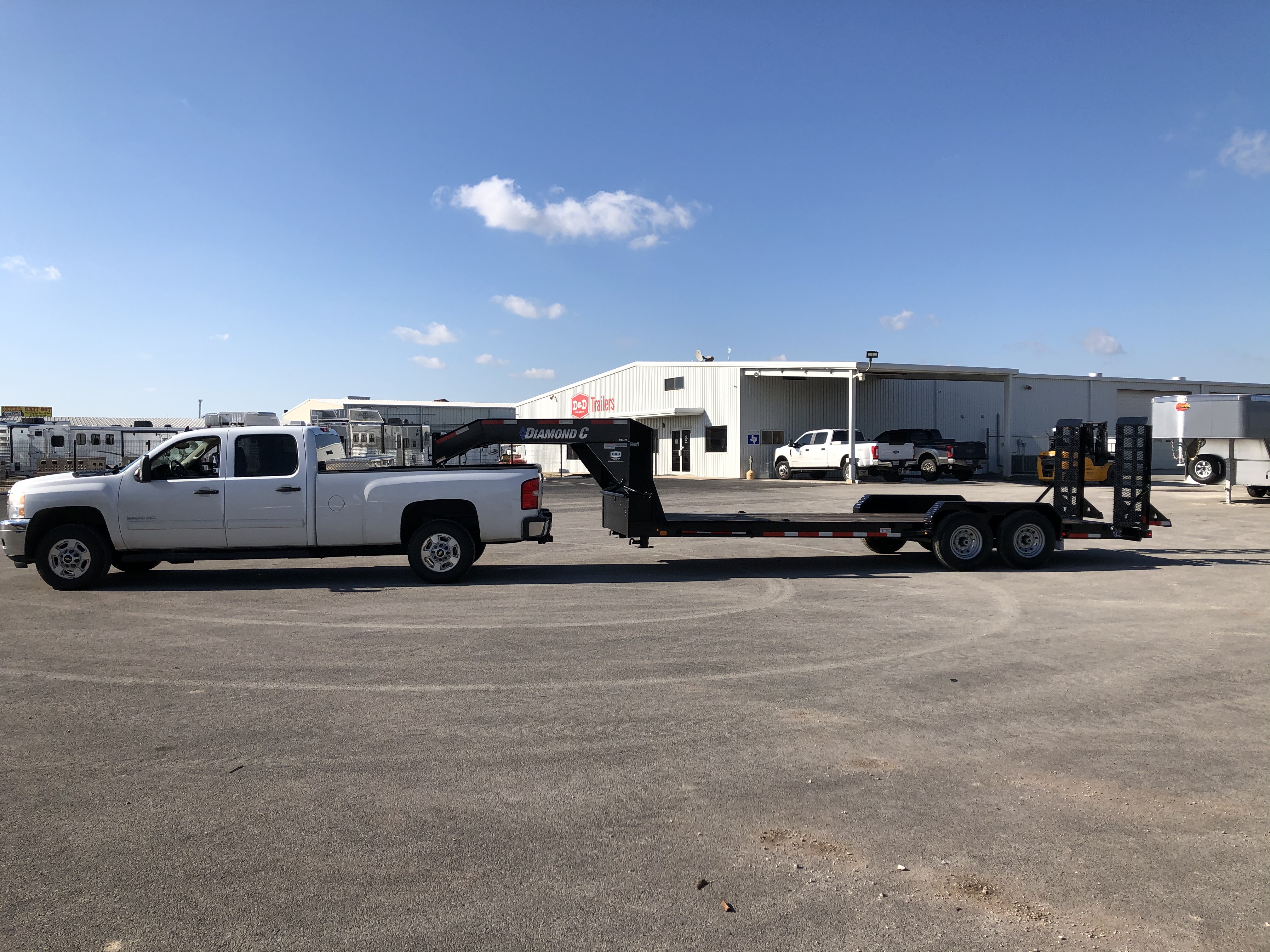

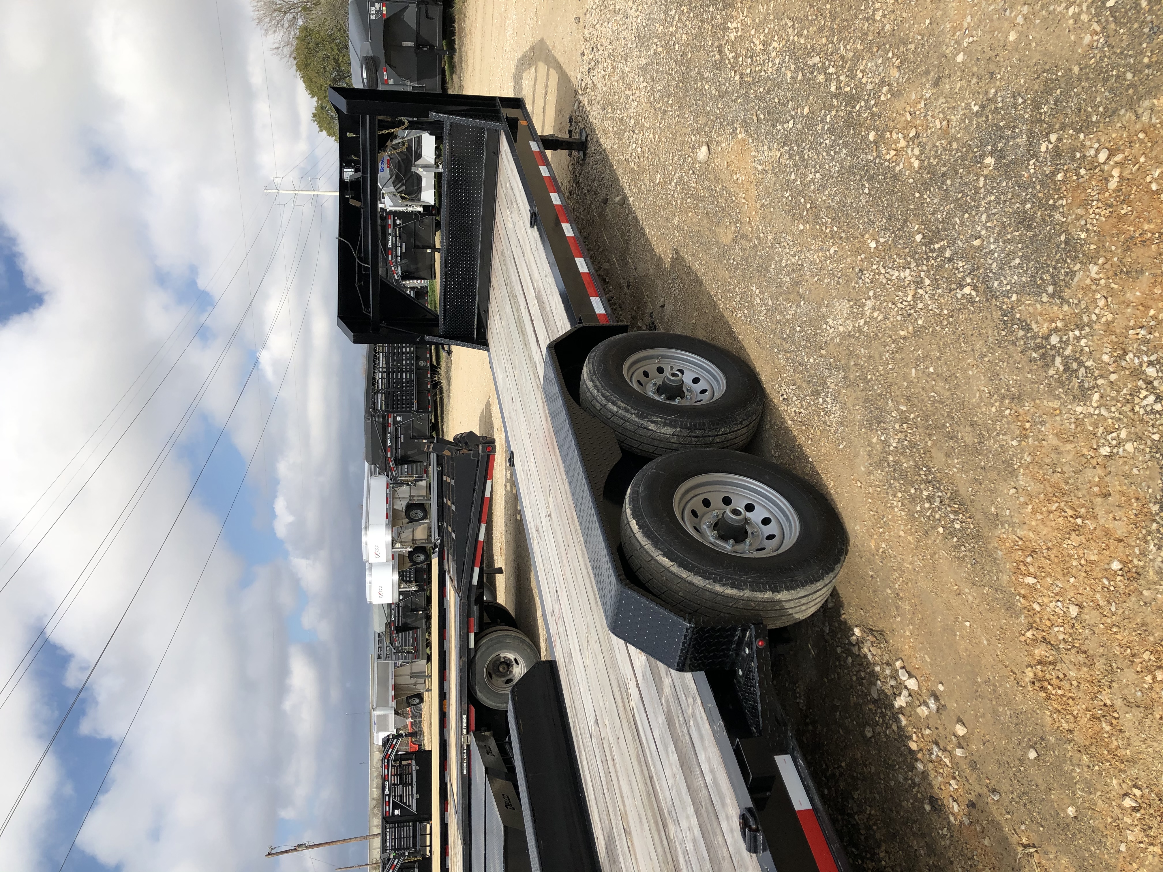

Bought this one today on the year end sale.
CF530BBC-6D45-4762-8551-024FC16B1DA8.jpeg. 24D499DF-C2F2-470B-8449-22541E1FEF4C.jpeg. A7B8BA5C-2E99-4037-99E3-85C9C7C72BF4.jpeg
22 foot, 7k axels x2.
I think I will like it.

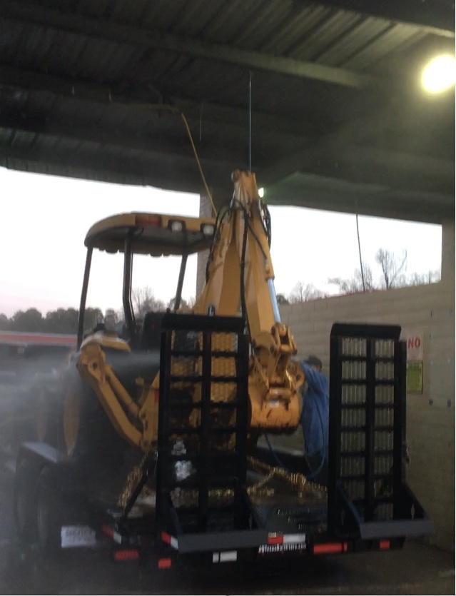

Took the 110 to the car wash as a test pull with the Diamond C 19LPX. Sure needed the clean up.
It fits well on the trailer. Still have room to carry the pallet forks too if needed. Had some concern about the stand up ramps but I’ve overcome that. They work well and the 2’ dove made it very easy to load and unload. No rub rail, which I would like but the D rings and chain pockets are sufficient.
Haven’t decided how to mount the winch yet.

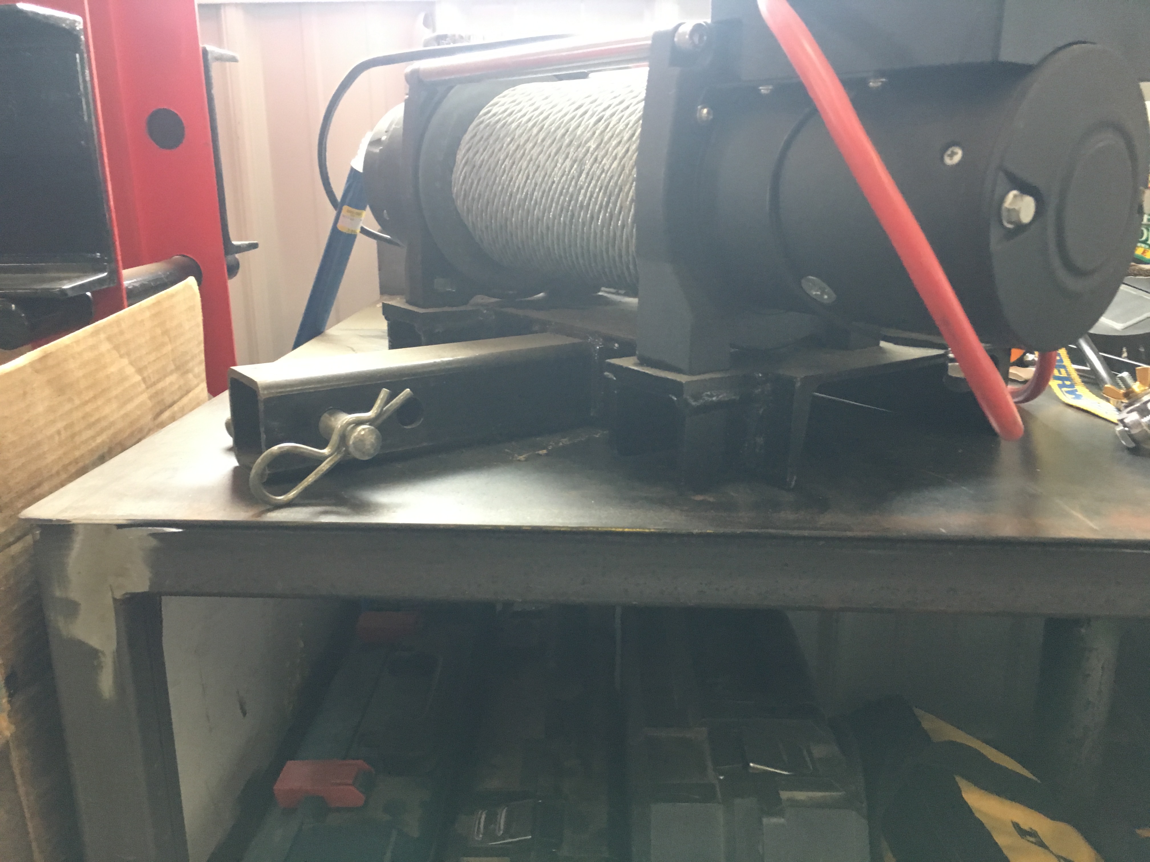

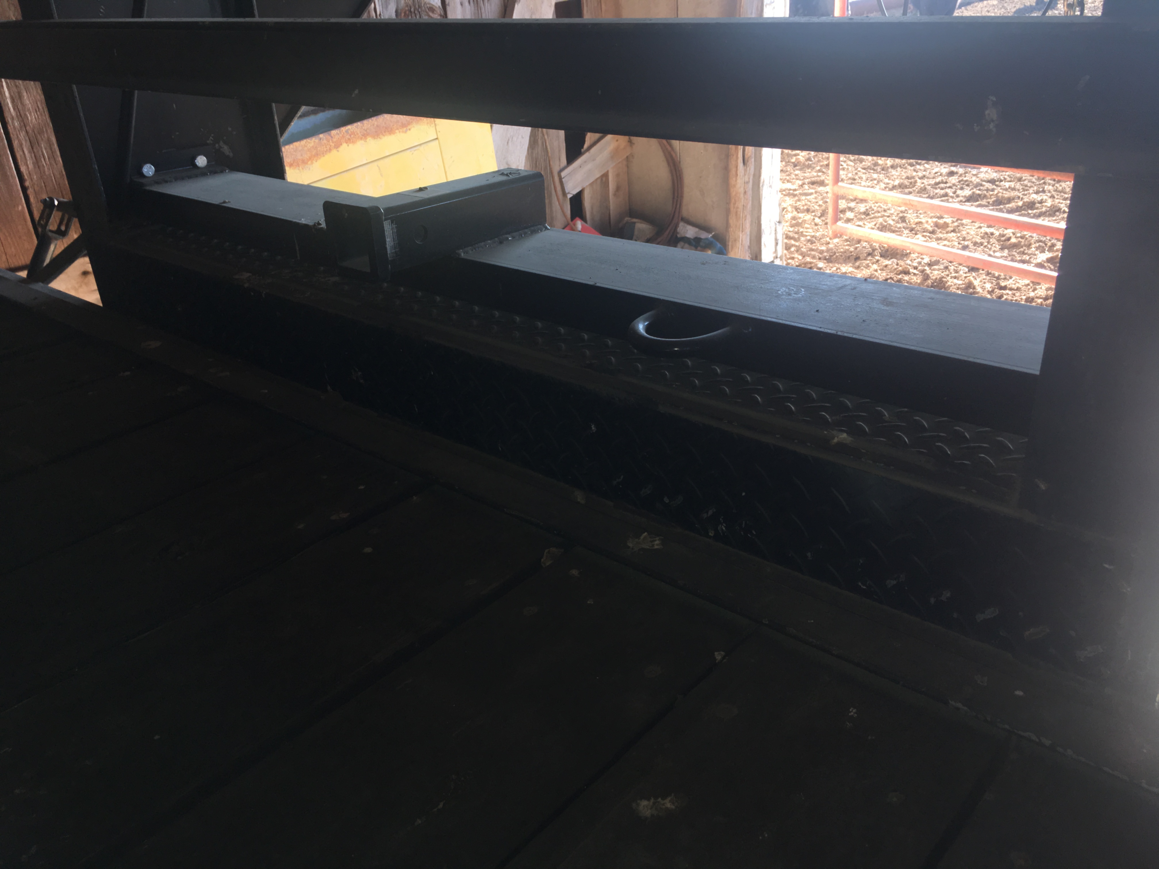

It's a nice, sunny day, but I was hoping for better lighting in the barn.
I had a piece of 7" channel in my metal rack, so that's what I used. It would have been nice to have a wider piece for the winch mount, but I welded some tabs on and it worked out okay. I had a piece of 2" X 1/4" square tubing for the mount on the winch.
I also had a 2" tube mount laying around and used it for the trailer mount. It's also a piece of 7" channel. The angles on the end are 1 1/2" X 1/4" and have 1/2" grade five bolts. I plan to change them to grade 8, but didn't have laying around the shop. I made a hoop from 1/2" cold rolled stock and plug welded it to the channel, to facilitate double lining for heavier loads. The top of my chain box is about 10" higher than the deck.

Oliver1555,Thank you for those pictures!
That is a great way to mount one and I like the loops for double lining. My tool box opens from the top as opposed to yours which appears to open from the front. That is the problem I'm running into is with that top opening lid. I like mounting the winch higher that the deck.
I've got a bolt on configuration in mind that might work. In the mean time if anyone has suggestions on winch mounting I am open to suggestions.
