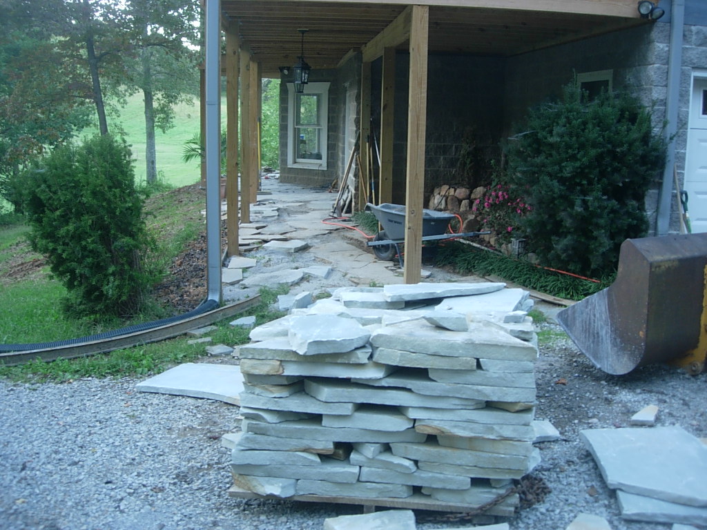

I've used it a couple times now. It REALLY saves a lot of time when I need to make a deep or long cut.
I'm bordering along a wall and on the other side, some of that plastic garden edging. I've picked out the stones with a flat edge to butt up against these locations. If I find another stone that's "the right stone" even though it has a rough edge on that flat side....I'll now cut that rough edge off.
I'm also cutting out 6x6 notches so the stones can fit around our 6x6 posts on 3 sides. Using the circular saw for 80% of this and then going in with my 4" grinder to clean up the cuts has worked out very nicely.
Just have to be thoughtful when cutting so I don't leave little cut marks in the stones where the blade exceeded the marks.
I got another chuckle this morning, out of the thought of using a wet saw (table variety)
I've not weighed them but little doubt in my head that some of these stones are easily 50 pounds and some are probably over 100 pounds. It's difficult enough wrestling them from the dump site to their install site. It's more difficult "machining" them with the hand held saw if need be (to cut a notch for example). I could not imagine trying to handle those larger stones on a table.... lifting up/down, moving...adjusting them...cutting...then moving again.
You can see some of the larger pieces laying on the ground.
