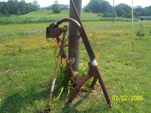

Finally was able to go get them on Saturday. Here are some shots of the PHD. PTO shaft was frozen when I brought it home. A few shots of PB Blaster and a few whacks with a hammer and few more shots and then let it sit for a couple of hours and repeat. Did that four or five times and it was then free. Tried using it yesterday but combination of dry/hard ground and a worn out tip and it didn't work too well. I'm going to go sometime this week and get a new type and new cutting edge for it. Looks like I might also have to replace one grease fitting as it doesn't want to take grease on one of the U-joints.

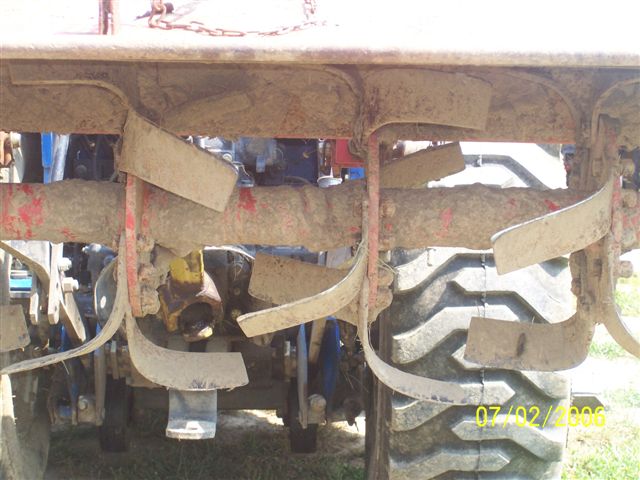

Here are a couple of shots of the tiller tines. Looks like he had used it in some pretty muddy conditions last time he used it. Nothing that a power washer and a little more grease can't take care of.

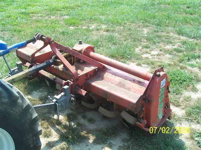

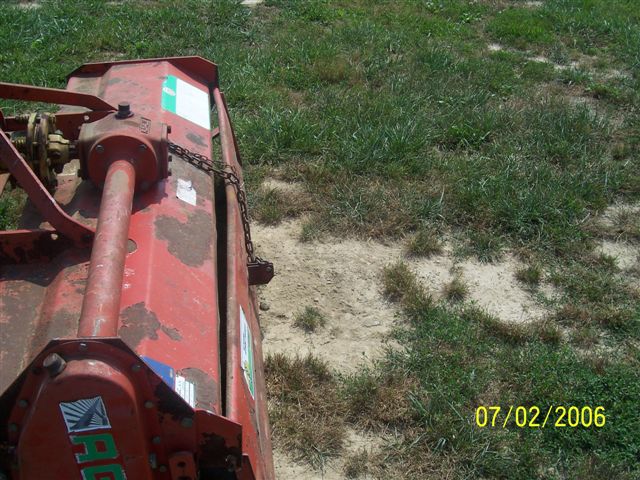

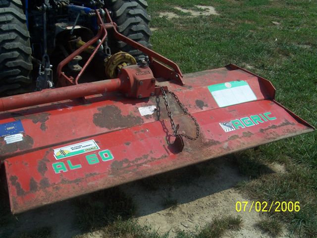

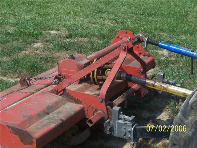

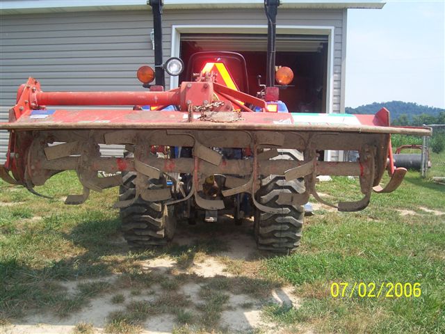

Here are some shots of the tiller itself. Surface rust, but no holes are rusted completely through. I'll power wash and then wire brush and hit it with some Krylon NH Blue. Should make it look a lot better to do that. The only thing I can really see wrong with it, is the back guard is bent a little bit. You can see how much in one of the pictures, don't know if I'll try to fix it or leave well enough along.

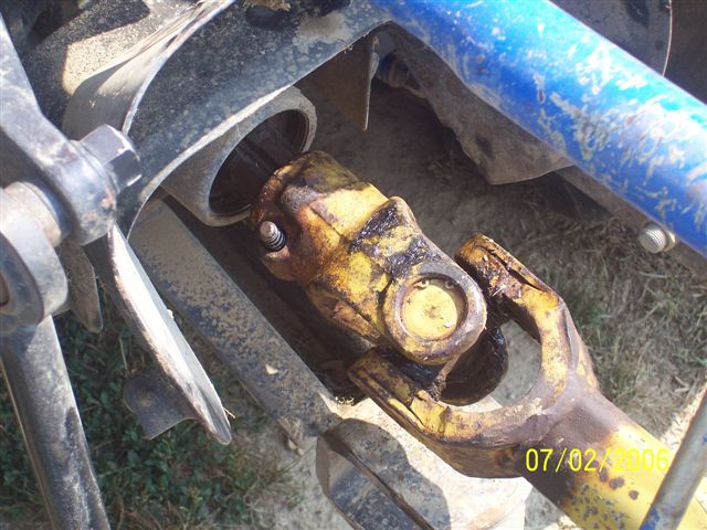

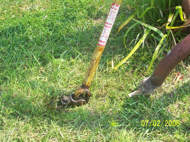

Here is a shot of the only thing wrong that I had to fix before using it. As I was working with the frozen PTO shaft (yep, this one too) I noticed the PTO latch was weird. I then realized it wasn't weird it was broken.:eek: I went to tractor supply Saturday night to get a new end for the PTO shaft. Stood there confused :confused: for about 15 minutes. Decided I would go back yesterday and bring the shaft with me. So I took the front half of the shaft with me yesterday. Stood there another 15 minutes or so and got one that matched, unfortunately it was one of the more expensive ends at $60.:( As I'm about to walk away I see these little plastic containers hanging there. They are latch rebuild kits. I stand there for another 10 minutes or so looking at all of them. Finally find one that matches up. It was only $5:) So I immediately hung the end back on the wall. Brought the new latch home, fought with the spring a little bit, but eventually one the battle. Here it is connected to the tractor complete with new latch.

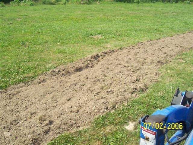

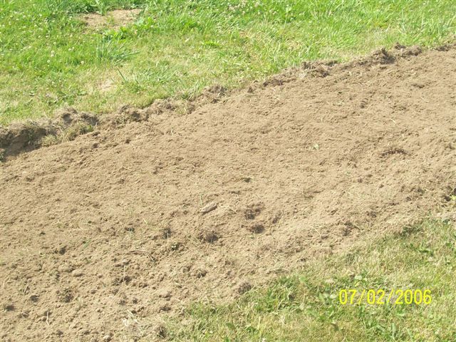

Here are some shots of the ground that I was playing with.

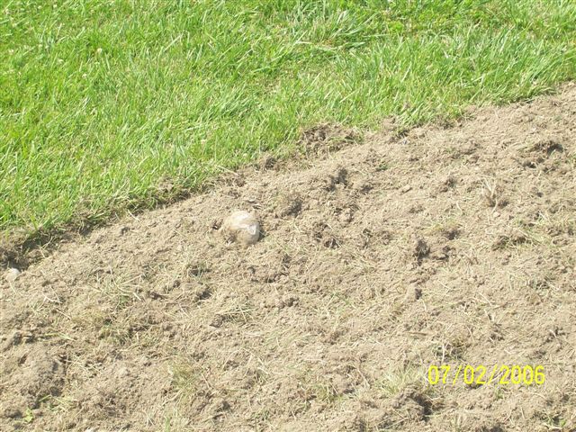

First shot is after two passes on Saturday. I was afraid to go too far and at PTO speed because of the latch being broken - but I still wanted to play a little bit.:D I loosened up the slip clutch and put it in the ground to free the slip clutch and then I tightened it back down. In the second picture you could see a rock I hit that made the slip clutch slip. Had me concerned at first because it was the first time I had ever used a slip clutch and the sound/feel felt strange. Last is a shot of the ground after I ran over it yesterday at PTO speed with the latch fixed.
When I tilled the area Saturday the ground was really dry and hard. Tiller was wanting to bounce a lot so I had to keep ground speed and PTO speed down (also because of the latch) but even so the tractor never groaned a bit, not a sign of smoke or anything like I was over working it. I don't even think it lost an RPM. The 3rd pass Sunday was pretty cool. Since it was broken up already and I was running at PTO speed the dirt came out really fine and powdery. I'm thinking my garden is going to be a whole lot easier next year.:D

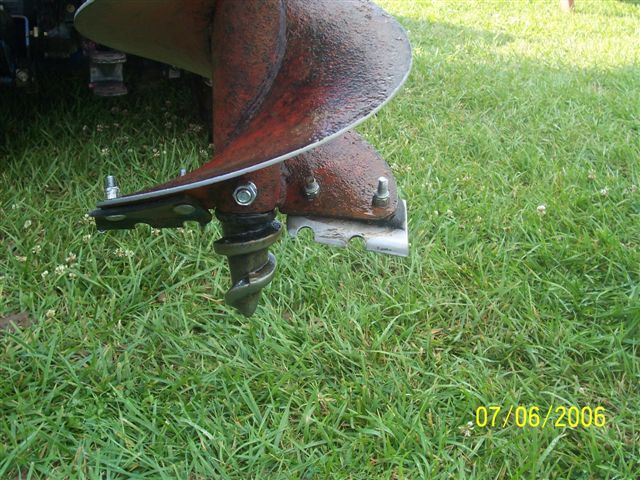

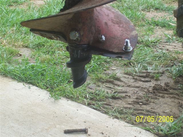

Went yesterday and bought the new cutting edges and tip for the PHD. Went first to TSC and saw what they had and almost decided to get them and make them work, but then I decided to go to the original dealer that sold it. They had the cutting edges and tip designed for it - and they were CHEAPER then TSC.:eek: Got both cutting edges and the tip for something like $32. I've did get new bolts while I was at TSC though.:D I've put the cutting edges on but not the tip yet - have to wait until it is on the tractor so I can lift it. That'll be tomorrow as we have about 40 holes to dig for poles for a fence around Monica's flower garden. I'll get some picks of the new edges and tips. I wouldn't have even thought the tips were the right ones because the existing ones were so worn out they didn't even resemble the new ones.:D

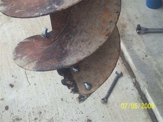

Here are some pics of the new cutting edges and tip. First is a pic of the new edges compared to the old edges. There is no resemblance.:eek: BTW, I had to take them back off to get the tip off. Which took some beating with a little a hammer and punch/chisel. Also took a little bit of heat from a propane torch - finally got it though. Second pic is of the new tip and cutting edge. Third is a closer view of the cutting edge. Fourth pic is a shot of the cutting edge after it took me forever to try to drill four holes w/ a lot of work from a spud bar and several hours.:eek: :mad: Once I installed the cutting edges correctly I could drill a hole in probably 30 seconds to a minute.:cool: :p
