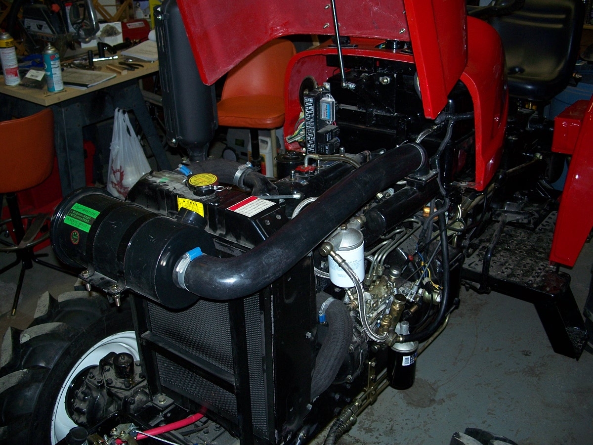

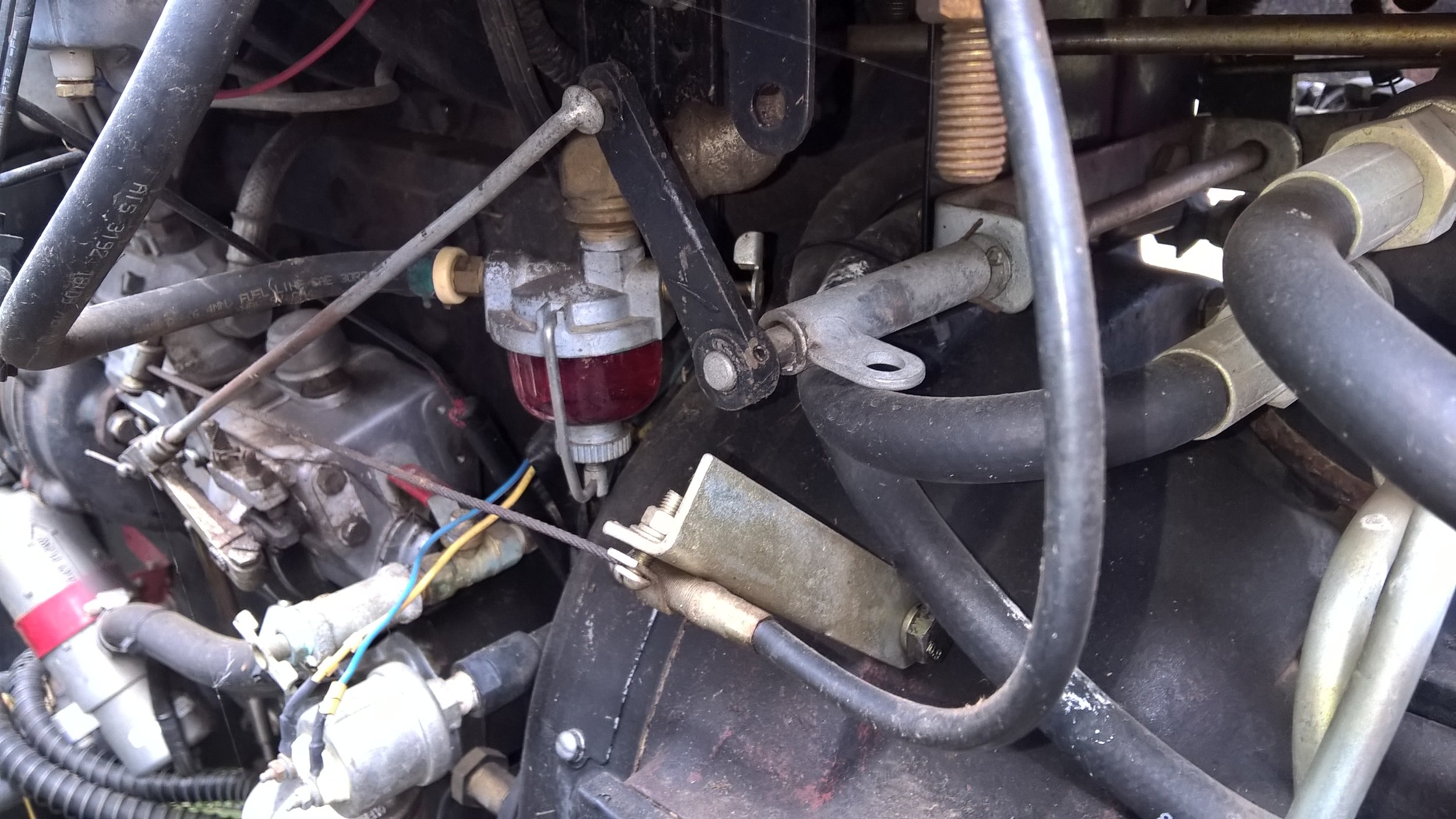

Yes, the cylinder with the red mounting strap is a 1000W tank heater. Will bring the head from -30F up to above freezing in about an hour. Real necessity here.
The banjo style ends are just crimped onto the hoses like any other hose end. Probably technically a 6mm fitting but will work just fine with 1/4" hose. I used a cut off wheel in the Dremel and removed the ferrel then it just pulled out of the hose. To re-use the end, a small regular hose clamp works just fine especially considering the low pressure application.
The OEM sediment bowl had a plastic bowl that quickly got cloudy and hard to see through, plus the valve leaked. I bought an aftermarket upgrade kit from Ranchhand Supply. As it turned out the tank was tapped 1/4" NPT so I added the two street elbows to move the bowl for easier access.
The electric fuel pump upgrade came later. The pump is an old style "clicker" pump that I had bought for a gas vehicle way back in the 1980's but never used. The box it came in had long been lost so I had no instructions and no idea if it was compatible with diesel. Installed it anyway and it has been working fine for many years.
The output hose goes to the secondary filter housing, where I removed the banjo end from the old hose and reused it on the new one. The last picture is the OEM setup when I was assembling it from the crate. I had already swapped out the blue OEM filter for a new NAPA Gold unit. You wouldn't believe the stuff that they called fuel that came in the tractor. All fluids were drained and flushed prior to re-filling with quality domestic products before it was started for the first time.

Thanks much for great photos! Your repair work looks very professional in my opinion.
Thanks to your experience, creative ideas and photos and all the contributions from Mr Rooks and others at this site, I now at least have a repair plan in mind.
My fuel bowl valve is leaking too. I found that out when removing lift pump. I looked up Ranch Hand Supply as you suggested. I also found similar one at Affordable Tractor Sales.
